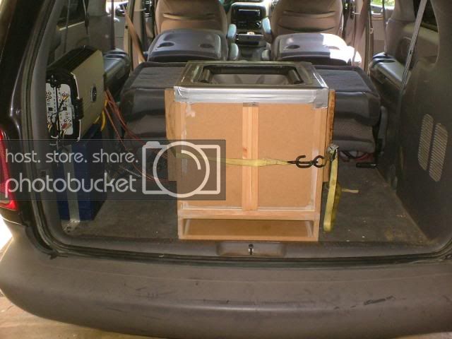

according to there t/l.. peaking in car at 57hz, which is off from what I figured. I did the 42 at 51hz, which is were it should be, thinking he meant to tell me 51 and not 57.
Ended up with 1-15 and a smaller box. This is mainly for spl, but sounds ok with normal music.
Let the flames go with what you think it did. 1-L5 15 on 2-dbdrive 1200.1's strapped. Sub is wired to 1ohm to the strapped pair.
No worries on the distro block, it is fine really. prop end up getting a reducer and running straight 1/0 to the amps anyways.
Yeah higher tuneing will get the mic, but don't care to listen to it daily that way. And not a fan of haveing interchangeable ports. take out, put in,take out, put in. To much to do when I am just in it for fun really.
the tuneing now is high enough, but still plays the lows well. listen to more rock and alternative style music then anything. Classical is in ther, and plays that fine.
isnt that less work then building another box and replacing everything?

I didn't build a new box actually, this is the old box only cut in half and downsized. So no money was involved in the making.

Ok the van did a 145 and change on the dash and 147 and change in the kick with this setup. Kick was with window open only, driver door open didn't change the reading.
Yep sounds about right. I found that cracking the driverside window about 6 to 8 inches yeilds the most gain at the dash and the kick. Thats only with a single 15 or smaller in that off axis setup. Once you go up bigger on cone area. It changes if you open the driver side door.

1 more thing you may want to try.
Take that box and turn it so that the vent is about 7 inches away from the passenger side wall in the back. There is a Rear Blower in that van so that corner is flat. Seal off the opening there and run it again.
