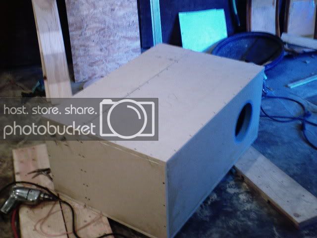

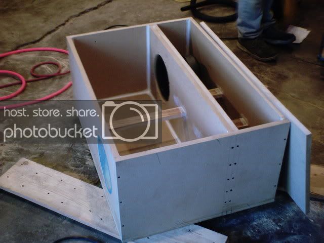

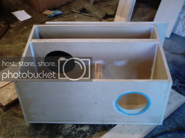

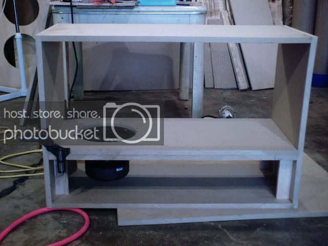

Also built one of these typical boxes. Hd it in an extended cab fullsize ford. Sounded halfway decent for what sub was in it. Tuned to 30 hz.
We will see how well it does for the first time out on saturday. Then work on it more after the initial number.
Forgot to mention. bro helped with the radio mount and wife designed the box for the most part. I just built it, along with bro's help and tools. Sucks not haveing alot of tools, or garage, to work with.
