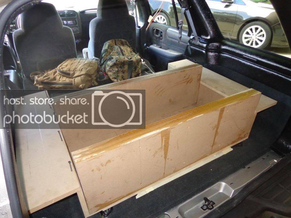

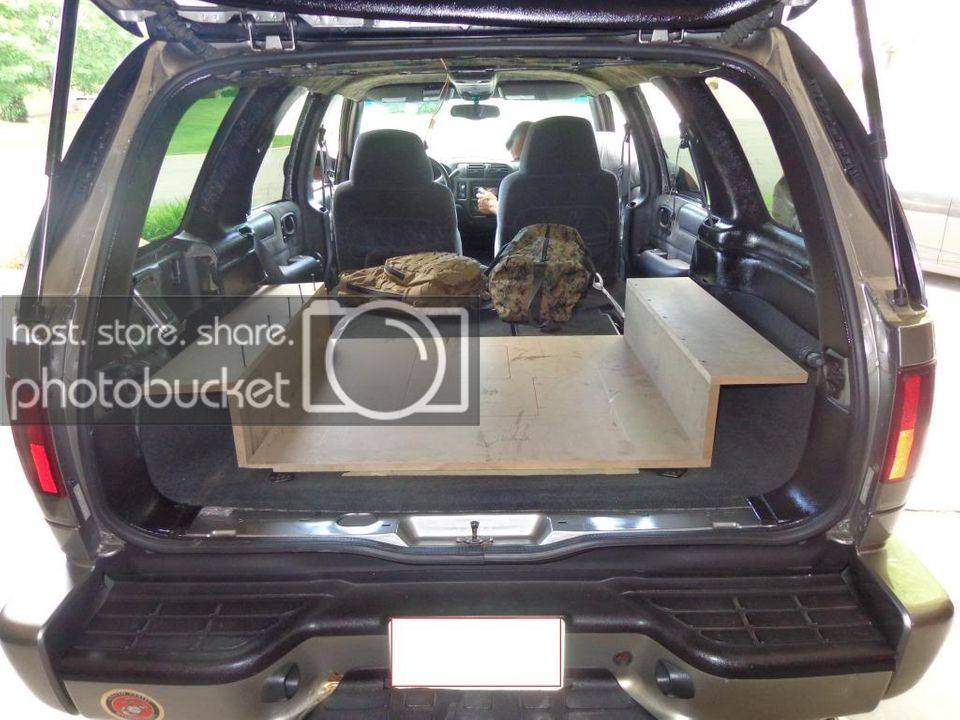

box built within vehicle due to its prohibitively large size
designed with a pencil and a TI-89

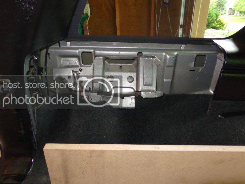

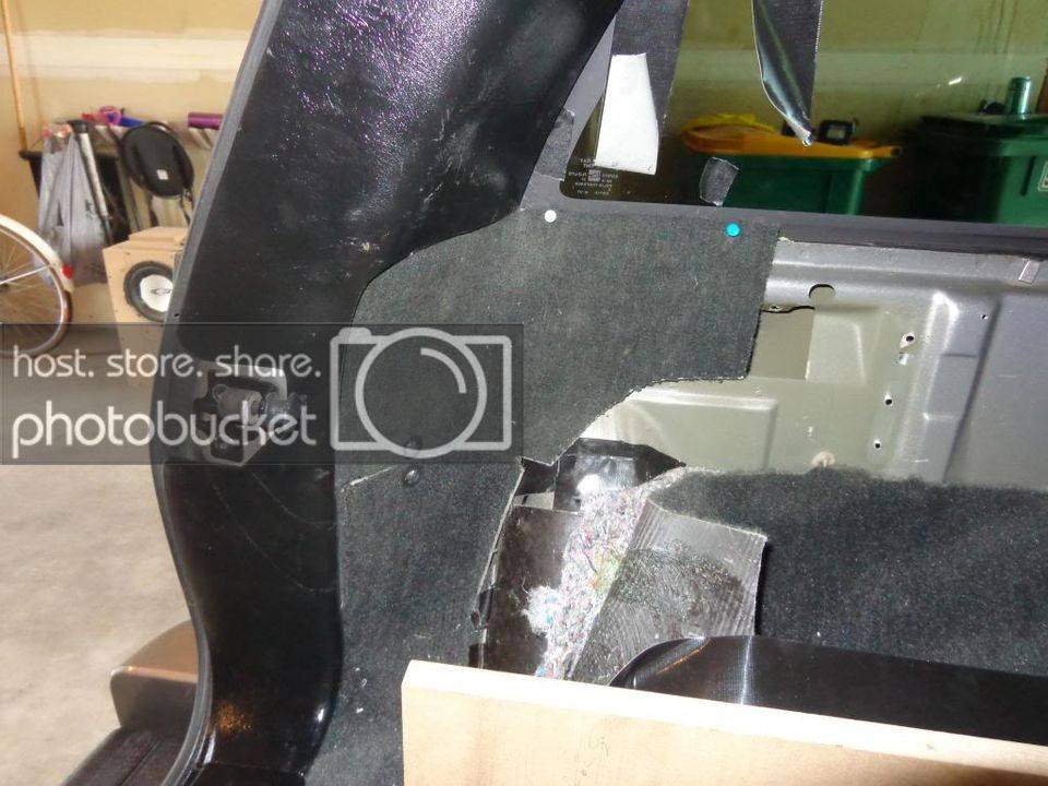

Side panel was in the way so it was cut out. Carpet will be used to cover this up.

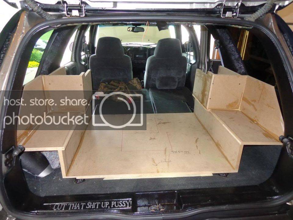

Starting of the box. Everything at this point is just with screws.

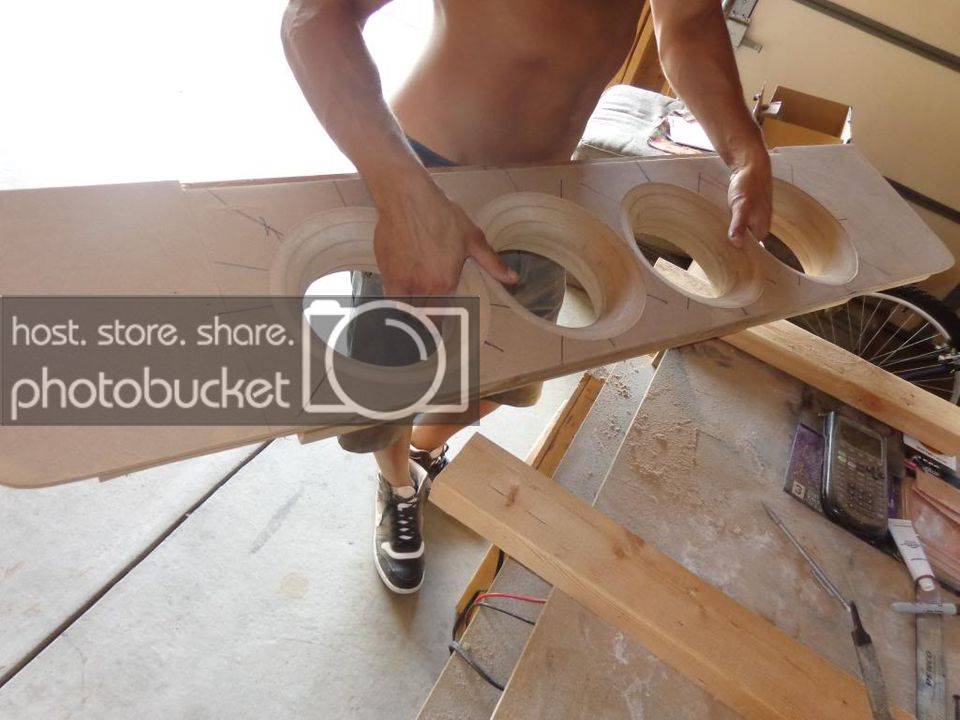

The port flares will be cut using a 1.5" radius roundover bit.

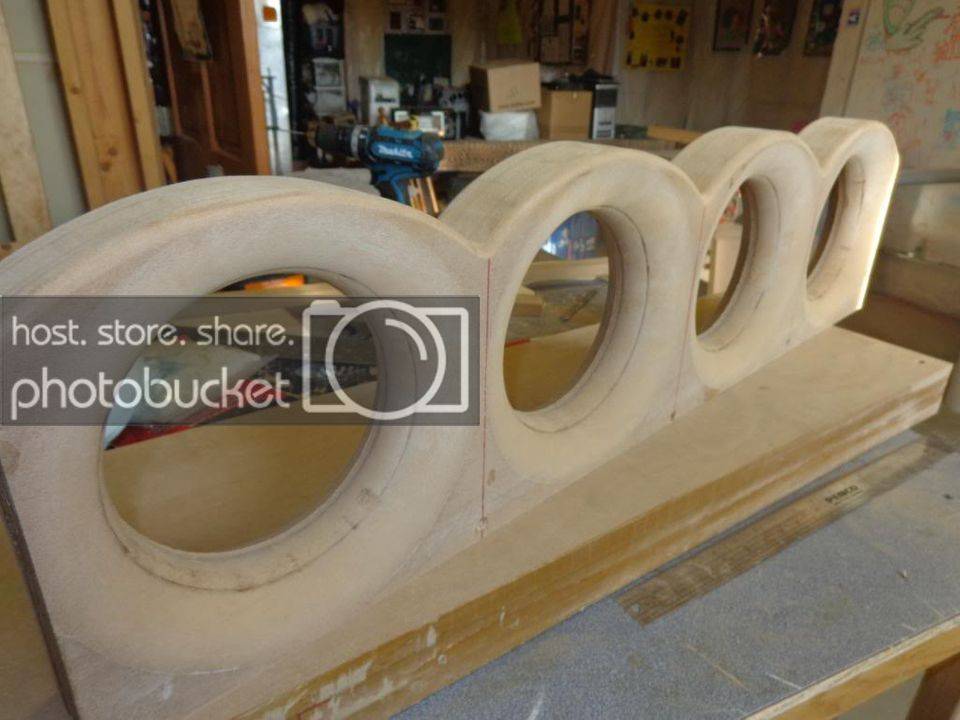

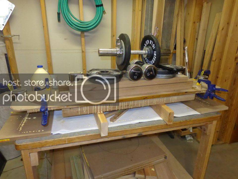

Three layers of wood were glued up, which will soon be cut using the above bit. They will be used for the internal and external flares for the ports. 6" PVC will be used as the port tubes.

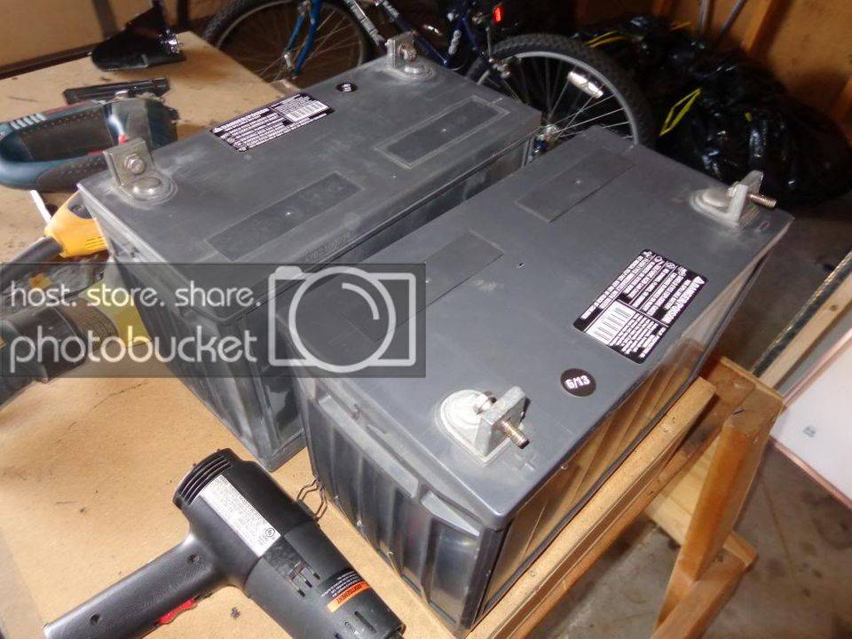

C&D batteries model UPS12-370R. They were benched at about 1000 amps cranking and were $80 each from the local interstate distributor. At a later date a new alternator and front battery will be installed.

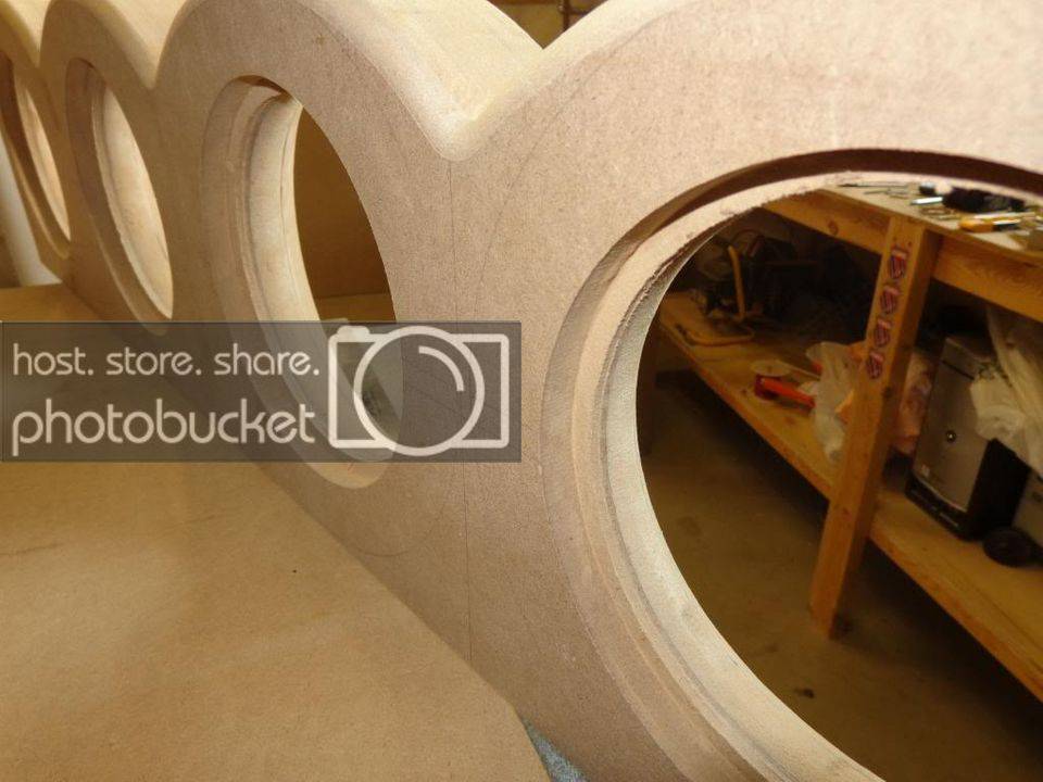

Routed out the internal flares today. The 1.5" radius roundover bit worked well to create the large flares. Even with a 2 H.P. router it was struggling.
The other side is inset to accommodate the 6" PVC.

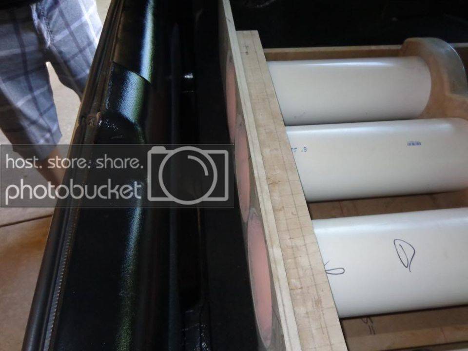

The entire bracket to hold the jack was removed to provide more room for the box. Carpet was also added. The exposed metal shown below will be covered by the box.

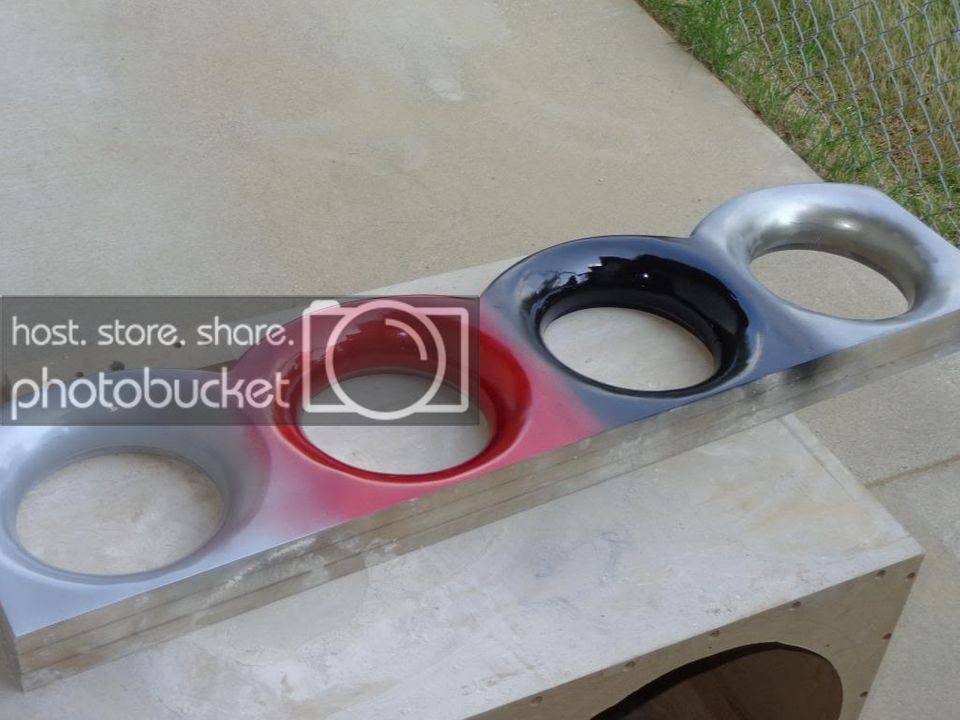

Today we also experimented with different paints to use on the flared ports. Since this is the internal set of flares, anything we do to will not be seen from the outside. Red seemed to turn out the best.

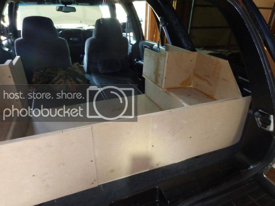

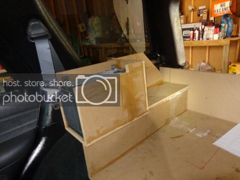

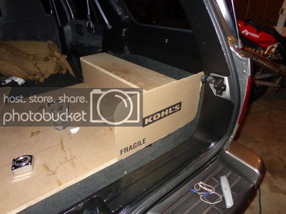

The box will take up the entire width. Cardboard was used to create a template.

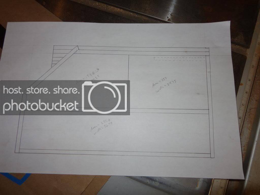

Work was done on the box design. Shown is a side view, with the left being towards the rear of the vehicle. The calculated volume is approximately 12.3 ft^3 before port displacement. Once sub displacement is known, a more refined calculation of the volume will be done, which is needed to calculate the port length.
The reason for the 45 degree slant of the back of the box is to reduce turbulent flow. Since sudden changes in area are a source for turbulent flow (and energy is lost in turbulent flow), the slant works by gradually changing the area. This is only a theory. One that makes complete sense after taking fluid dynamics, but has yet to be tested in this application.
The side pieces were replaced. Internal volume was too small so the sides were made wider.
The back panel was cut and the fit was verified before it is glued up.
One battery will be on each side in pockets. The fit is very snug to fit the amps on top of the box and to maximize space for the subs. we originally were trying to fit 3 or 4 batteries, but that would kick the space below 10 ft^3 for the subs.

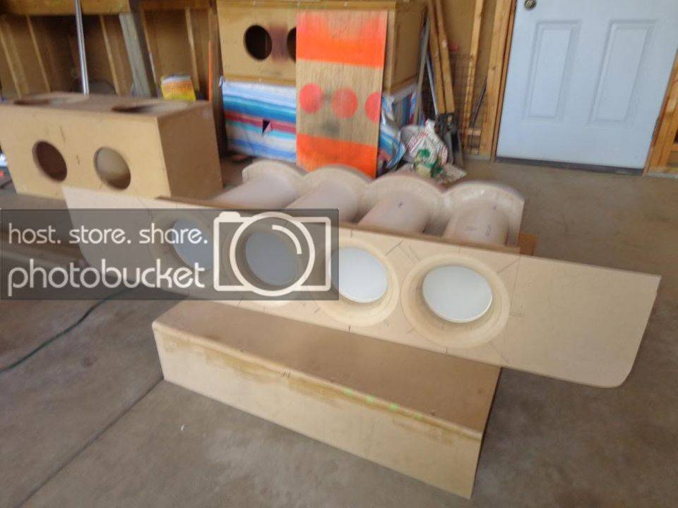

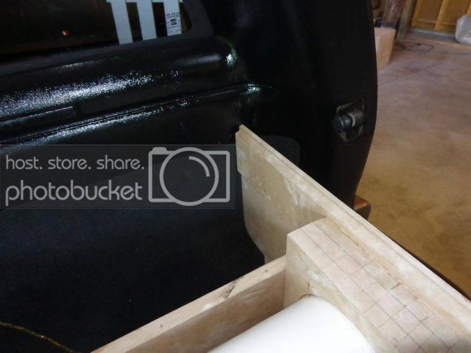

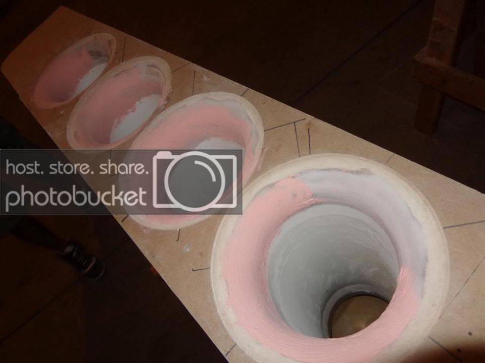

Flares were made and the PVC tubes were glued in.
The box size is about 10.2 ft^3, with the ports being 21.5" long. The PVC were bondoed in, followed by a layer of glazing putty (as shown in pink).

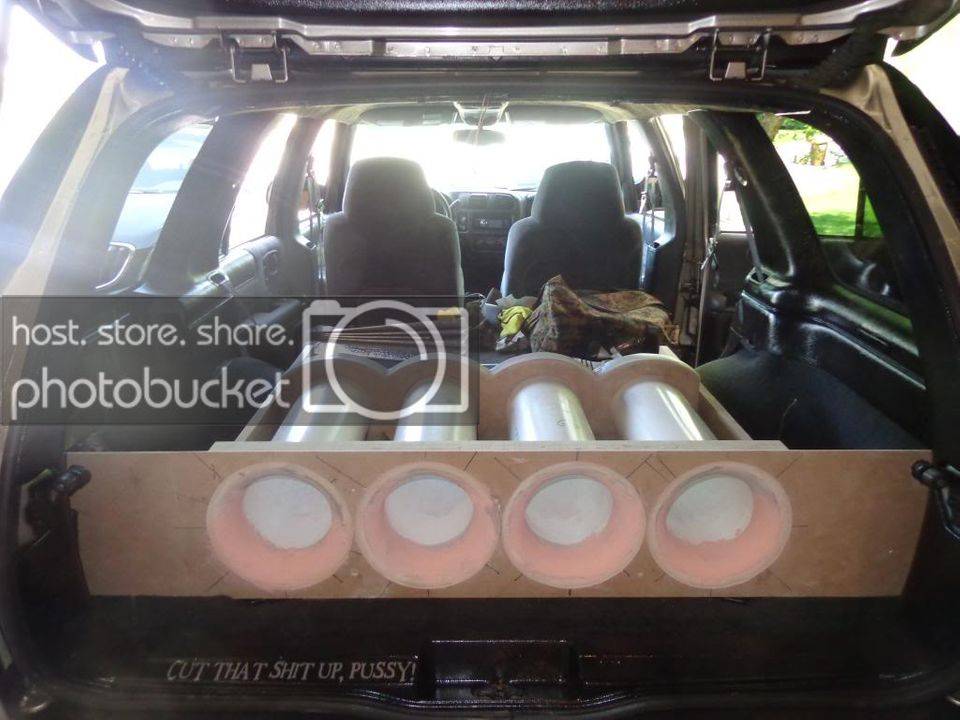

Test fit:
The fit is perfect.
There is 5.5" between port and the back hatch. Enough room for port to be breath, yet close enough to load off the back hatch.

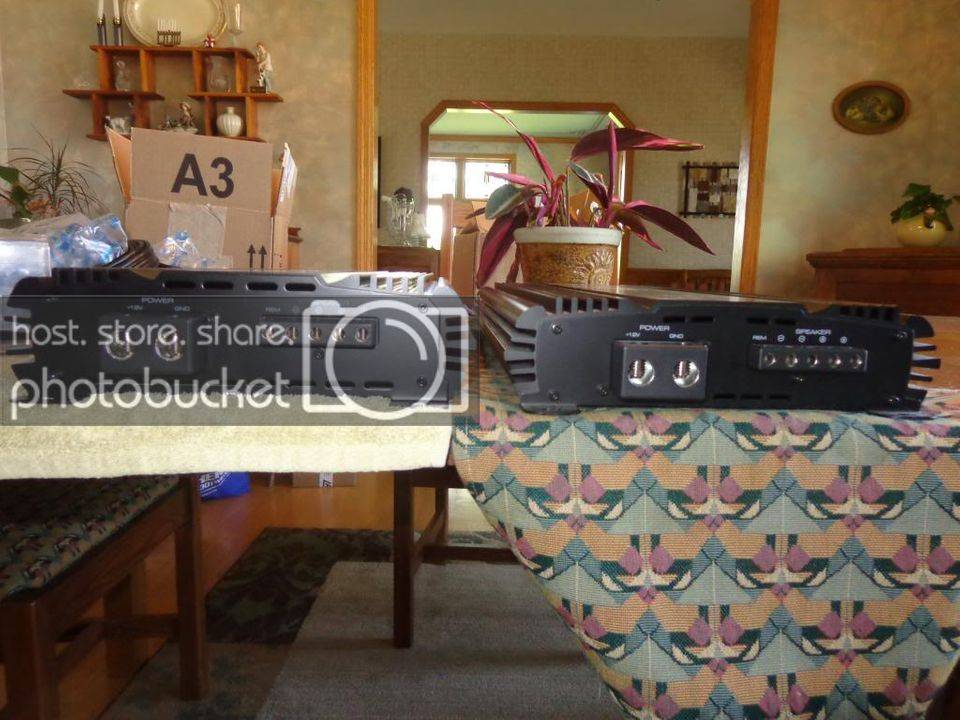

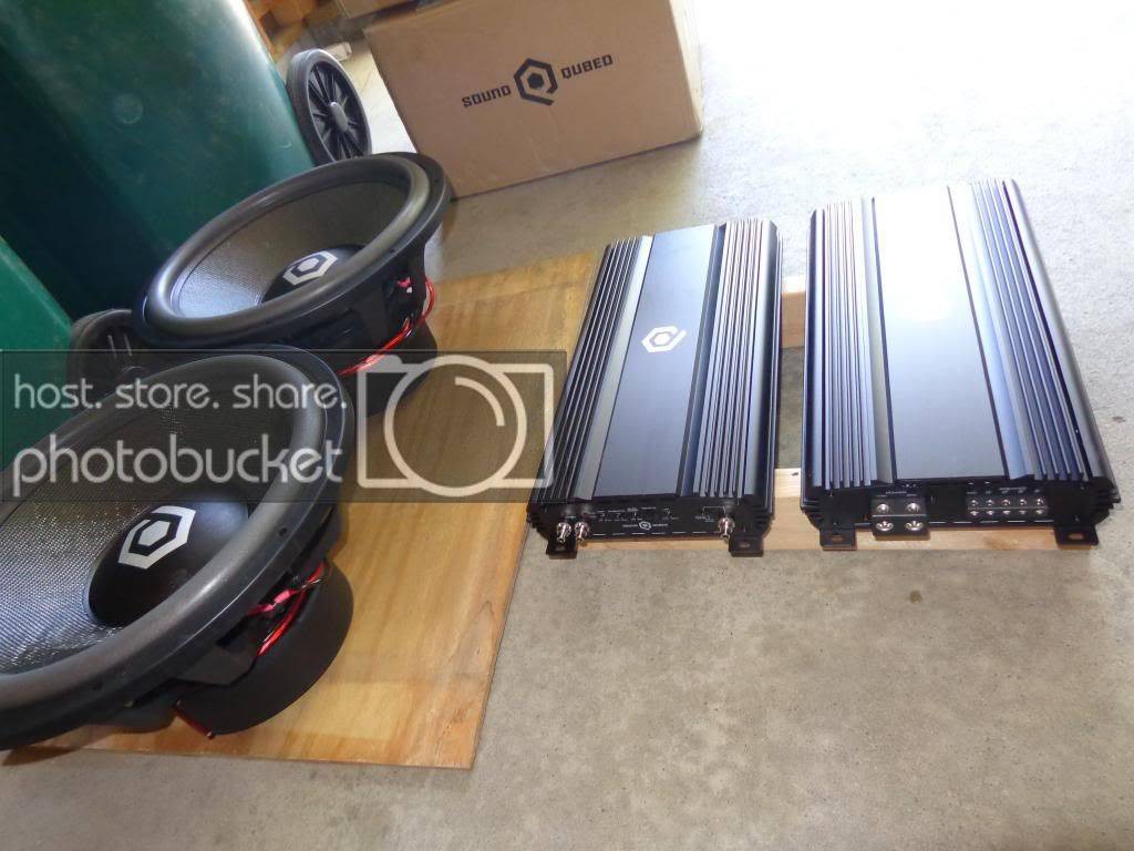

Equipment came in:
New amps are taller than the old ones. New one shown on left. Older model on right. Amp rack will need to be slightly lower now.
Work will continue after this weekend. The build should be finished next week.
