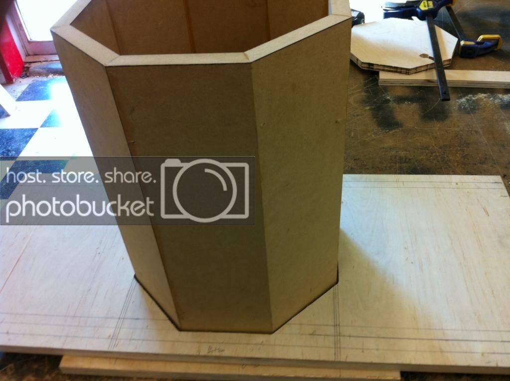

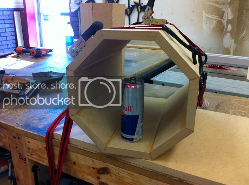

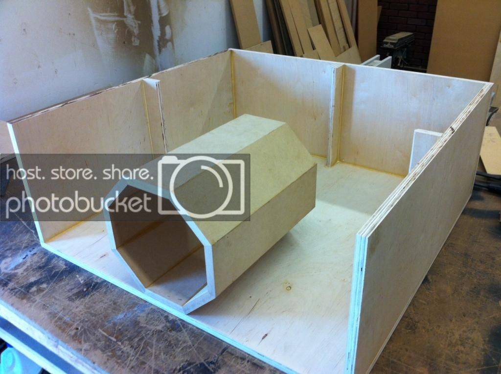

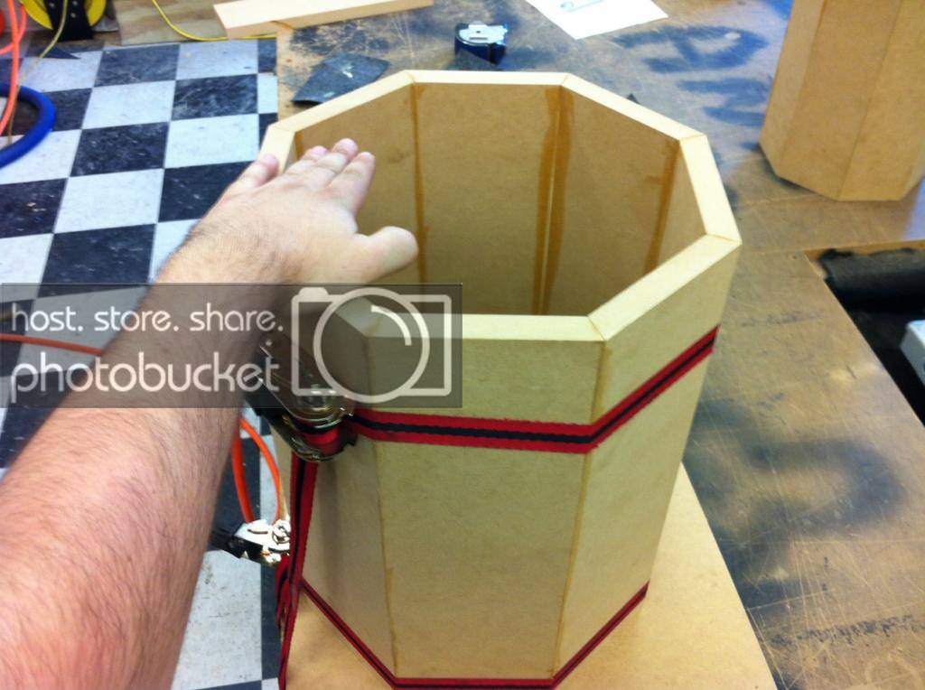

Shot of the port
Should be plenty of port area.

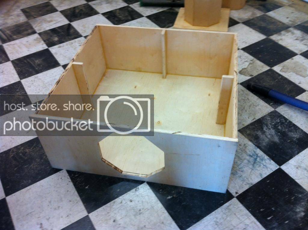

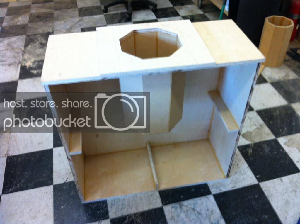

Just dropped the port in the box to see how it looks.

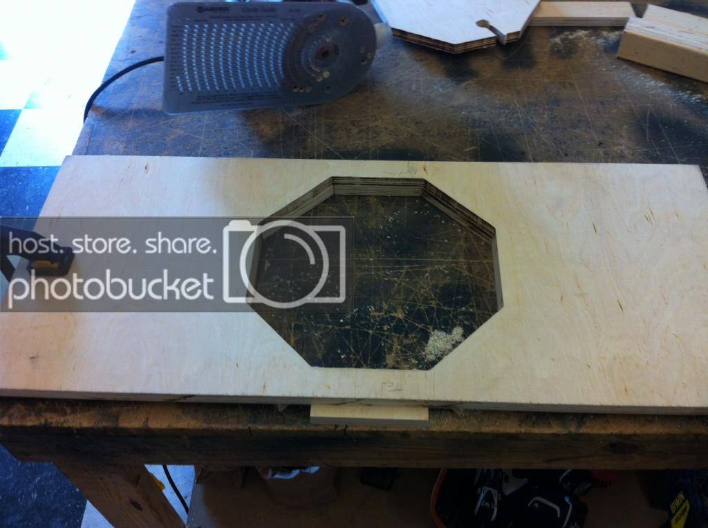

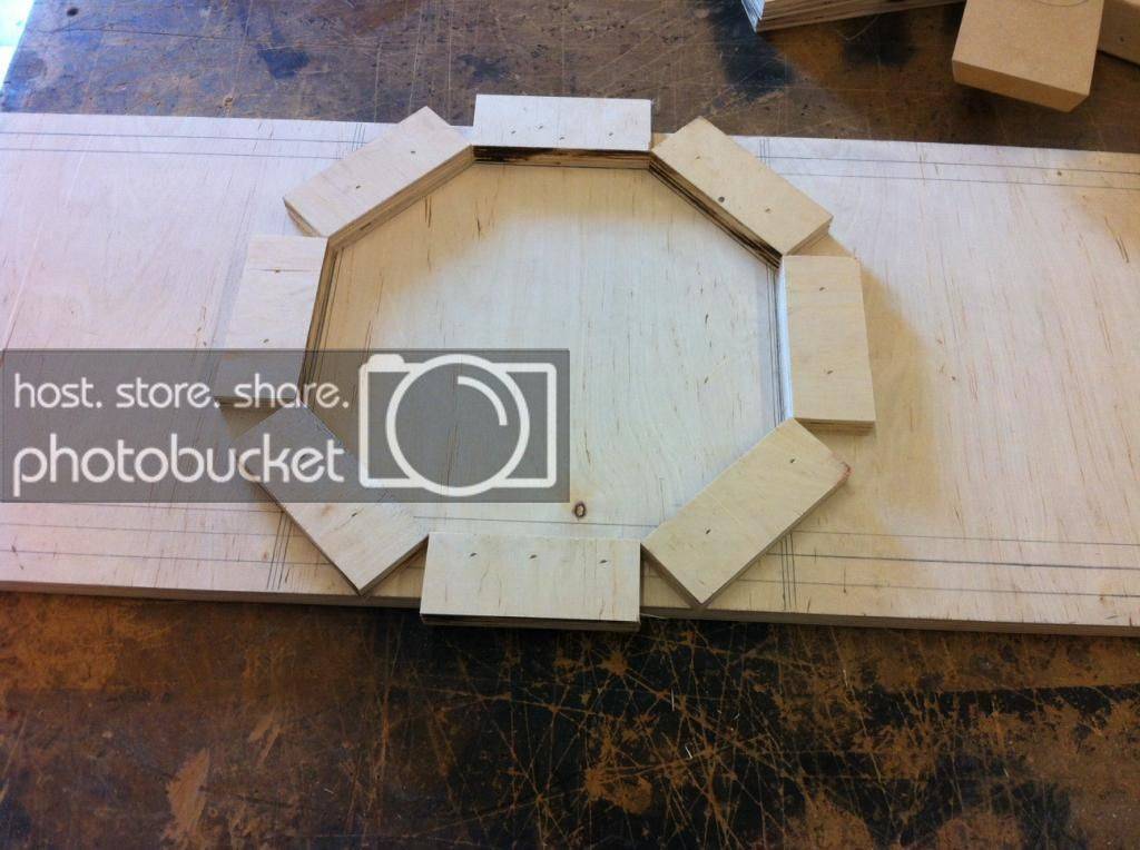

Built a simple jig for the port wall and tacked it in place w/ brads.
Flush trimmed it out....yea...I know...my bit is getting dull. I need a new one ASAP.
Snug fit around the port, about 1/8" clearance all the way around to allow for a little wiggle room.

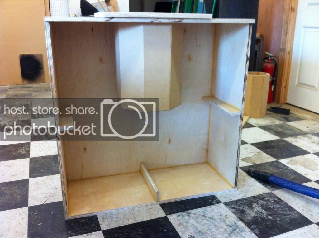

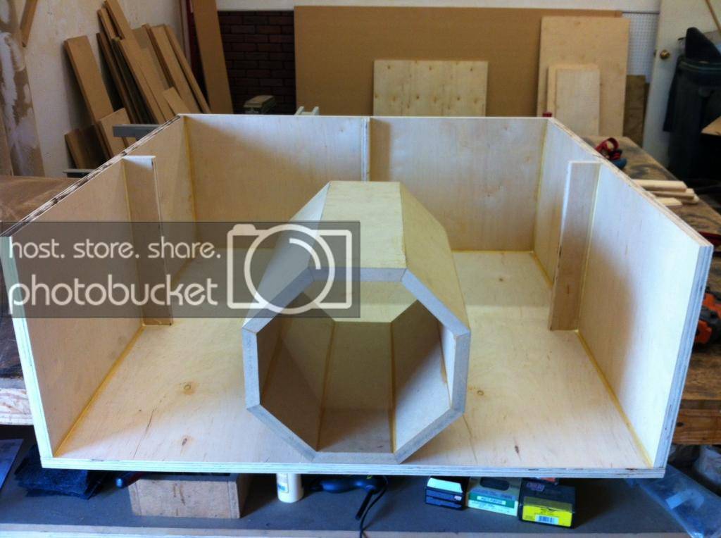

Just how the port will mount in the enclosure. Its a tight squeeze.
Have to build the baffles tomorrow, subs will be flush mounted. Adding more bracing and using T-nuts to secure the port.
