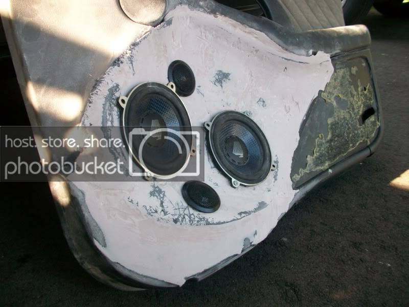

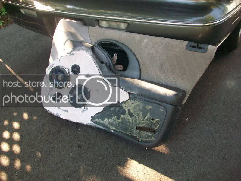

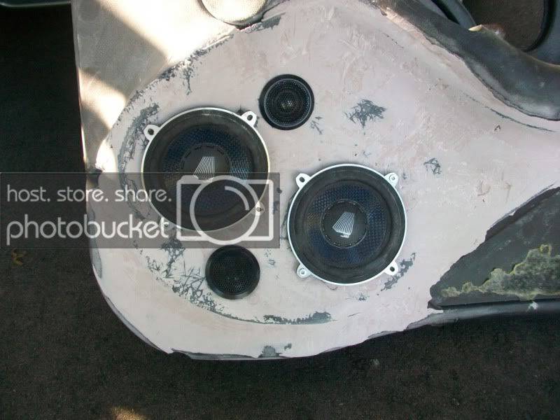

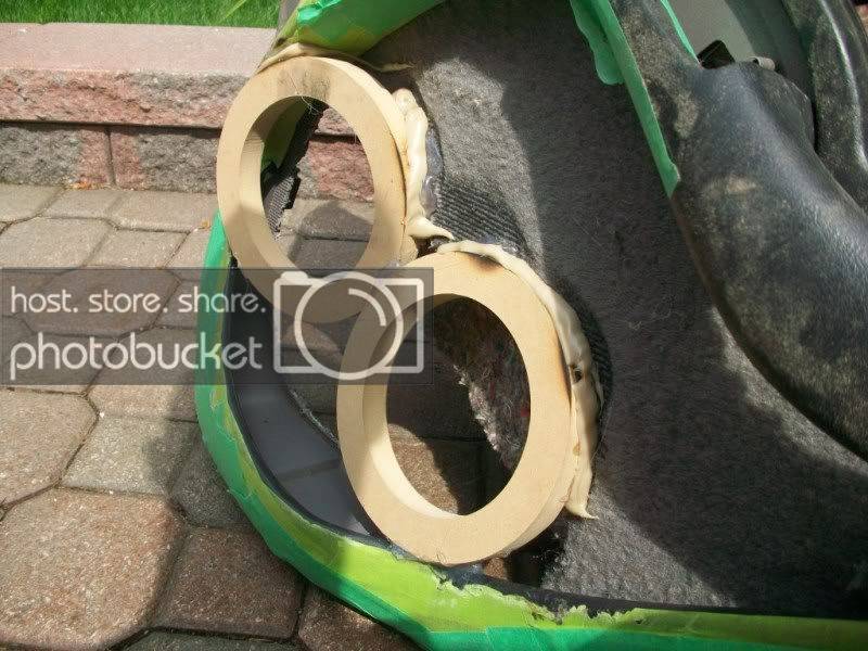

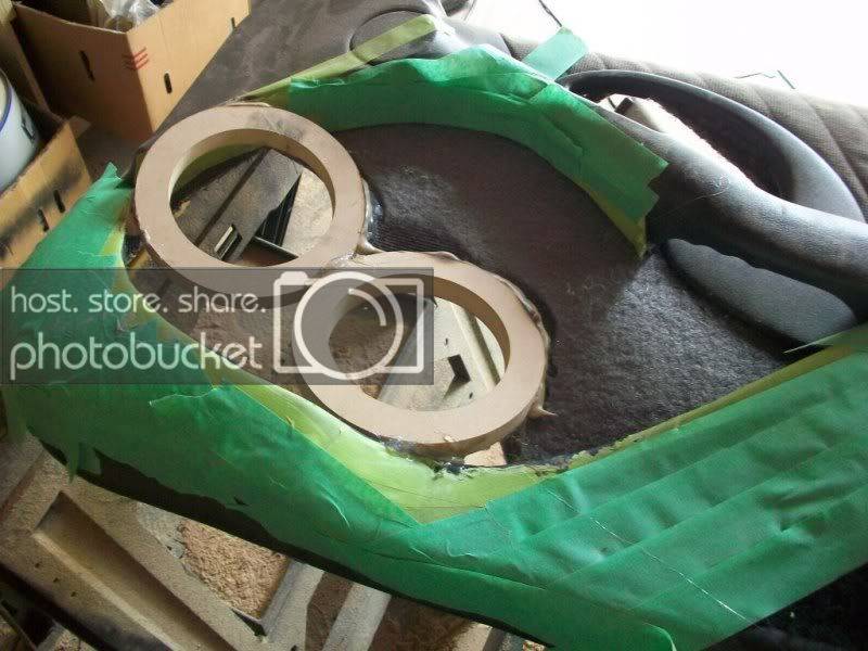

I gave my door panels to a buddy to do some fiber glassing for me! the idea is to get 2 sets of components in the front doors! (8 speakers total) and those will be done whenever and some of you may know him as Mike or Jalat over on CCA

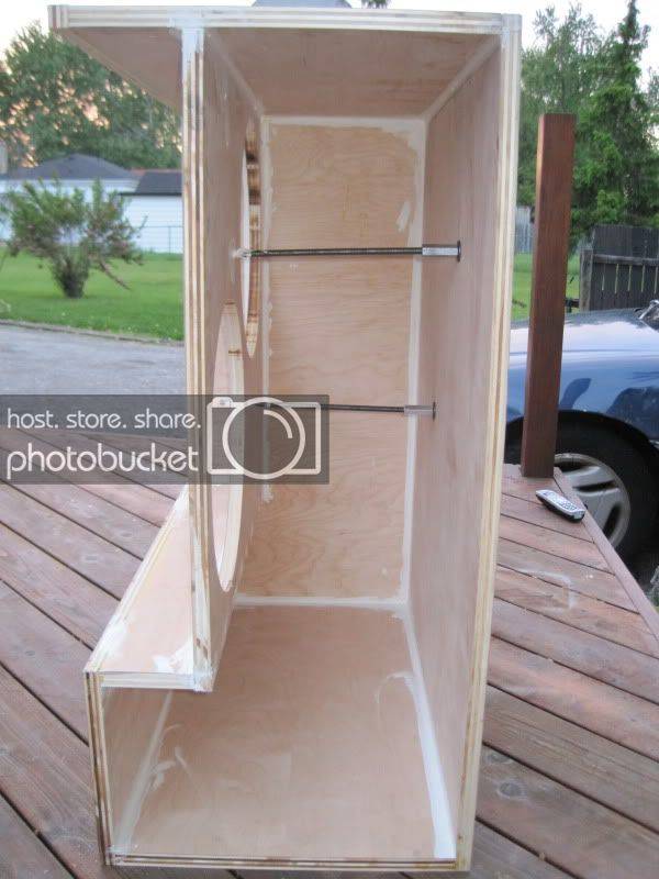

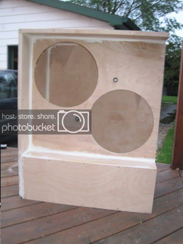

I also finished cutting out my cuts aka the sub and port holes! i ALSO give the box a test fit!
so here you go enjoy and let me know what you guys think!

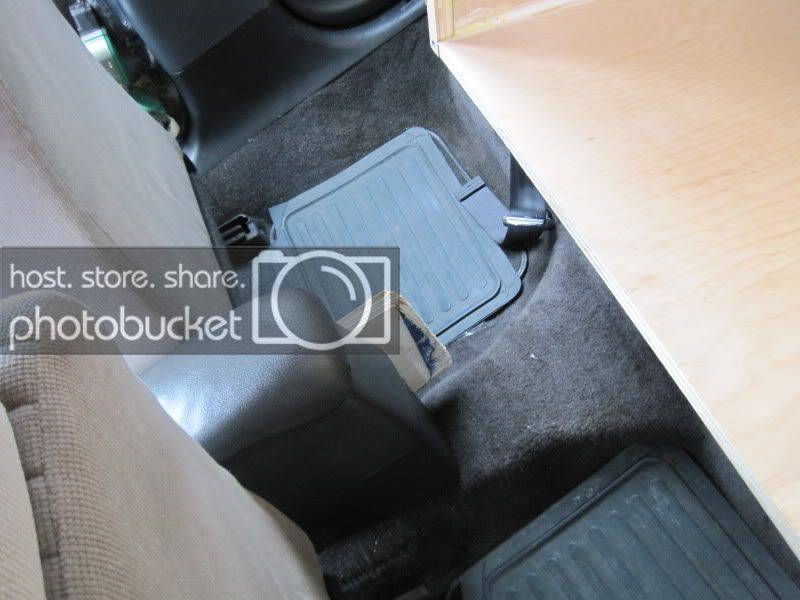

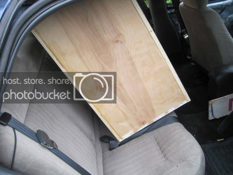

as you can see it ALMOST fits in with the rear seats STILL there! lol!
as can been seen once the rear seats are out i should be okay to get this in! I will have to flip it down!! and while it is up i will try to put the subs in!! i better get ripped in a hurry lol!
here is a pic of the box without the front on sure i screwed up on my hole location but meh it works out!
and another view of the box!

also as for the fab job i got buddy who is going to fiber glass them for me then as for finishing them i will make them a dark or a color to match the existing colors in the car already!
once those get under way i will also post some pics fo them!!

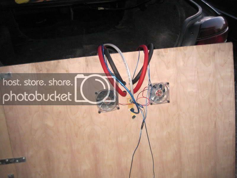

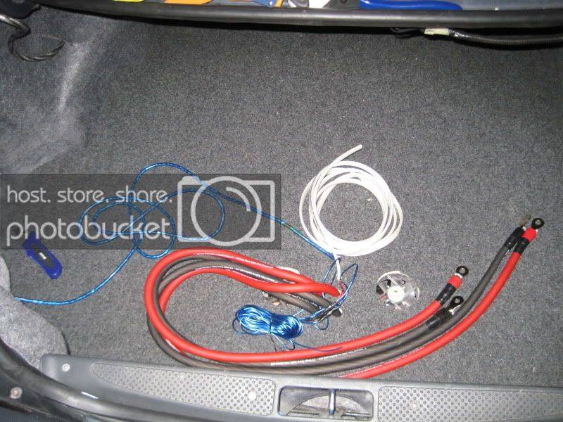

so i did a few more things today! take a look let me know what you guys thing and what i can improve on! i know it looks mess and yes there is a ton of extra wire but that allows me to be able to pull the false floor out and not worry about my wiring!

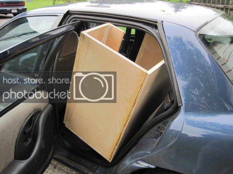

Me and Derek and his brother tried to get the above box into my car..and to sum it all up NO GO!!
SOB POS! I hate my like!
turns out the fist 1/2 of the box slides in like a peach then toward the rear of the car the whole thing slopes down on us... stupid grand am right up ticked me off for all the 2hours!
to remedy this issue i am going to switch the bottom piece of 3/4 to 1/2 birch and see what that does for me if anything!if that doesn't go i will have to try to switch the top half of the box also!

so i am going to use 1/2 on the bottom piece rather then 3/4 and i will now have to switch my 2-6inch ports for 1-10inch port! o joy! i can't wait!
so a new update is in order!
I replaced my bottom board with 1/2 (used to be 3/4) and the box slid right in!! who!
