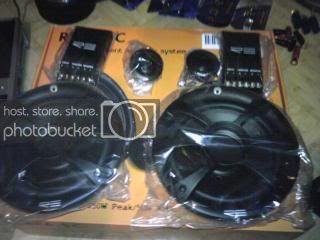

re 6.5 comps up front

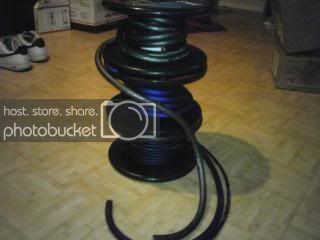

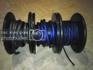

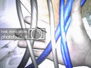

2 runs of kicker 1/0 hyperflex from front batter to back battery

kicker 4awg hyperflex to power sub and high amps
kicker 12awg hyperflex to power front and rear stage

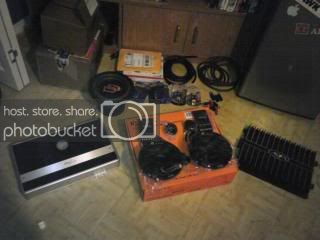

now for some pics.....

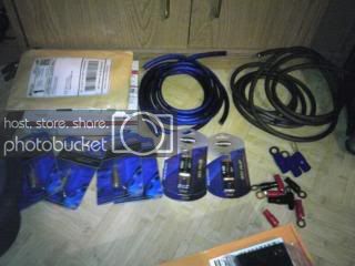

all the products awaitin install

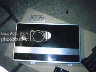

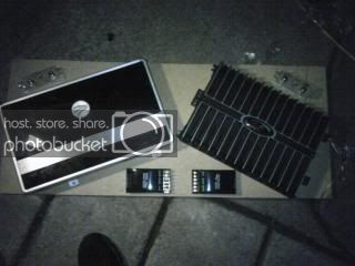

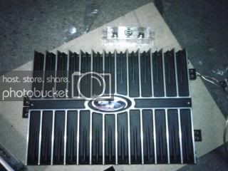

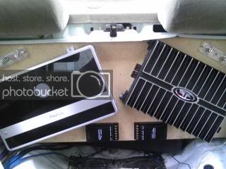

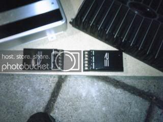

started off with amp rack. wanted to do somethin a lil different and be easy to hide...here are the pics....
it all mocked up
okay now time to bolt it all down and put it in the car letss seeee.....

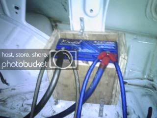

now time to build a lil box for the battery. and start running wire
as you can tell i love kicker wire!!!!
i cut up the doors to put the tweeters. im happy with location of them.
i have already decided to make a fiberglass pod for the 6.5's. right now they are in the stock location.

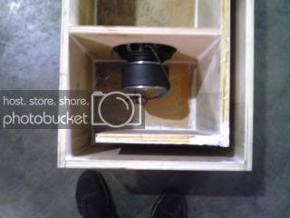

time to build the box! thanks to iamamp3pimp for the design. if you ever need a design hit him up! he was a very big help.
the design...
its a 6th order bandpass box
1 cube at 31htz and 2 cubes @57.71 htz

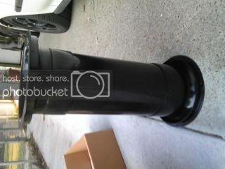

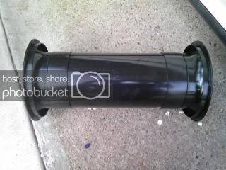

6in aero port 7in long
madeout of 3/4 birch wood. this was my first time workin with birch wood and ill tell you this ill never use mdf again!!!! now for the pics!!!

now all those pics the port walls were glued wrong. luckily i caught it b4 the glue set in. to i had to break it apart and more tport 1 and port 2 to the inside of port wall 2. in order to give me 1.5in of port. as you can see the baffle was to short due to the wrong position of port walls.

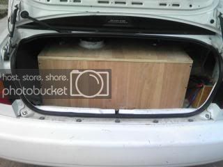

time to put it in the car and cut the hole for the port seal it up and test it out!!!
all done everything sealed and wired. looks good....

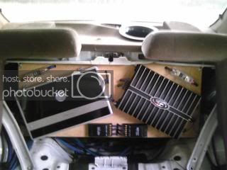

amp rack almost done jus waiting on my rear stage to get here.
when i put the seat on it you cant telll anything is there! i kn ow thats the point!
when i open the trunk this is what you see
