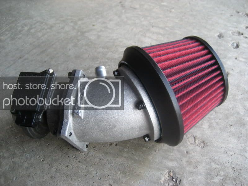

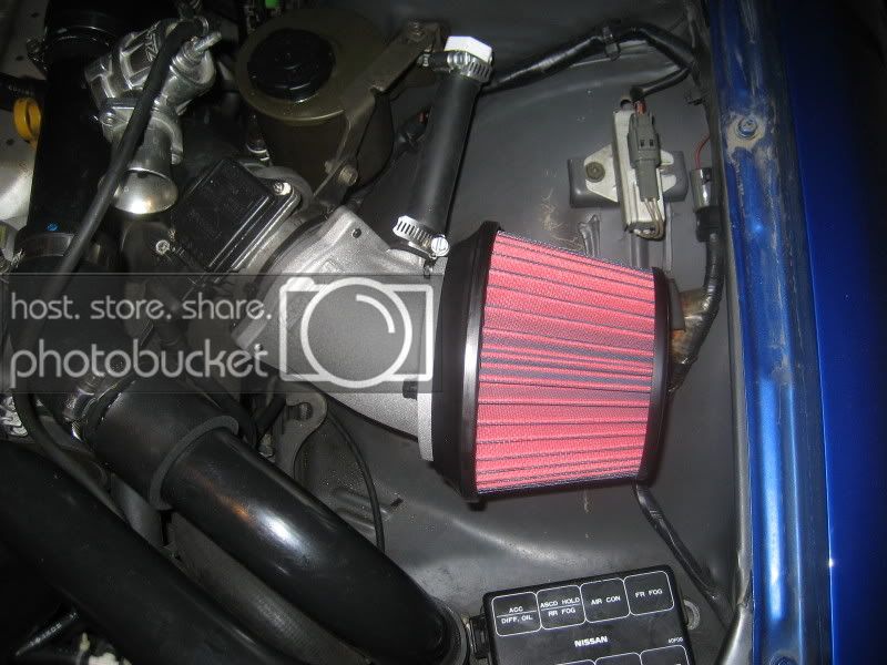

well my car is heading off to get reinspected tommarow. on tuesday i pick the car up and register it. before i took it in i installed the new filter. i think there is a leak somewhere but ill get it fixed. once i get it back its going into the shop at my school and all the fluids are being changed and it is getting an allignment and being lowered a bit.

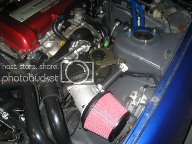

im not exactly sure whhat the hose coming out the side is for. my friend said i can just plug it and not use it. so thats what i did.
i have a hose coming out the side of my intake too.. forgot where it goes though :/
yea it doesnt really make sense...there is nothing within 6"(or however long it is) that it could attatch to. ill eventually figure out what its for and attach it accordingly.

now that i remember... theres a long windy hose that connects somewhere on the intake manifold IIRC.
If your stock one didn't have it though, i don't think you will have any loss.
you are right, i found that hose and got it connected properly

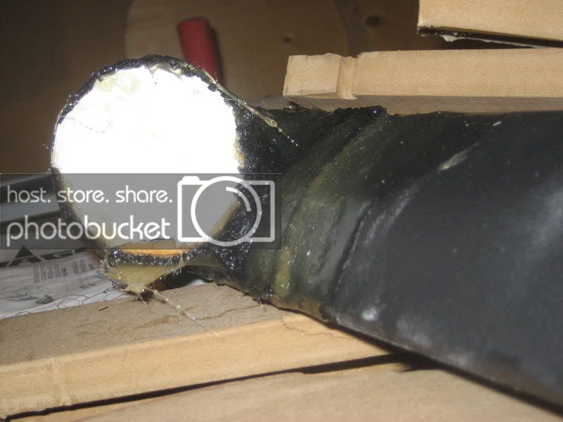

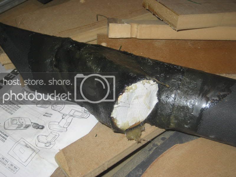

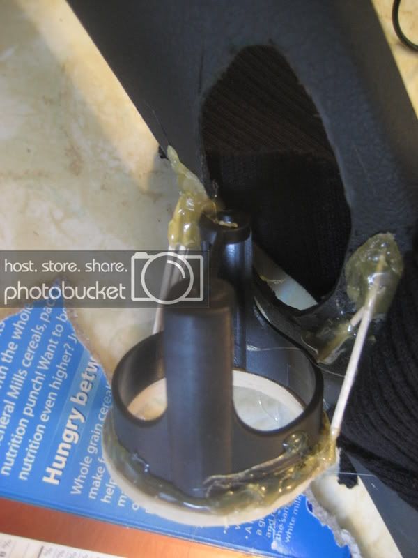

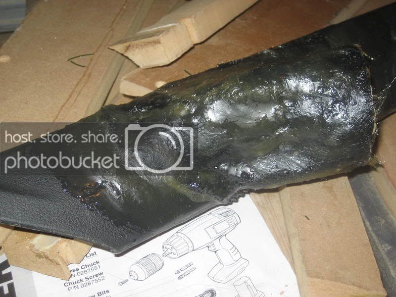

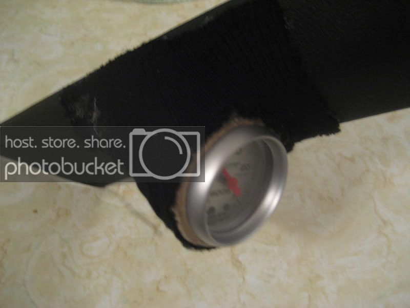

i started working on my new boost gauge pod yesterday
first i made a ring out of 1/4" mdf, then using toothpicks and hot glue i set it to the angle and position i liked. following that i used this stretchy sock like material and wrapped the peice. then i cut out an area behind the ring so the guage depth could go through the a pillar cover. following that i covered it all in resin, and went over it again doing a layer with some fg matte. this morning it is pretty well cured. i will do a layer of fillerglass soon
