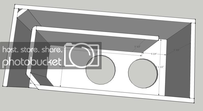

I'm thinking about getting a set of little ED test 8" off Skip01, and I have a 6" aero in house. Ed says recomended box size for spl is 1.5 tuned to 35... so if i got it to 3.25 at 34 i wouldnt need to cut the aero, it would be the full 17" long and i could use it later if i want. and the subs RMS are 100 a piece...
This is just an in home project, but according to the specs, do you think i would get results?
Heres a design i did with a loading wall inside, comes out to be 2.5 cubes, tuned to 34 with the subs down firing, 4 in off the floor. What do yall think?

Ok I did another one up, its more like 2 cubes tuned low, around 30ish i think. I'm not really sure though. Could someone check it for me? the total port length is 35" and the port is 3" wide. The rest of the dem's are in the pic. Which box do you think would be better? Thanks
