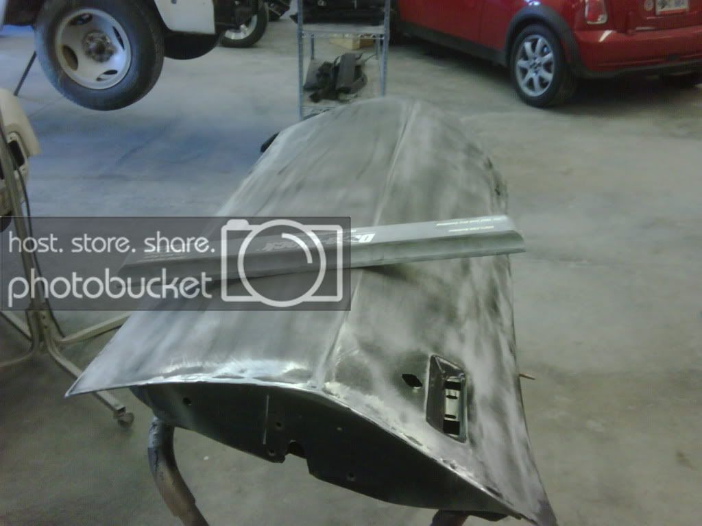

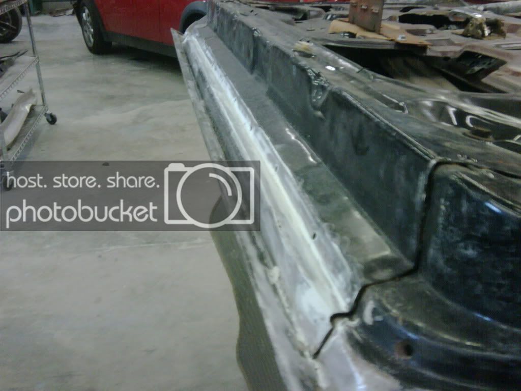

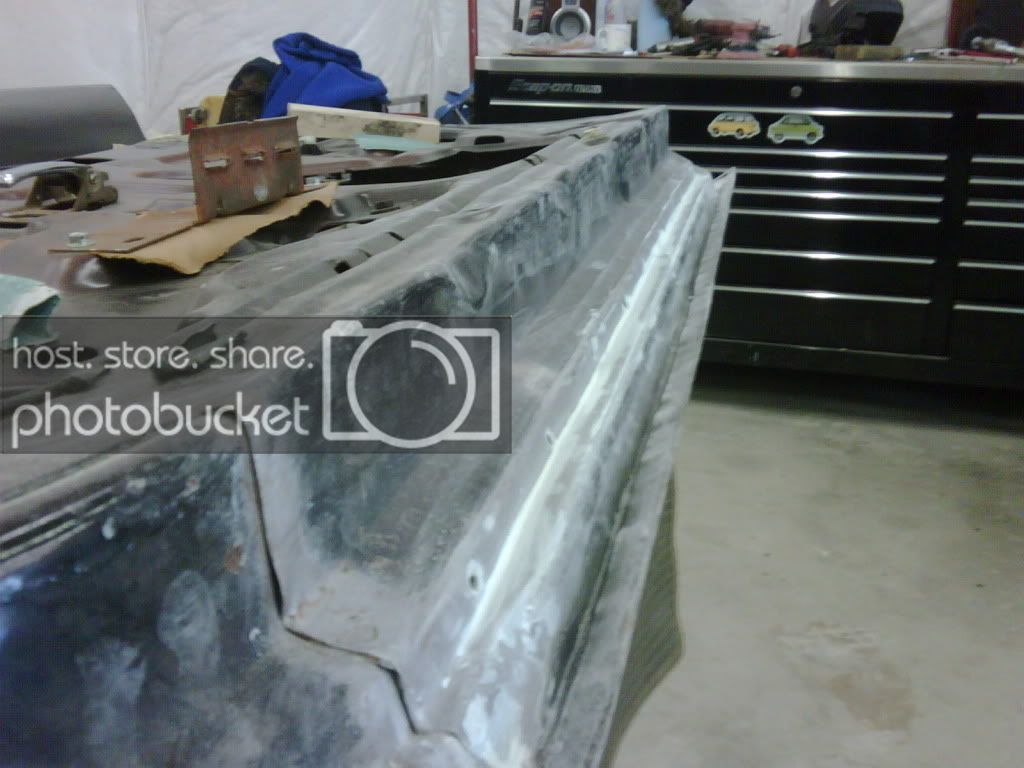

working on the bottoms of the doors after cutting out some rust

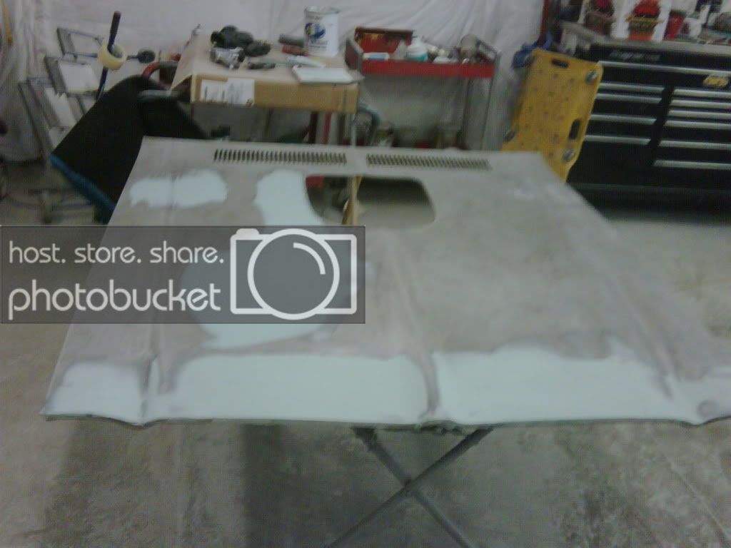

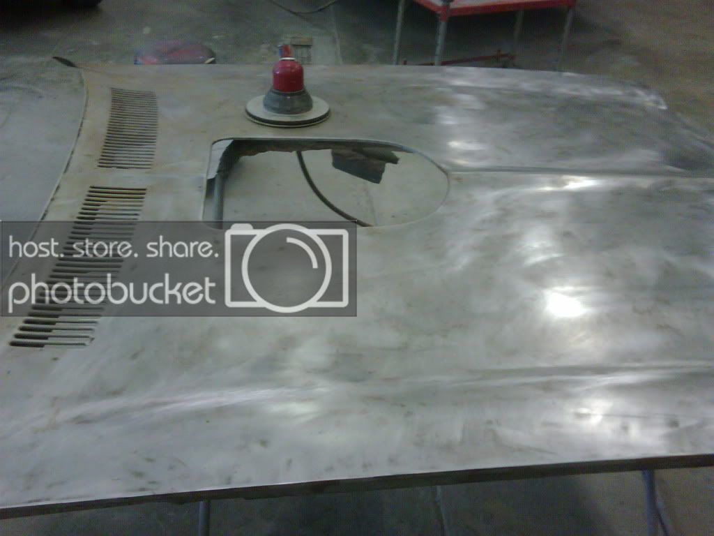

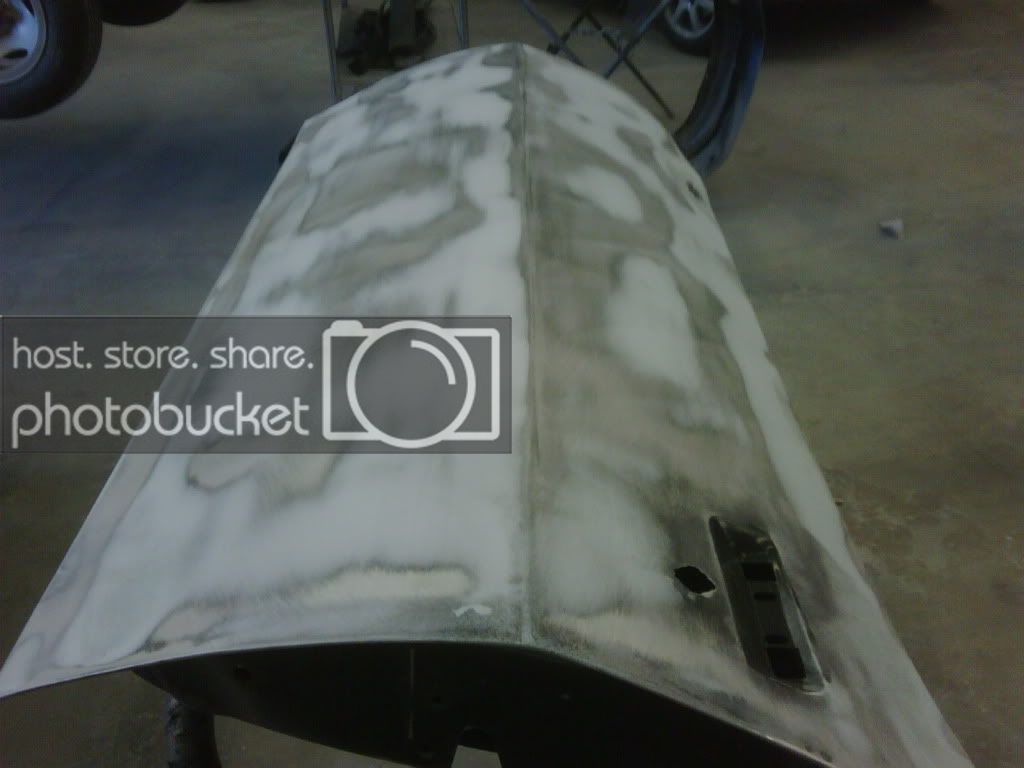

wavy hood

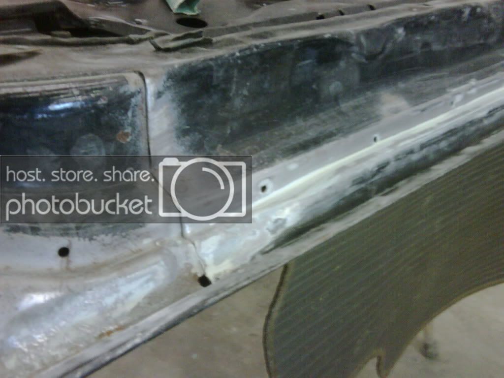

more rust spots fixed
didn't think new oem skins would need so much work to get them straight..

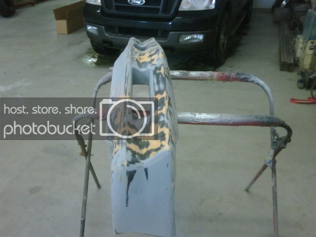

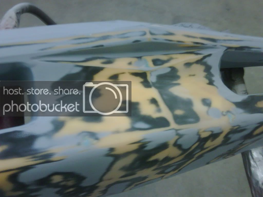

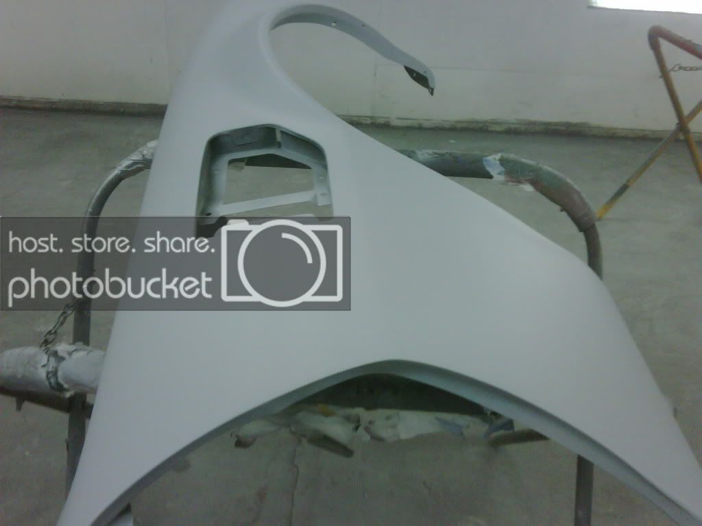

urethane - plastic prep + primer = oops
more awesomeness
first of five coats of bondo
sanded

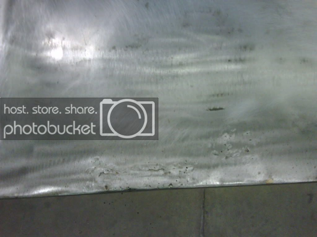

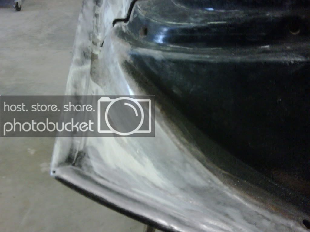

brazed up little pinhiles cause it's easier than chasing them with a mig for hours
knocked them down with a grinder

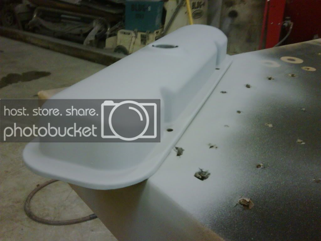

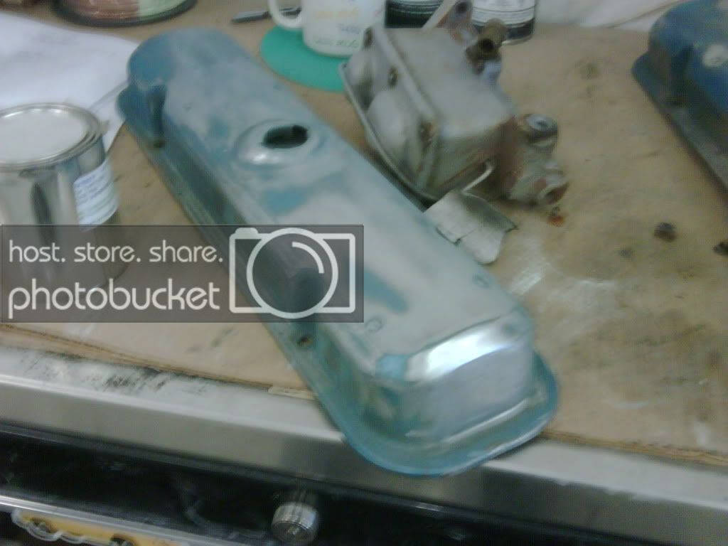

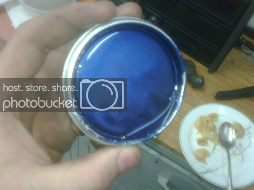

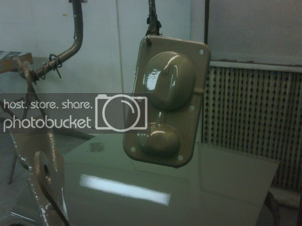

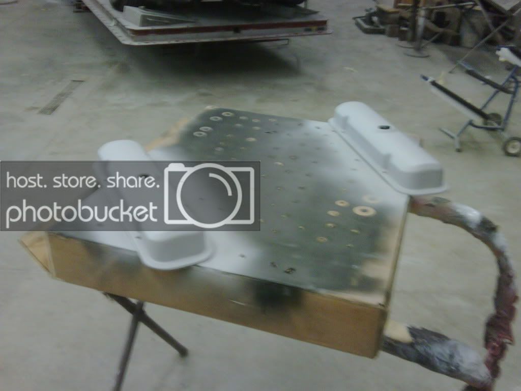

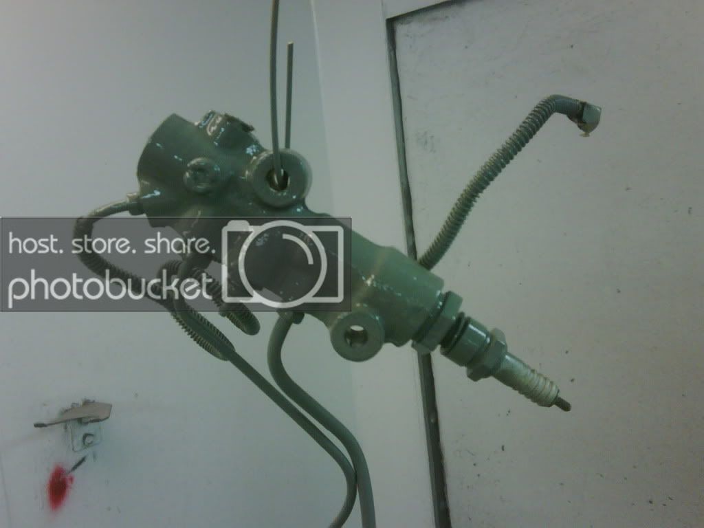

valve covers getting chrysler arrival blue and matte clear along with master cylinder, proportioning valve and miscellaneous bolts
When I was prepping my '87 Fiero it looked like that but it was metallic blue, yellow and black covering the ENTIRE car. I ended up actualy likeing is so I just left it like that for a year or so, then I put it up for sale so I had to paint it. Don't forget the flex agent when paint time comes //content.invisioncic.com/y282845/emoticons/wink.gif.608e3ea05f1a9f98611af0861652f8fb.gif

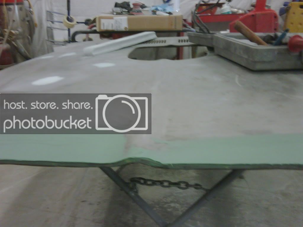

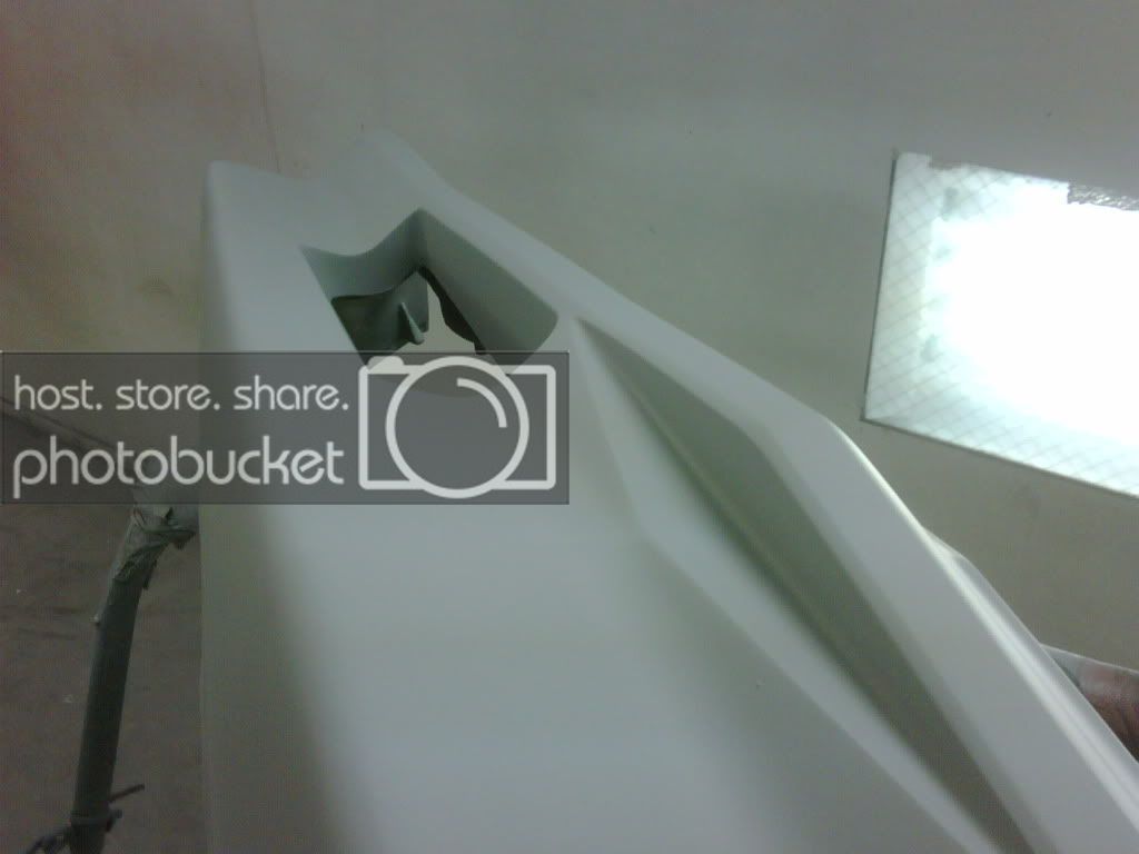

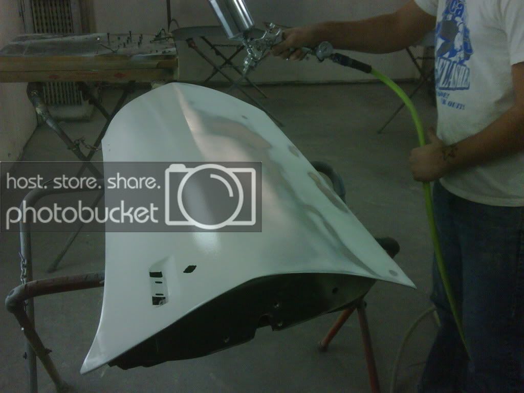

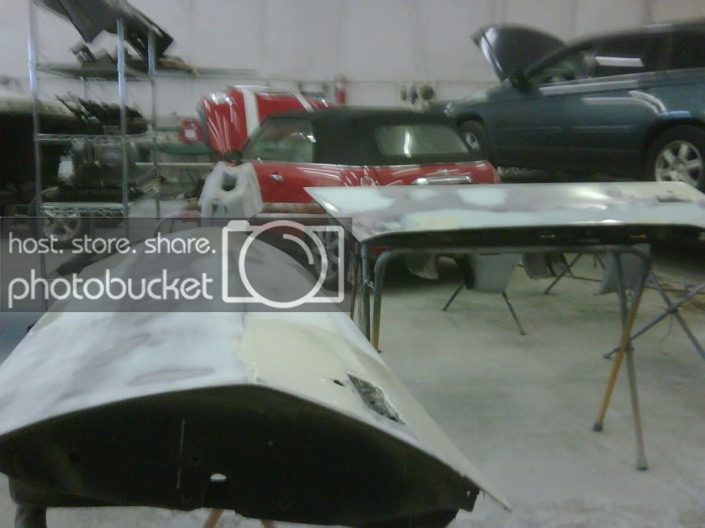

duraglassed hood
two coats down, 49998 to go

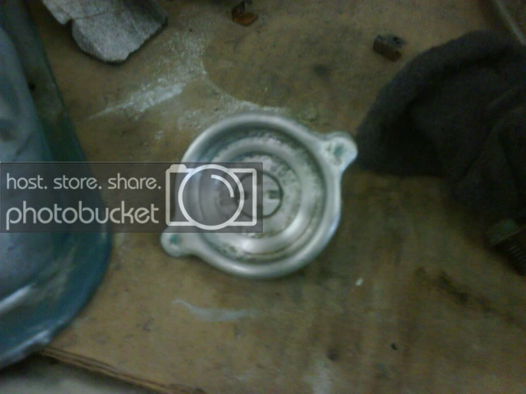

valve cover cap is gonna be cleared cause i like aluminum

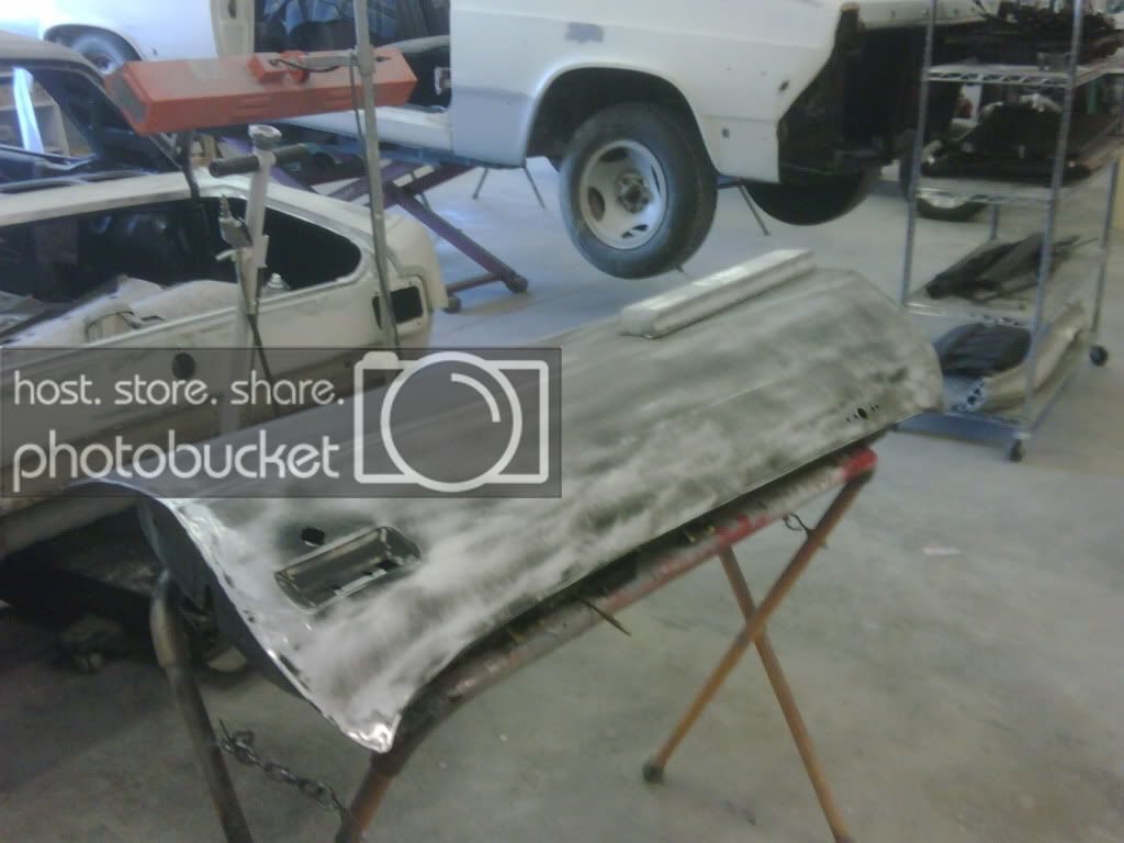

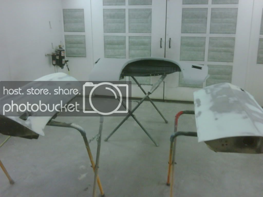

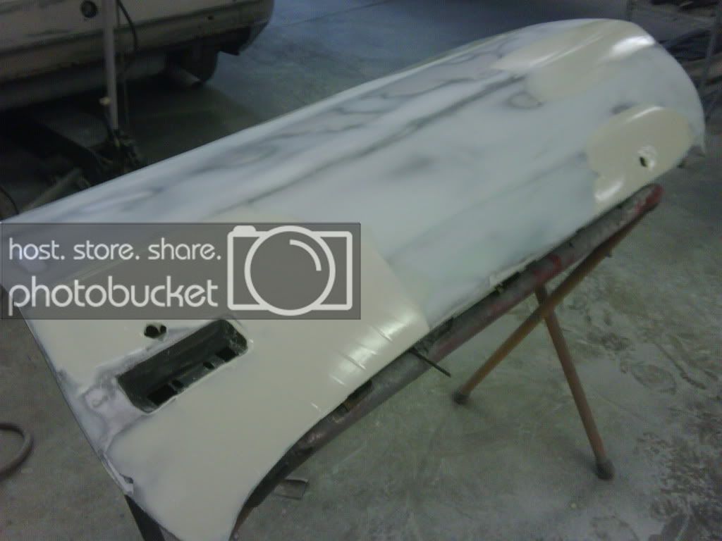

glaze coat on doors
both ready to block before feather-lite
don't worry i primed it with plastic primer and when everything is ready to paint i will use the adhesion promoter/flex agent. learned my lesson :/

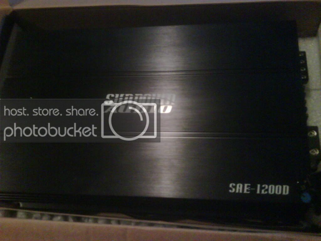

amp

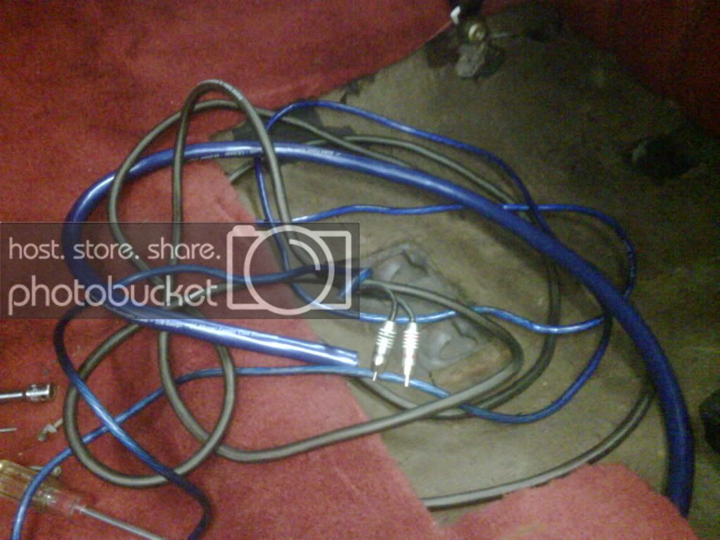

wiring ran

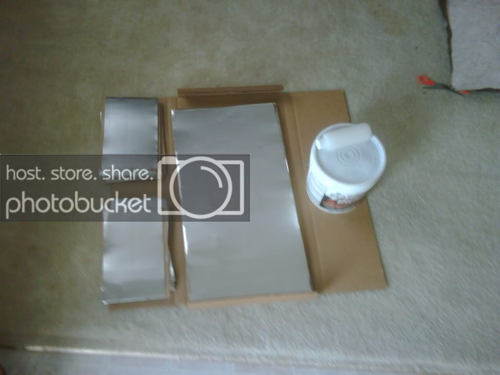

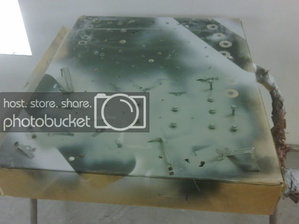

doors are primed and hopefully i start deadening tomorrow. weirdness went on with my ssa order and i got sent some old old damplifier pro instead of regular black damplifier. i called and talked to anthony (GREAT guy btw) and he just sent me a new pack of black free of charge. that's great customer service! but i think ups did something because the package was scanned on the 18th of december and just got here yesterday, the 4th of january. oh well shit happens but it's all goood.

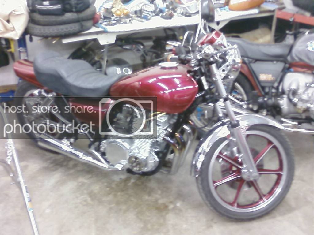

let's start with the kz1000 my dad built for his buddy
chromed out motor, exhaust, chrome six inch extended sway bar and chrome everything else. personally i'm not a fan of chrome but it's not my bike..

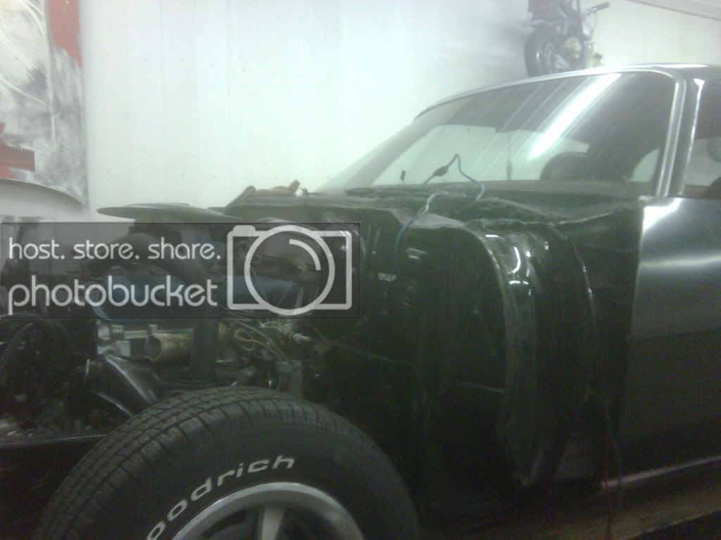

that nice bimmer in the background was my first real crash. wasn't so nice after i was done with it. fucking score!
edging out the fender

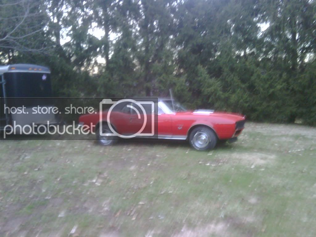

this is the only pic i have of the maro right now. if it's at the house tomorrow i will snap some pics of it if you wanna see more of it. maybe i can steal the girl's cam and get some deec pictures of it

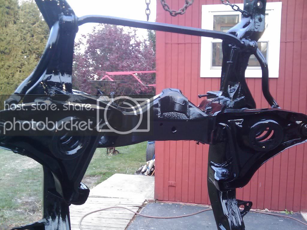

subframe
