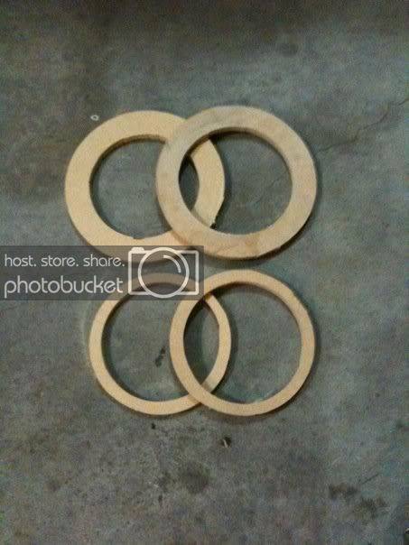

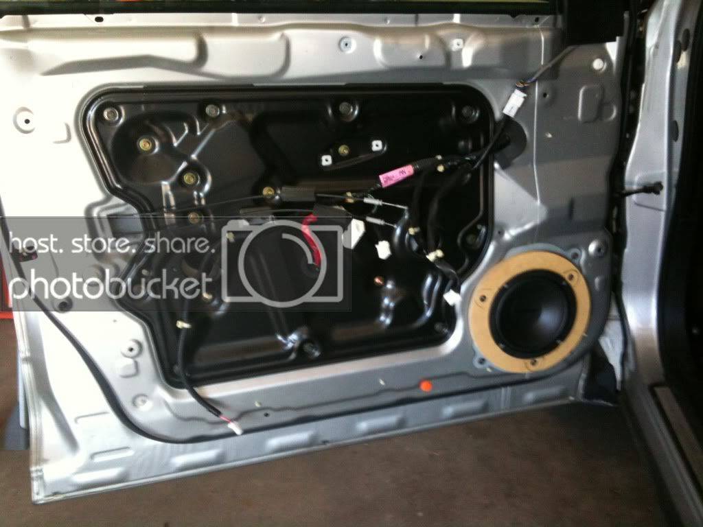

At this point, I ripped the door panels off and measured for baffles. I cut a set for my Seas, but had to cut new ones for the slightly small ID's. Here they are, lovely things:
I actually cut the big ones out for the rear doors but they wouldn't fit, then coincidentally they fit the front doors great. It's really nice to have screwups be useful, especially since I've probably cut out 15 pairs of baffles for only a few installs. Anyways, the mids went into stock door locations, which are close enough to the kick panel area that it works out.

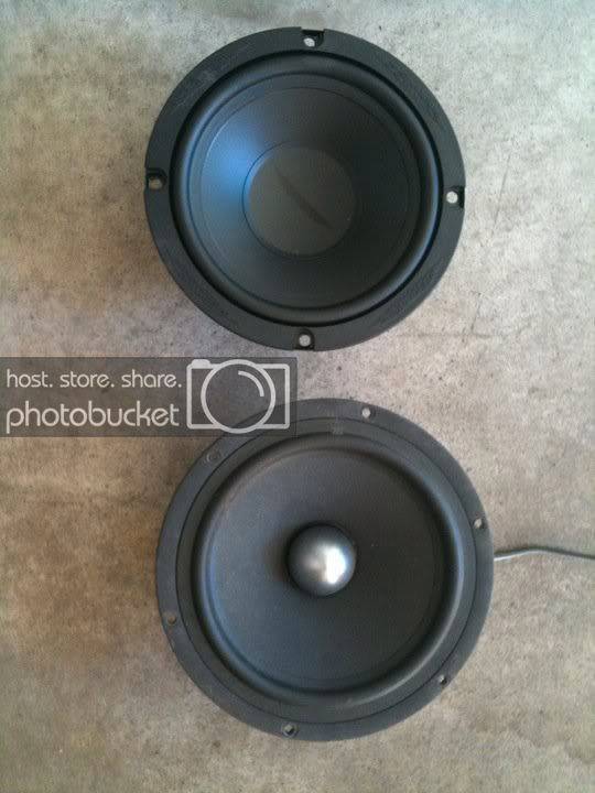

Here are my ID mids compared to the Seas:
Not that much smaller surprisingly, since the Seas are large 7" speakers. The 3" mounting depth of the ID's was no big deal after running those bad boys. SUV's give you a lot more room to work than little sports cars!

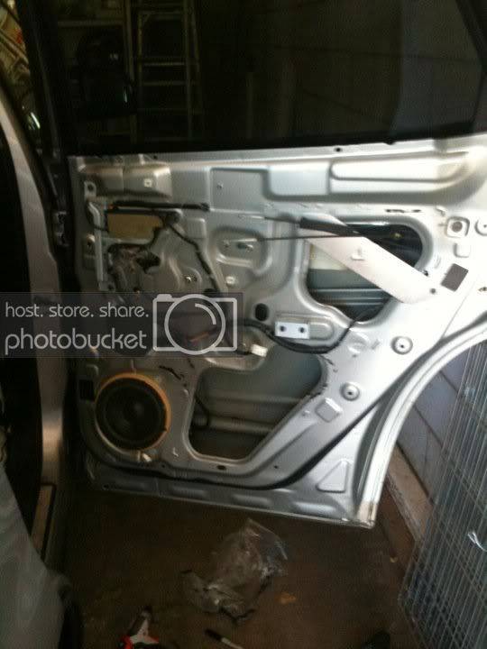

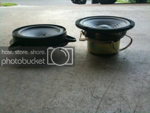

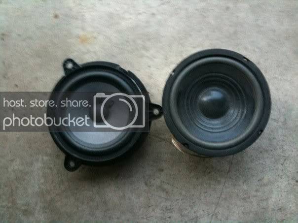

I then did the rear speakers, replacing them with 6.5" Goldwood DVC subs. I'm not a big bass head, listening to mostly rock music of various kinds, and every previous sub system (dual 10's, dual 12's, single 12's) has been overkill. So at about $10 a pop, I bought a couple of these to try out. Here they are compared to the stock systems. Just a tad beefier.

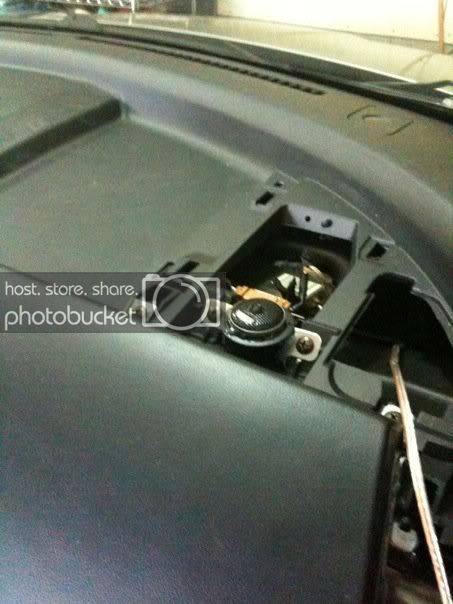

I don't have any pictures of the tweeters, but here are the stock locations and my old Alpines:

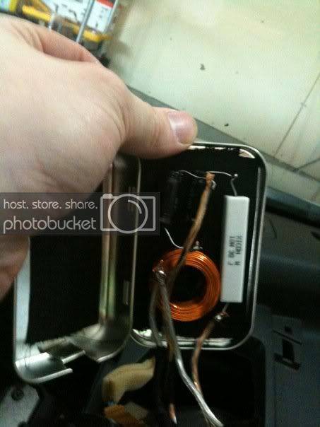

Side note, here's a fun little crossover I built for the tweeters:
Right now I'm still playing around with the positioning, but I've got them in the kick panel area. Up in the dash they were just overbearingly loud. Down in the kicks they have great detail and balance, especially since I have no processing. But I'll get to the full sound later.

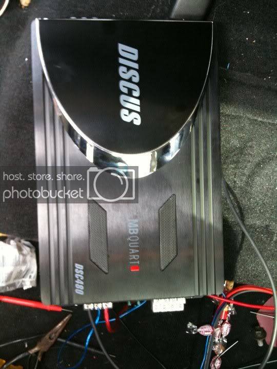

Also, here's the amp:
And the crossover compared to the old Alpine:

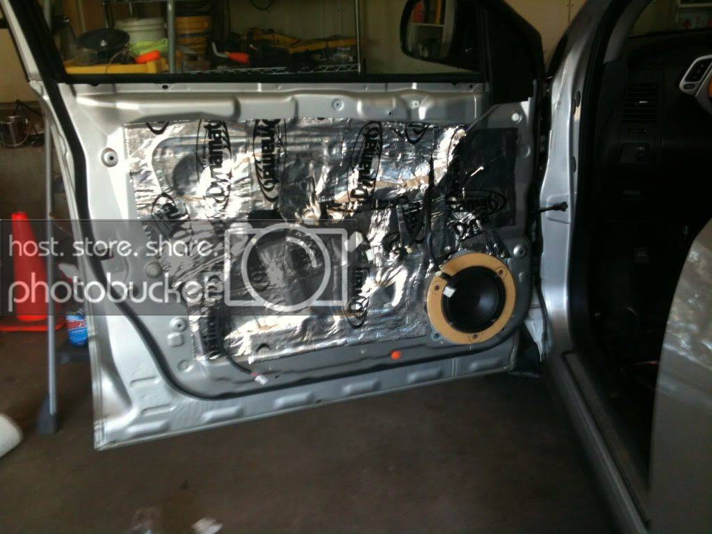

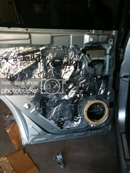

Today's big project: sealing the doors! I had a big box of Dynamat leftover from my last couple projects, so I thought I'd throw some up. If you couldn't tell, I'm a lazy bastard, so doing the full car is out of the question. I can barely do a full door. Here's my half-assed attempt today:
Before (notice the large holes):
After:
I've just done the rears, about to do the fronts, but the difference was pretty big. To be honest, every time I've used Dynamat I can barely tell, but because of the giant gaps my sub bass increased quite a bit. You'd be surprised to know it's just a pair of 6.5" subs in the rear doors, aside from the fact that it doesn't really kick hard or anything, which is fine by me. Also, it helped that I actually screwed the baffles into the doors this time!

I've played around with the positioning of the tweets a few times, and I think I like them best closer to the doors and higher up, basically just a bit below the bottom of the dash. They're pointed roughly in front of the opposite side listener. Having them lower made them muffled and skewed the imaging, while pointing them more on axis was obviously harsh and biased toward the far side.
Here are the front doors before and after:
I will say, sealing the giant holes and deadening the rear doors REALLY made a different. I was listening to "Cave In" by Owl City, which is a great test of the highs and lows, and all the lowest synth parts played really well. The higher pitched bass synth is coming through louder, so I'll probably try the "low EQ" boost and lower the volume a bit and hope that evens out. But holy crap, it sounds at least as good as a single 10" sub, and with a bit of EQ these would MORE than do the job. Not heavy hard hitting bass, but just really strong musical low end. I don't think they'll take a lot of power though. But yeah, sealing the rear doors was huge.
But the fronts...didn't make much difference. I'll say I rarely notice much difference when deadening doors, and these ones were already fairly well sealed (unlike the rears). It did reduce some rattle, but the sound didn't clean up much. Oh well. Maybe I'll get a bit less road noise out of the deal.
