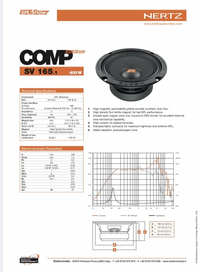

Hello all has anyone used these by chance? Looking to replace some old alpine 610c sps 6.5 comps. My amp can push 200 watts rms x 2 any suggestions on alternatives also appreciated.
