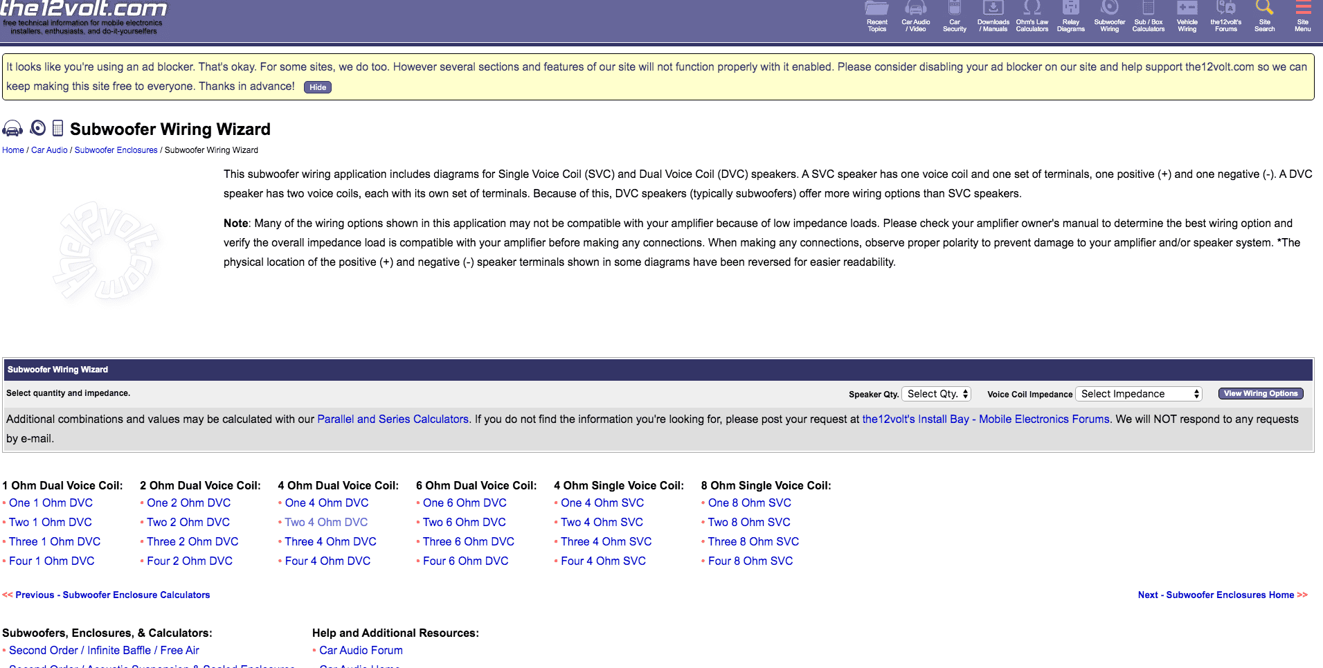

Here is a subwoofer wiring calculator for you.

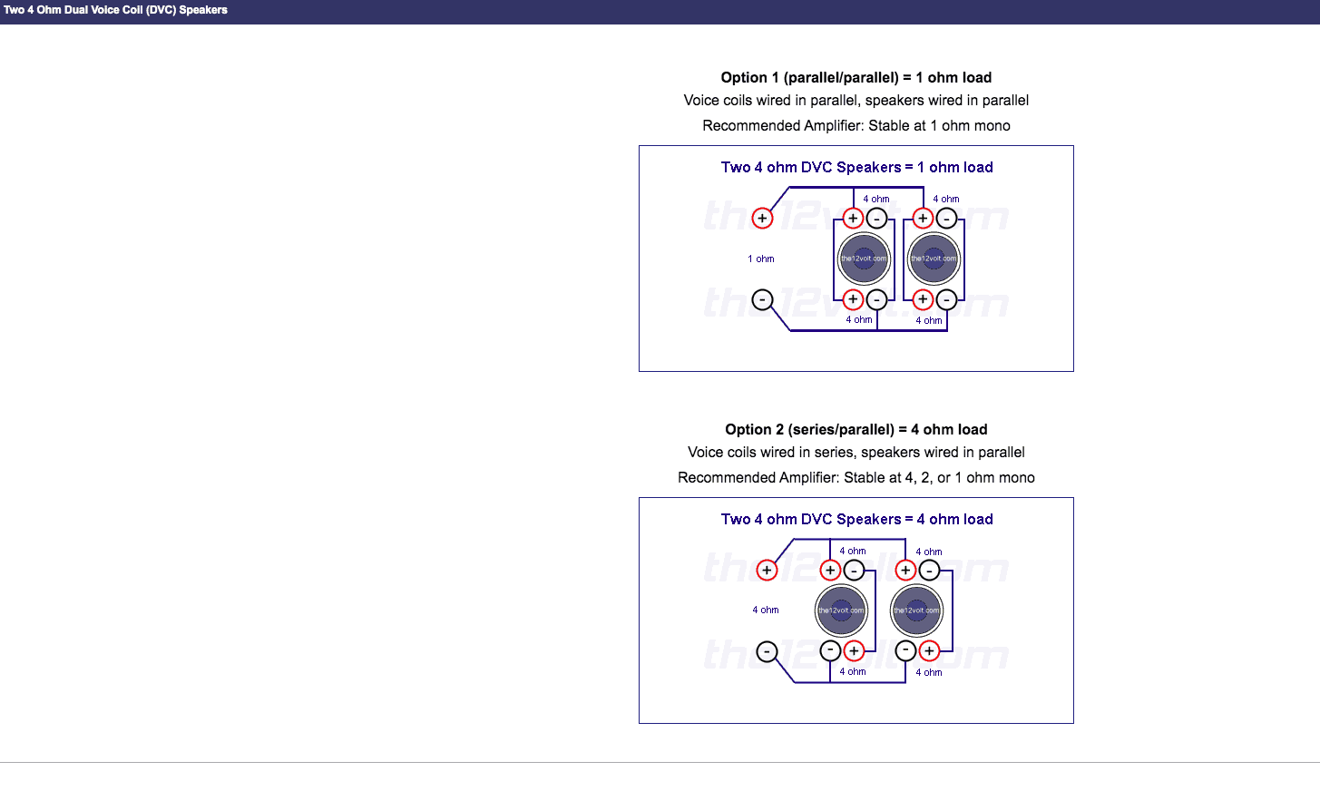

Say you do two 8" subwoofers under your rear seat. I would probably buy two Sundown X8s with dual 4 ohm voice coils. That way I could wire them in parallel to a 1 ohm load as most amps do the most power at a 1 ohm load. I would match them to a Taramps MD3000 amp.

Sorry about the random talking. What do u mean by paralleling them? How does that wiring go? How does paralleling 2 4ohm speakers make 1 ohm? So yoire saying that you'd wire both speakers together and hook them to a monoblock 3000 watt amp? So would that mean each speaker would be 1500 watts each?
Yes. I posted a link that gives you subwoofer wiring diagrams.

It's a calculator. You have to enter what you are trying to calculate.
