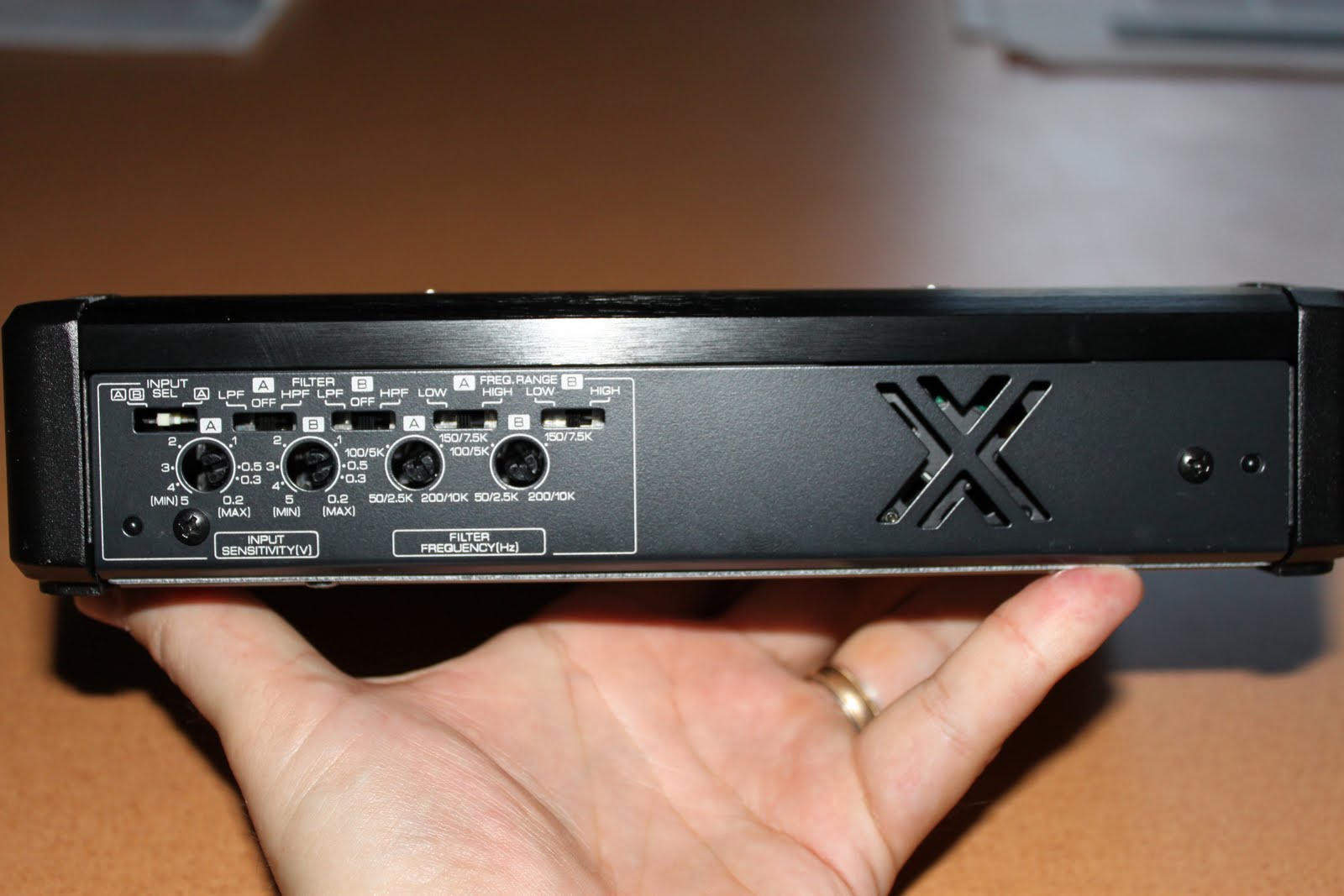

Mine
Kenwood - XR-4S
The XR's (I don't know anything about the older X's) are tiny and heavy. Literally feels like you are holding a brick. Gobs of clean power, and nice crossovers. I run my front comps active off of it.
Like I said, lol..
...tiny. //content.invisioncic.com/y282845/emoticons/smile.gif.1ebc41e1811405b213edfc4622c41e27.gif

Mine
Kenwood - XR-4S
Like I said, lol..
