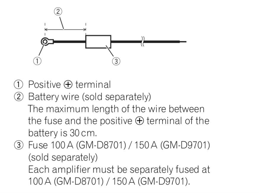

I'm looking for a cable kit for this amp. Pioneer book for the 9701 states the following:
4AWG power and ground wire
150amp fuse
That fuse seems a tad ott! Most wiring kits in the UK (Vibe, Juice, Stinger etc) come with 40, 60 or 80amps.
Any advice? See image from the manual.
150amp fuse
Any advice? See image from the manual. View attachment 62981
Install manual is here:
125 amp fuse is the minimum for 4 awg wire, try mini ANL fuses if your concerned about size.
