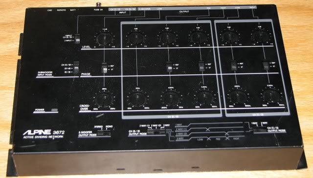

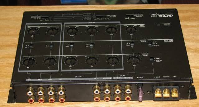

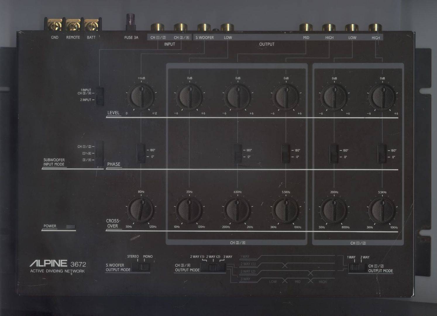

i've used the Alpine 3672 - a very flexible crossover:
6 outputs: 3-way front (band pass midbass, bandpass midrange, highpass tweeter)
4 outputs: 2-way rear (bandpass woofer, highpass tweeter)
2 outputs: sub lpf
high res image:
I don't know of any companies that put out a similar product to the FRX-456 today....however the PPI products of that era were quite well built. I wouldn't hesitate to pick up a nice used one. Odds are slim that you'll be finding a 'new' one.
