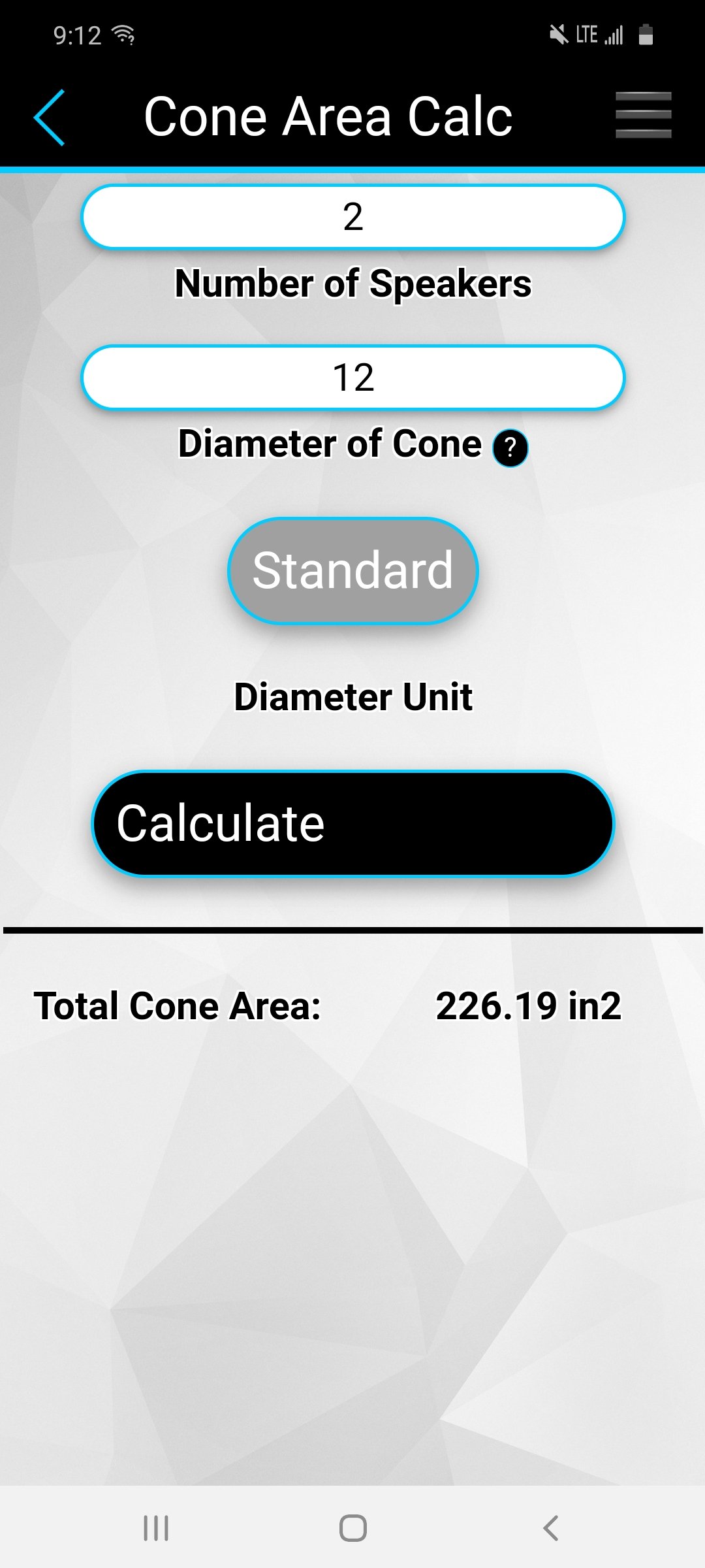

24” Of cone space vs 15”
That's not how area of a circle works.

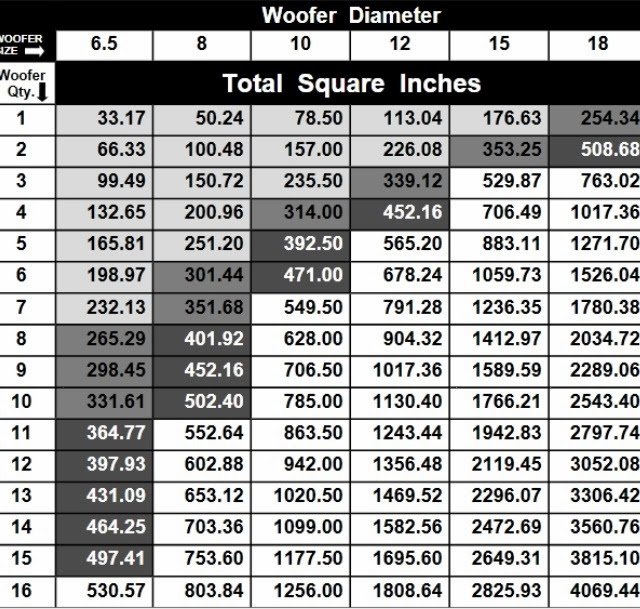

Really dude It’s still more cone space, sorry next time I’ll do pie r squared calcs since the op probably cares about that
Boop
