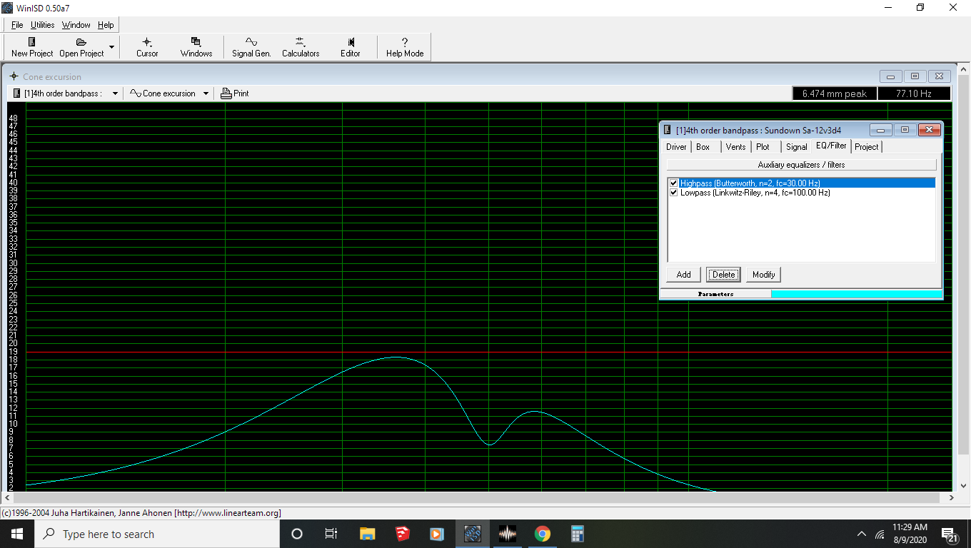

3 sa12 in 4th order
So the 3:1 ratio would be good and the size of both the sealed and ported would be good?
Looks good to me if you set your filters somewhere around where I've got em on music.
on burps where it'll be a frequency near tuning... just pour on the power

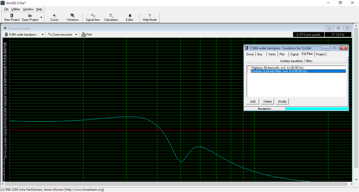

What's the graph showing? I downloaded the software but dont know what all the numbers are on the left. I also dont have the parameters for the sundown subs
Last 2 graphs are estimated excursion with and without filters applied.
That 130in2 of port 6" long looks about right to be a burp monster btw.
Good luck!
