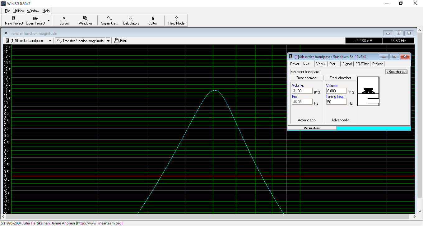

Im thinking of making it an aero port. The way the box will be made ill need to throw the subs on the side instead of the traditional back of the box to have more room for a deeper port because i wasnt calculating the displacement of the actual port would make inside the box is big. I only have like 6 inch max of space between the box and the rear of my back seats. After calculating my sealed will be 3.1 and my ported side will be 8.8 after displacement so ill need around 90-110 of port area using aero? Using a single 12 aero has 113 port area.

3.1 sealed/8.8ft3 vented ad?.. jeez... thats pretty big for 3 10's in a 4th I'd think
not all the times. I've heard 3 to one ratio 4ths with usable bandwidth from 20hz to 55hz
I think this one will peak hard.
That peak ought to overpower those lows for sure, it sounds like its what he's shooting for

There are lots of different programs. Winisd gives you the basics
