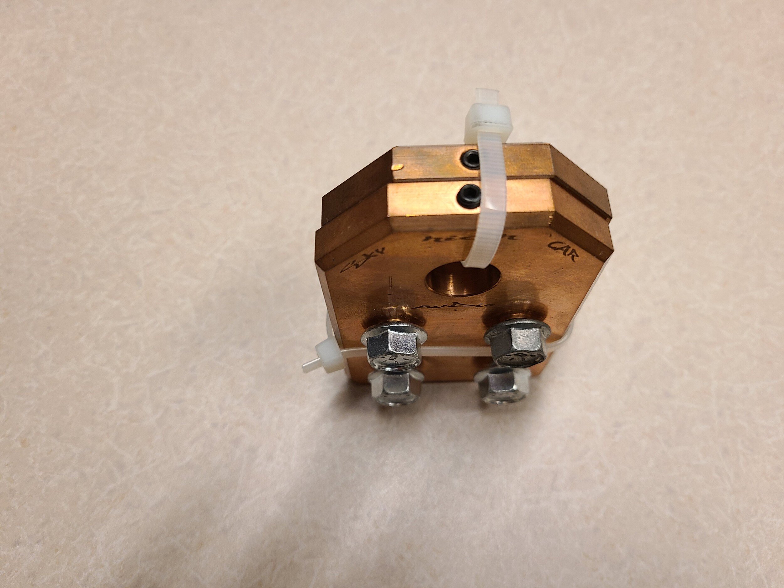

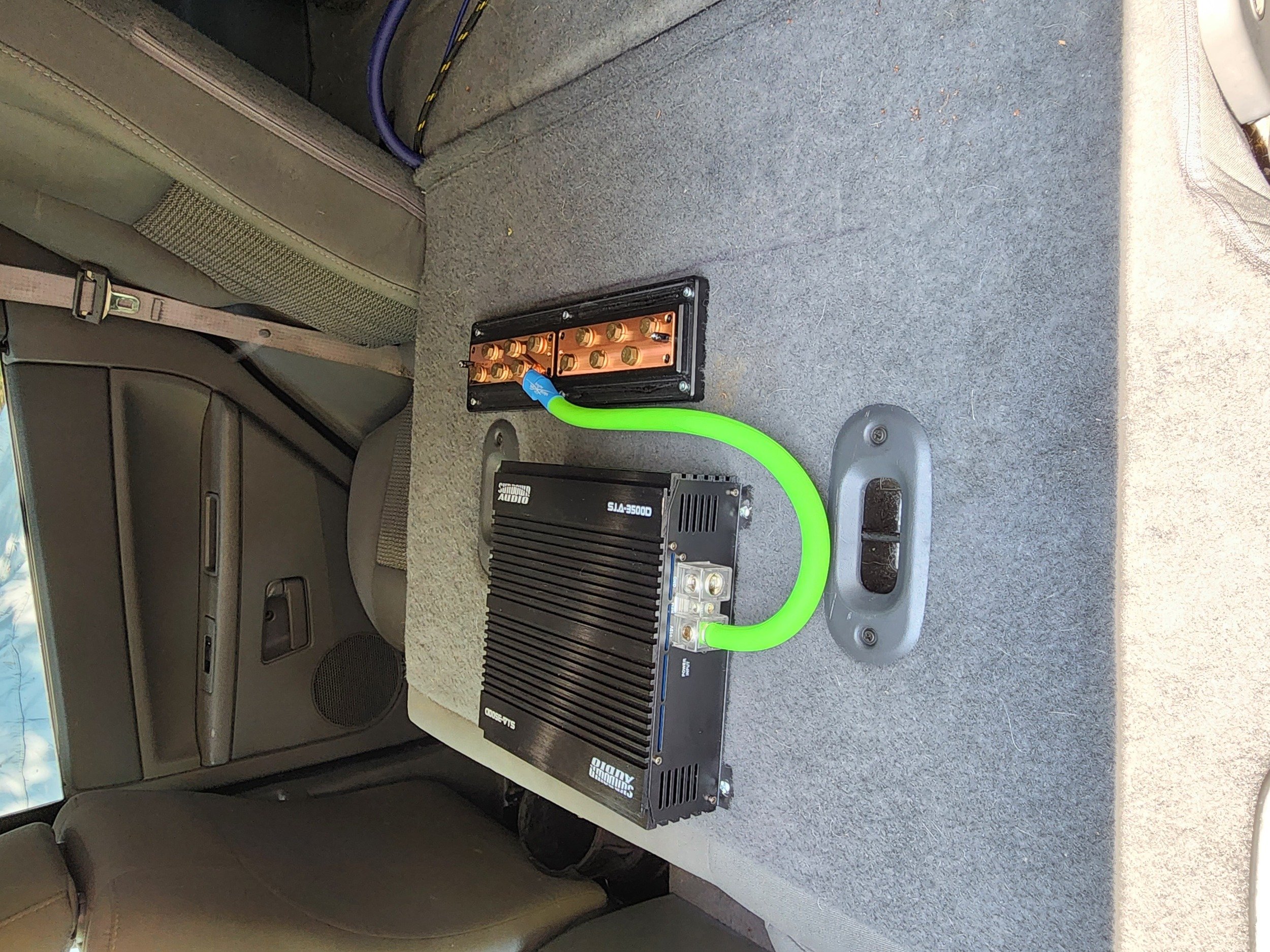

I have a 370 amp alt with the big 3 done and all my wiring is going back to a copper distribution block if you wanna call it that. Right now it just has my amp for my subs hooked up but im planning to attach the 4 channel for my other speakers shortly. My question is about a second battery can I just run that into the copper distribution block anywhere or does the second battery have to be ran before that with the main run of power wire going into the second battery and then wire the battery into the distribution block? I'll attach a picture of the copper distribution block just for visual help since I'm sure this was hard to understand.

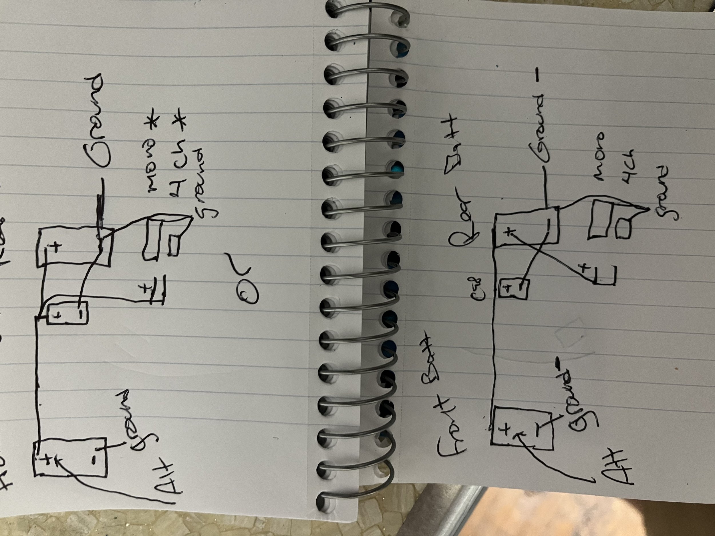

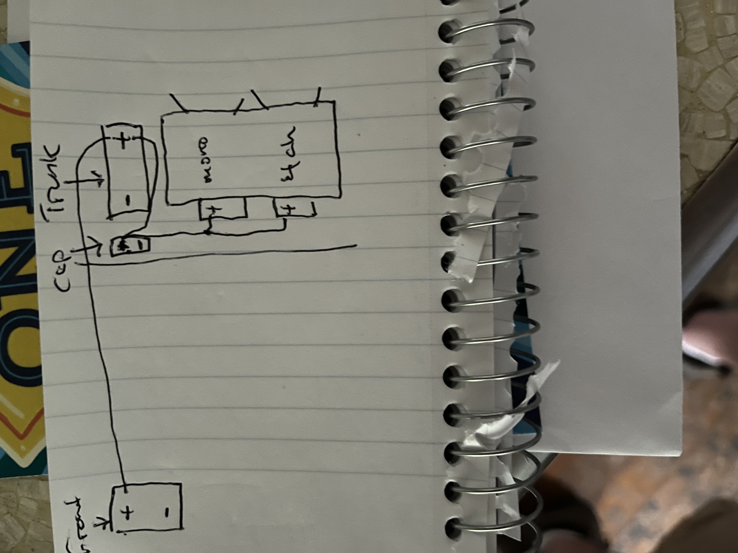

In my uneducated opinion the power would go both ways through a single positive. Maybe this is ok? Idk. I had no problems before or after changing the wiring.
the last pic is how i redid it. The first one is how it was. The capacitor was the connection point until the second fused distribution block which reduces the power from 0 to 2 4ga for the amps.
I fused the second battery positive too.

The way you would like to wire it will work absolutely fine.

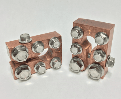

It's a basic parallel circuit. As long as all your positives are connected and all your negatives are connected, you can wire it however you want. I personally would pick up battery terminals like spokey linked and use them instead of your copper terminal blocks, but that's just a personal preference. If you go that route, I recommend ILL Customz terminals over Sky High. I own both, and the big difference is Sky High uses set screws to hold them onto lugs, whereas ILL clamps onto the lugs.
