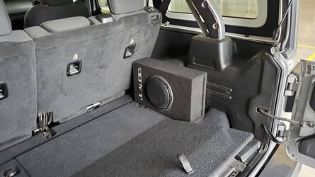

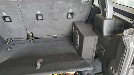

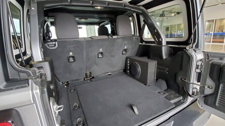

I dont want to move it to the rear due to the floor hatch that I open quite often to get stuff stored in there.  Here are pics of the setup where I have it screwed to a 2×6 wood board under the carpet on the side with port facing the 2nd seat.  The board is attached to the side of the jeep via 3 sheetmetal screws.  The port isnt covered up bc the seatback is angled.  Recommendations?

the location is fine, however you want to flip the box around till the port fires the rear.  You'll have zero low end with the port firing the front. take off the sheet metal screws and fire the port to the rear.  Port always needs to fire at a loading wall for any kind of low end performance.   You are in the least optimal position with the port firing forward.

I did it like that so the wiring could be hidden...if I flip it around the port and wiring will be exposed.  I wish there was a way to move the port or wiring.

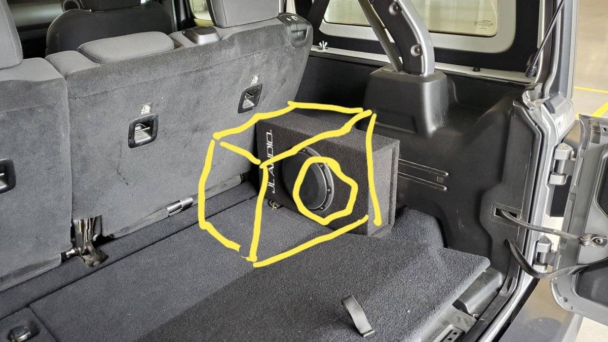

I measured and I could build a box with external dimensions 11.5" wide × 11.5 length  × 9" deep.  Is this big enough for a 10" sub?
no because your port is still not firing to the rear. thats the absolute most important thing ive been trying to say all this time... if you can build a box, you can build a beauty panel....
My fault...to clarify, I was referring to buying similiar to your recommended box(slightly smaller width for a 10" dayton HO) that has the angled rear portion up against the seatback and making it rear facing in the corner.
for a sealed box as long as the sub is firing to the rear you'll be fine.  Side firing inwards like your current JL sub less optimal and any other firing positioning will just render the sealed sub setup almost useless.
