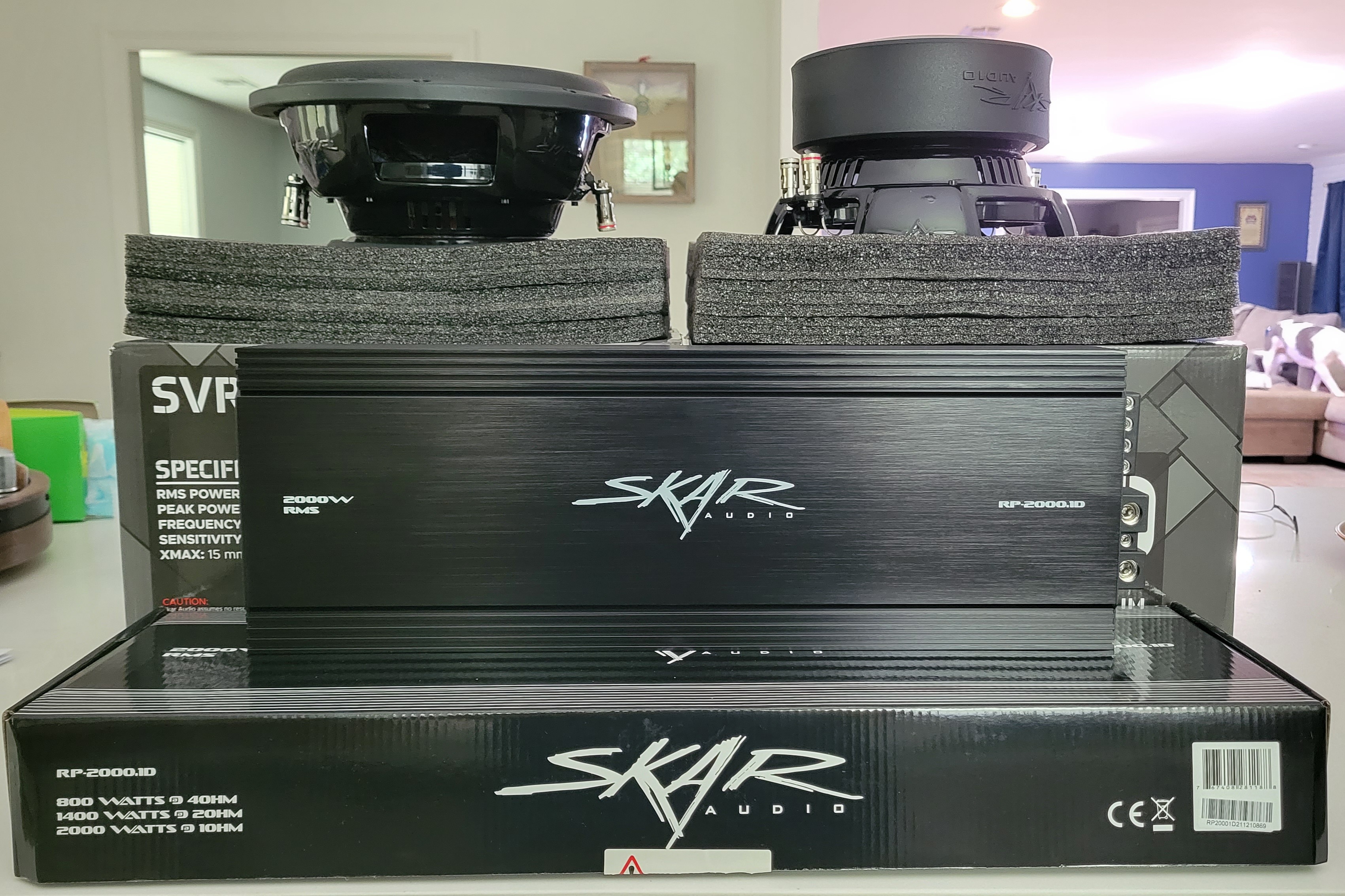

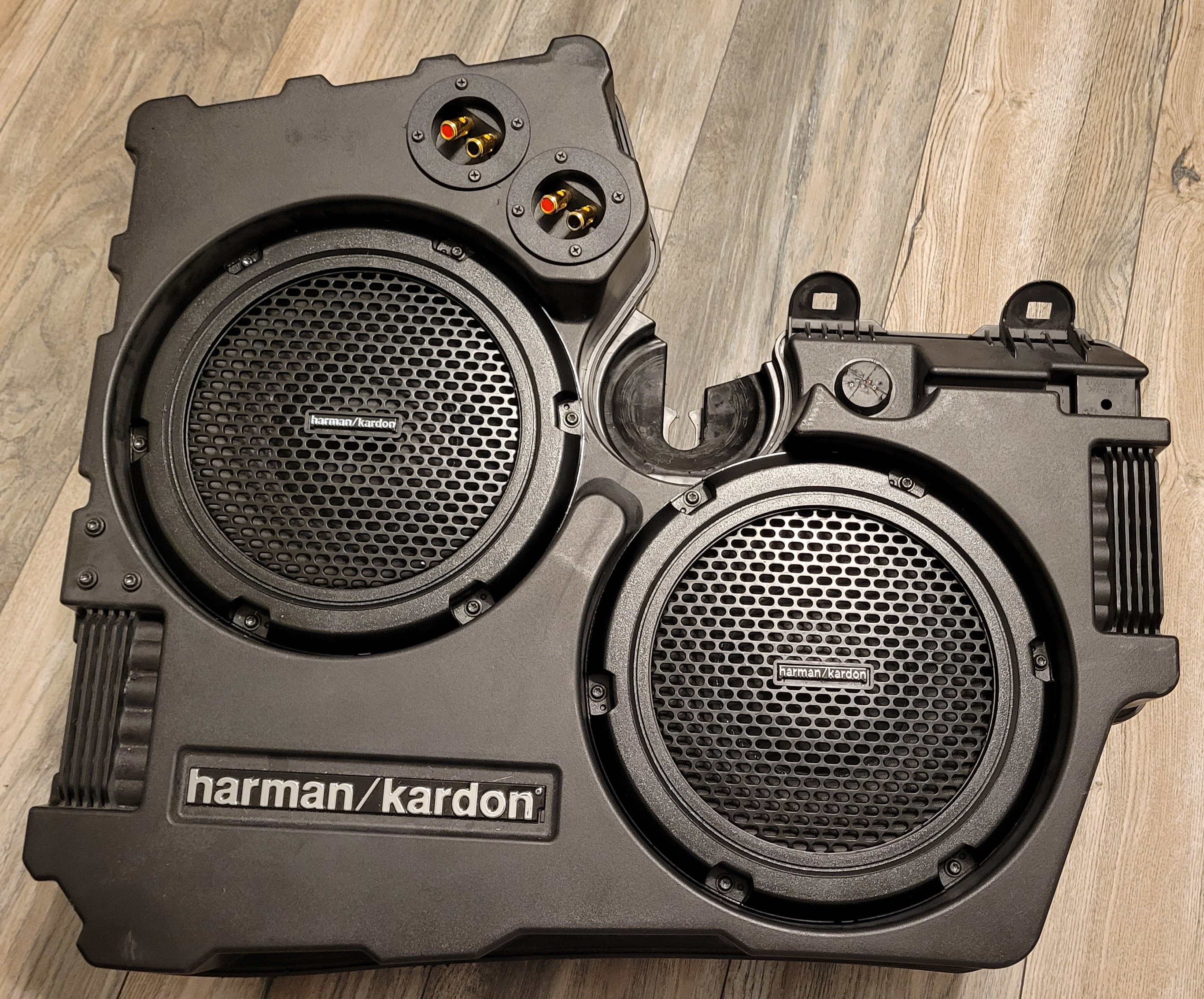

So...for the build. I found a challenger harmon kardon woofer setup for CHEAP. Its made to have 2-10s in the spare area. Chargers just have a styrofoam storage bin.
I bought subs to drop in, as well as an amp...should have measured. Skar SVR 10s arent even close to fitting. LMAO. I'll change to a trunk box in a few months.
I rewired the subs. they are 4ohm dvc but oddly only 3 coils were wired. Added about 20 oz of polyfill too. Wired subs parallel for 2 ohms at the terminal. I'm thinking of a Taramps TL-500 for these. We will see. Not sure what to replace dash, doors, and deck speakers with. The stock HK sounds good, to me. But I do want a lil more volume. Was thinking JBL (Harman, duh) or something else, that wont need an external amp.
