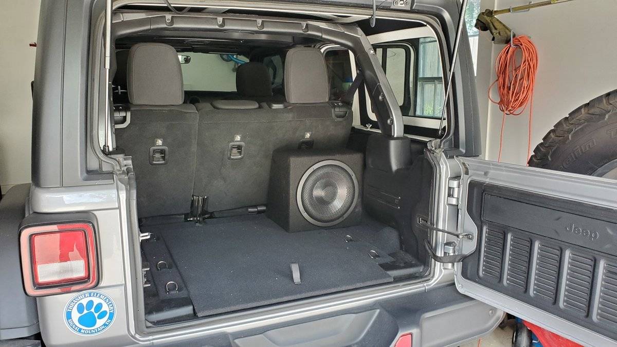

Here are pics of the finished product...It weighs 40lbs and I industrial strength velcro'd it on the bottom and side carpet and anchored it to the back seat mount with a 750 lb rated steel cable and (2) 1/8" eye bolts in the box rated at 300lbs ea.  The eye bolts are stronger than they look...should keep it pretty secure.

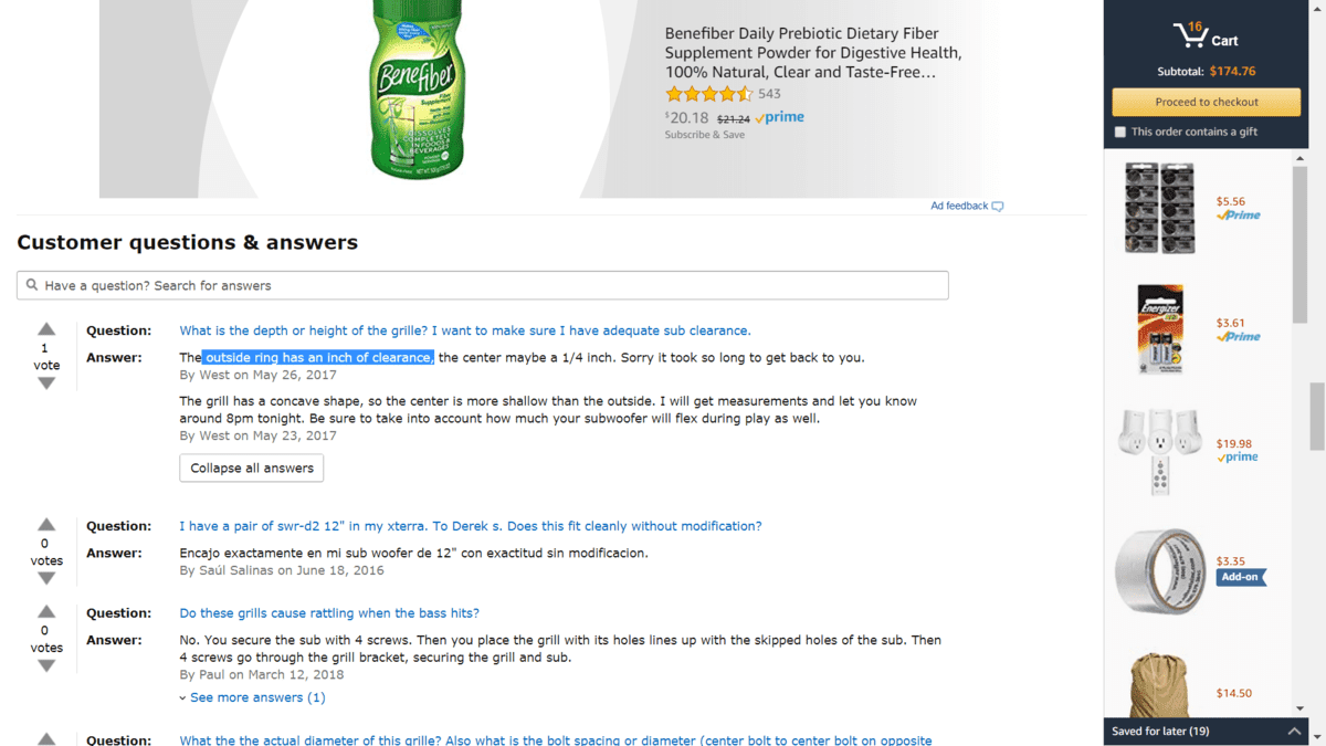

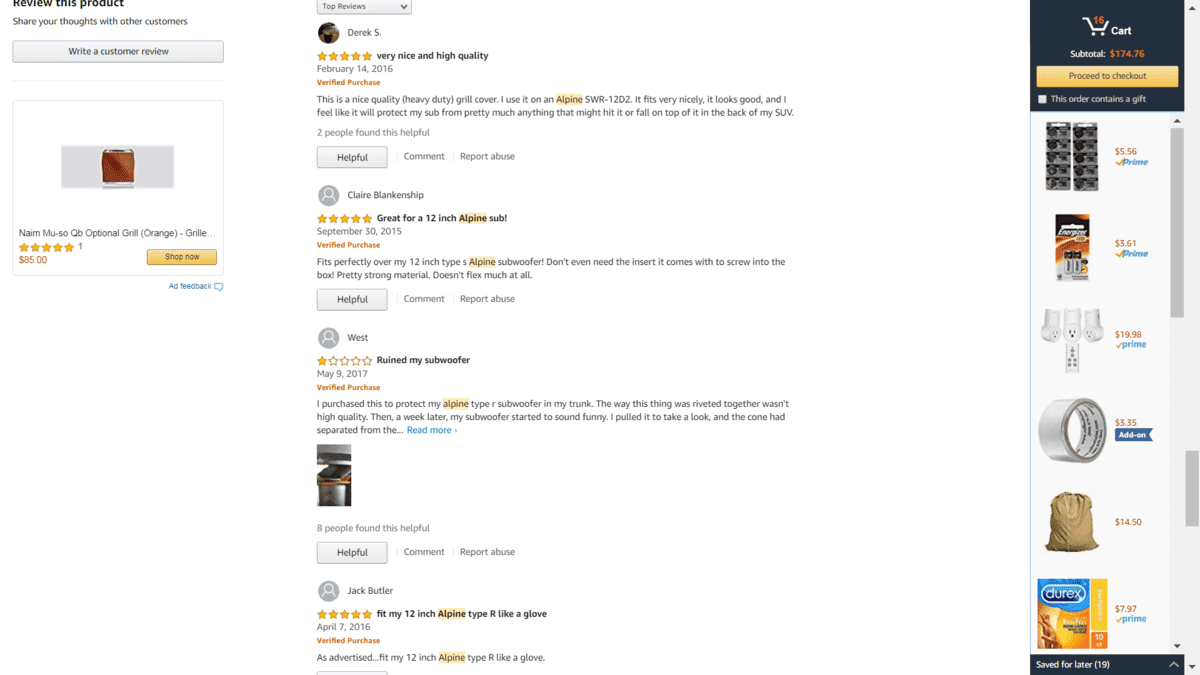

Been enjoying my sub...the sub is flexing well amd starting to hit the grill when it hits decently hard. Do you have a little deeper grill that you can recommend?
I saw that exact review and alpine was literally trying to get out of warrantying the sub for him and gave him BS excuses. Its not because of the grill, its because the glue failed at the triple joint where the spider and coil connects. Thats not something rubbing the surround against the grill would do at all, the most the rub would do is scratch the foam surround, not launch the whole coil through the spider which is from using way too big of a box while playing way too low of a bass note along with heavy clipping or maxed out gain settings. Literally pure user error. There's other reviews that said it works fine with their dayton sub. There's also this other reviews of two others with alpine type Rs as well and he had no issues. So that review you read is literally a noob that fked up his sub by abusing it and is pissed off that no one is warrantying his f**k up which is not covered by warranty.
View attachment 5756View attachment 5757
FYI...I checked the screws and everything is holding fine....this grill doesnt allow full excursion. I wouldn't recommend it for this Dayton sub
