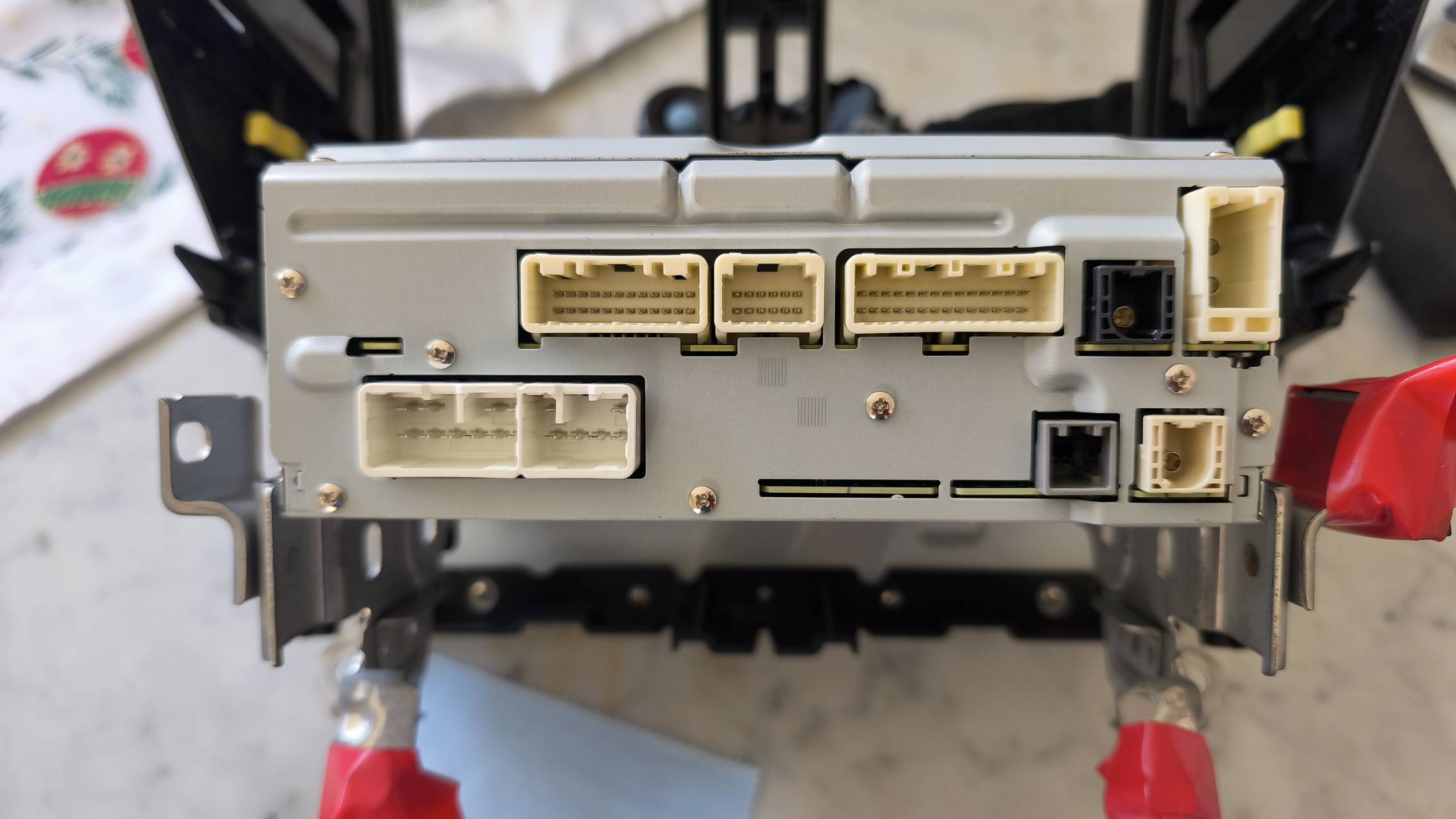

I have attached a photo of the factory unit sockets.

It's not uncommon for modern-ish HUs to have a single set of signal outputs, with a separate channel controller fed to a factory amp with integrated DSP.
The factory sets the EQ and time alignment, and then the controller lets you control fade/balance, etc., should you feel the need.
This makes integrating any aftermarket equipment difficult, as you gain something in one place and lose it elsewhere.
It's also the reason I do not integrate OEM amplifiers (and some OEM HUs), it's just not worth the frustration and ultimately the rabbit hole that leads to "new everything" or "nothing at all", at considerable cost in the end.
It's one of the reasons that I recommend you go all in or just add a subwoofer for most that ask, as this is often where the OEM systems are lacking the most.
