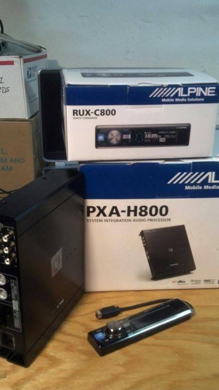

how do you like/compare the H800 to the H701? i like the smaller controller in the C800.
Yeah, that's what I picked up- a w505. I'm told it will control it, just not sure if you can do all of the dsp tuning functions of it through the w505. If so, then I wouldnt nedd a controller which would be great.
I really like the H800/C800 combo. Really easy to use, great display on the RUX.

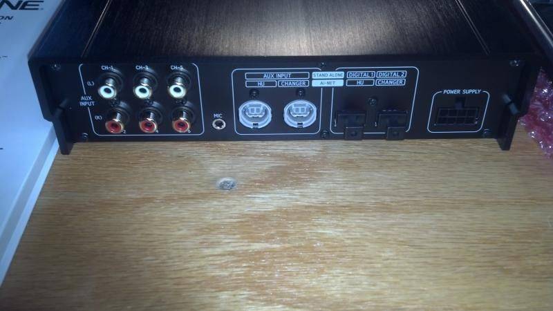

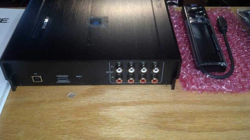

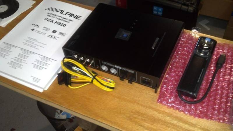

i spent some time playing with the H800. Programming required the unit not only have power but you had to "cycle ACC" or turn ignition on and off to move past various stages of programming. on my test bench, i had a way to do that thanks to consistency with how all of the devices were wired. I programmed with the laptop after upgrading the software version to match the head unit i will be using.

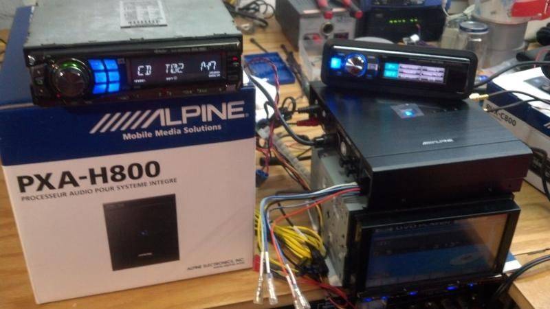

my first test was how to use AUX inputs. I have the Alpine DVA-9861 wired with Ai-Net and fiber optic. that's the SQ source. But I also want to wire the factory head unit in. The Alpine IVA-W200 pictured is acting like my factory head unit. I'm going to play with that for a while on the test bench since it's -30 with wind chill today and generally cold for the next few weeks. The inputs are very flexible. There are 6 inputs and they are paired. any of the three pairs can be high level or low level inputs. and you can set up the system for 4ch + 2ch or three different 2ch inputs. The head unit only sends two channels through Ai-Net or fiber optic.
I did get a configuration to work, one that allowed the 9861 to select AUX on the H800 so i could change between the two sources. That's pretty much what I want but there may be another idea.
