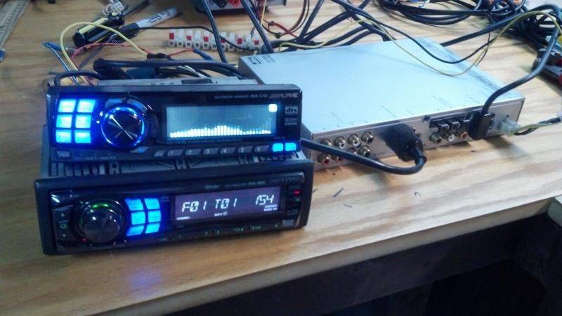

...to sell me that H701/C701 ? //content.invisioncic.com/y282845/emoticons/smile.gif.1ebc41e1811405b213edfc4622c41e27.gif I actually have an H701, but need a RUX. If you come across one, please let me know. Of course I could always buy a complete combo and then sell my H701 as well.
I currently run the H800/C800 in my car and the H701 will go in the wife's car. The alpine's are very nice.
my DVA-9861 will control the H701, as will several other Alpine HU's, so that is one option. Get her a W505 or something.
how do you like/compare the H800 to the H701? i like the smaller controller in the C800.
