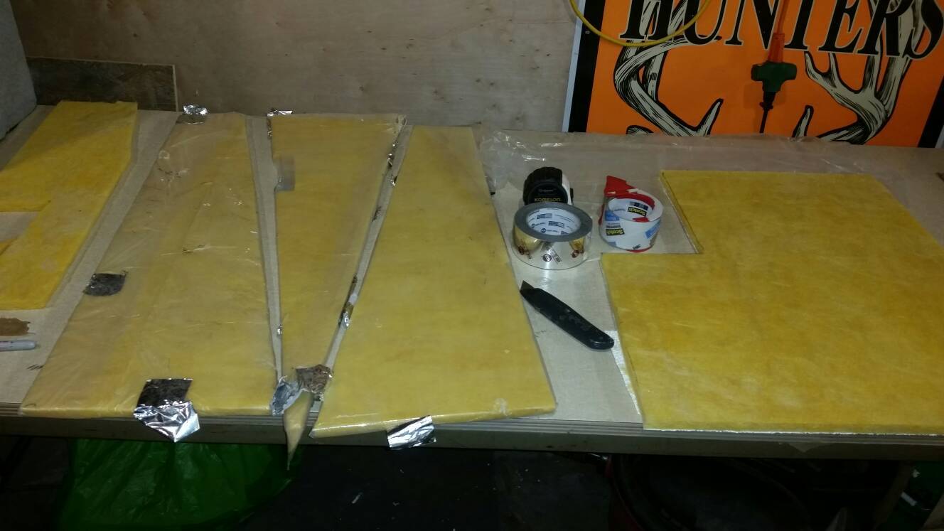

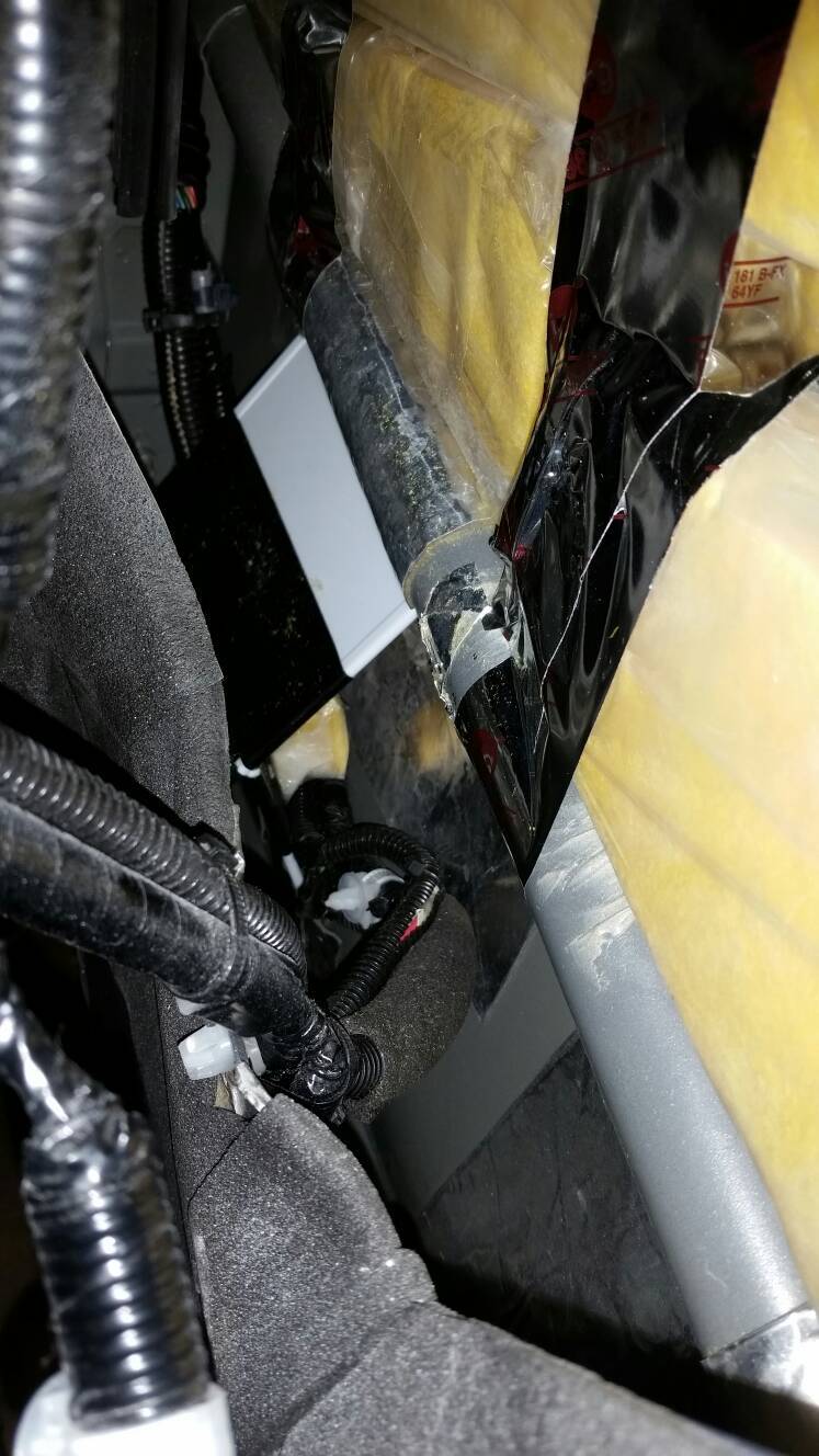

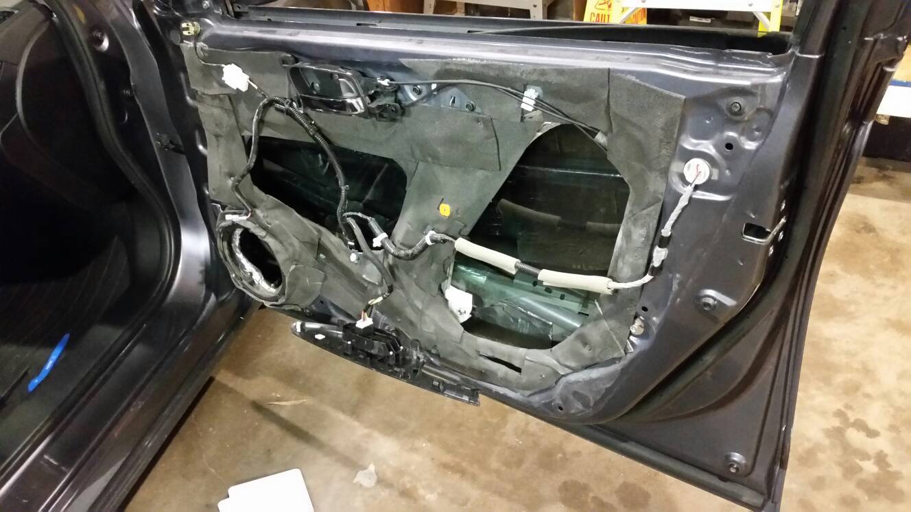

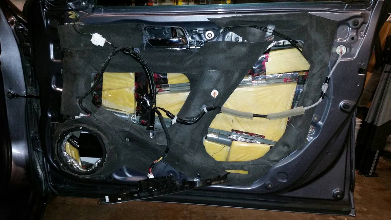

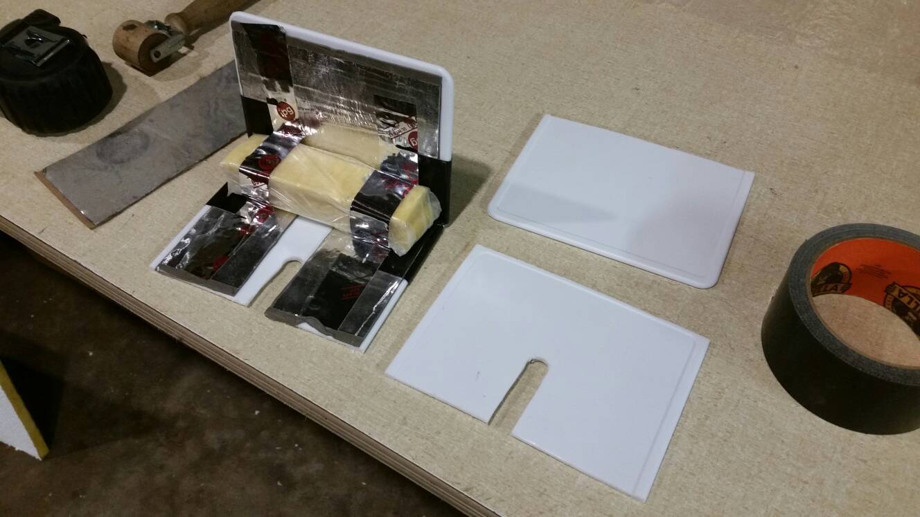

Rebuilding the doors. This time I am greatly increasing the sound absorption used.

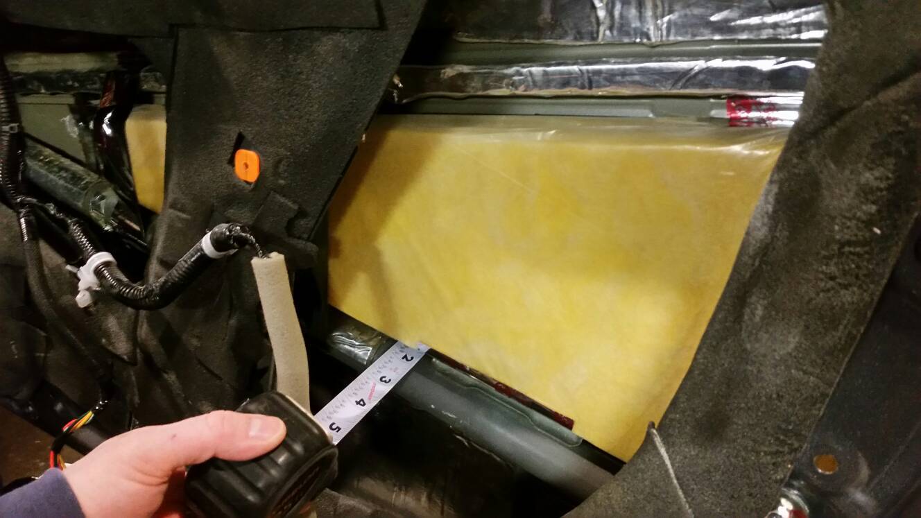

Old fiberglass panels show no moisture issues after 2.5 years.

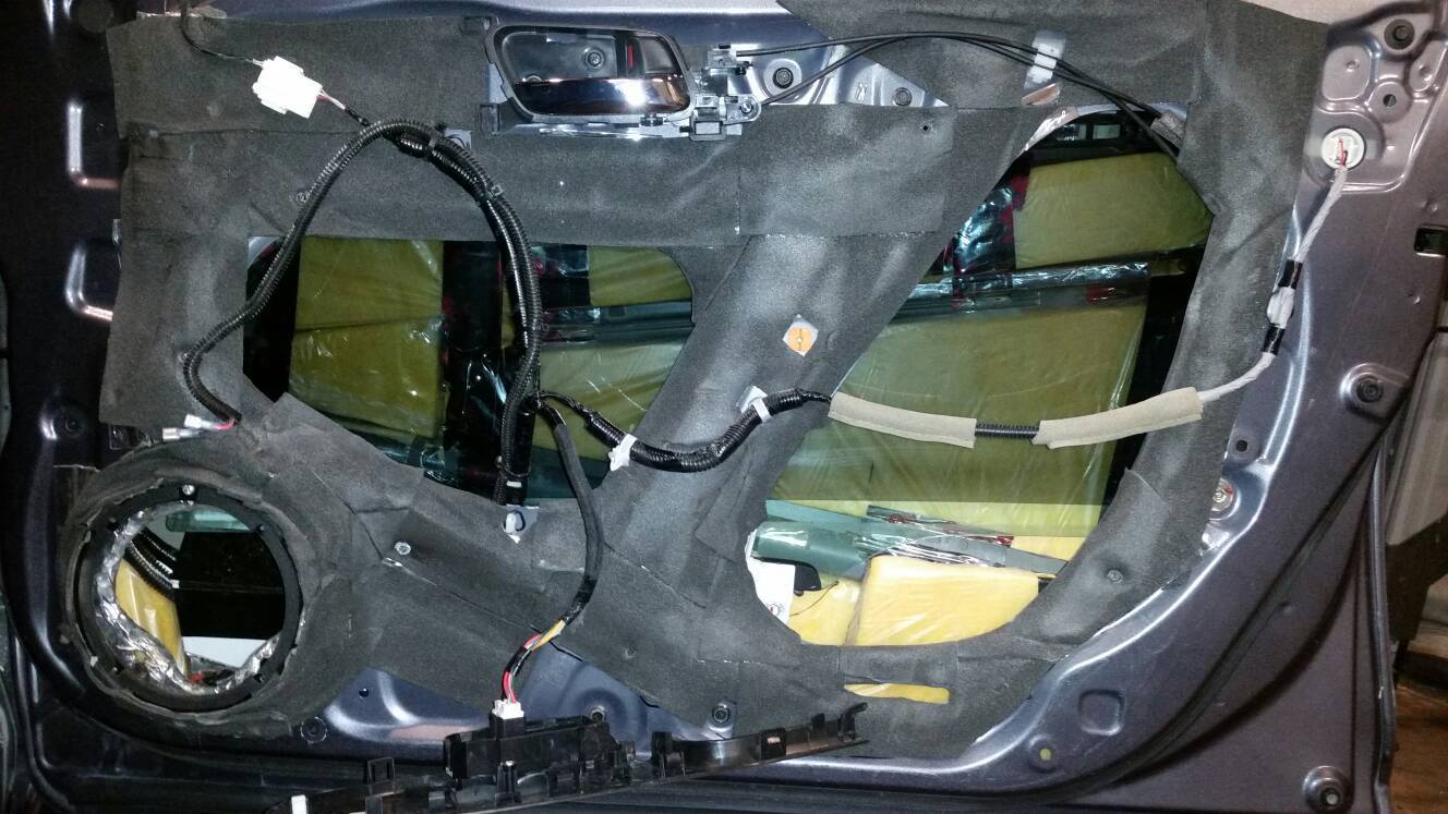

New install increases thickness

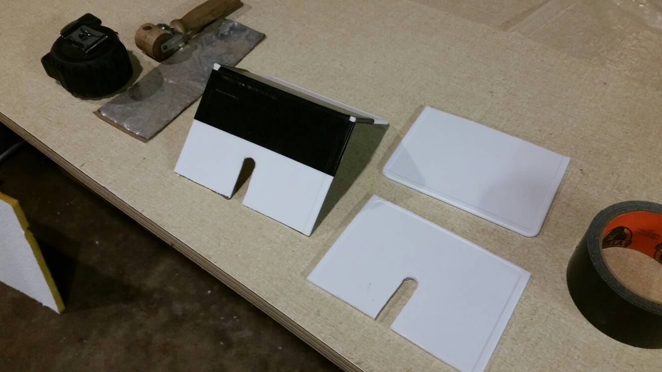

Adding a proper diffuser behind the speaker
Window clears
Sent from my SM-G900V using Tapatalk
Breaks up the rear wave from being directly reflected back to the cone, effectiveness is based on physical size due to relationship to wavelength
Thanks, that makes sense!
I like that. I used the FAST rings on my doors. Whats the material?

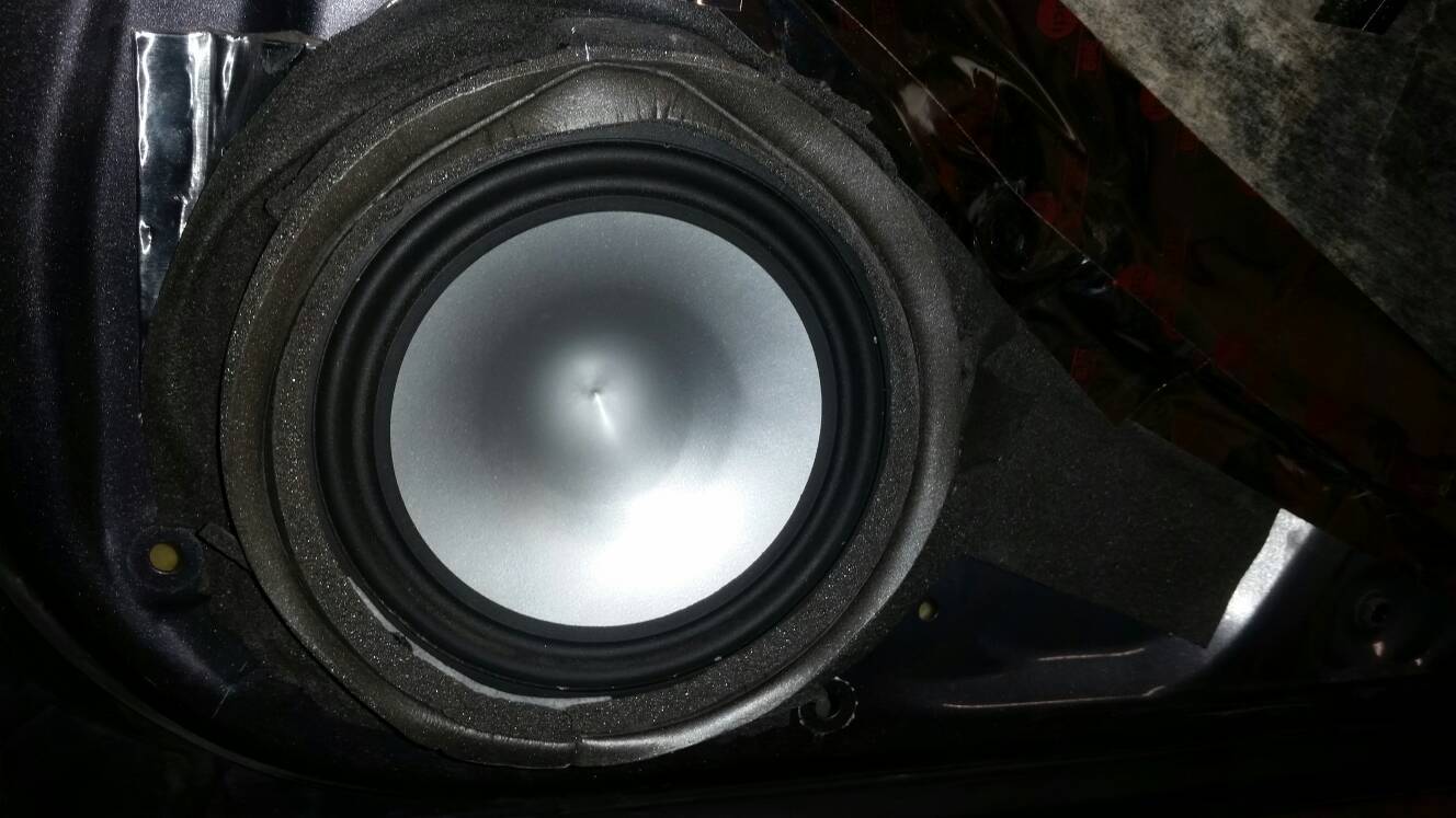

Closed cell foam weatherstripping is used for gaskets around the speaker and is $3 for 10'. The fiberglass ceiling tiles are $6 each for 2'x4'.
FAST rings don't offer much for sound absorption despite product claims. I have some I've tested with.
You know that you have gotten your speaker gasketing correct when you see a continuous circular imprint in the foam. That imprint is made by the plastic shroud that seals against the factory speaker.
