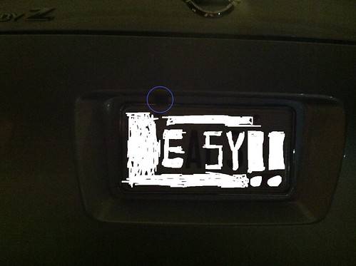

Put the Reverse Camera on the Driver side -- It's super "stealth" ... I like it, really no need for brighter tag lights, but I have them on the way anyways.
Then here's the image from the $24 Camera -- (Keep in mind it's at night)
Only thing I really noticed was it doesn't have any numbers.. But it's very accurate and super center from the start. Personally I don't "need" the numbers whether they are in Meters, Feet, etc..
I did test the "zones" Red, Yellow and Green. When I get up the "red" edge.. I got out and looked and I have about 5-6 inches till I am about to hit what is showing on that Red edge,.. I like a little room for error.

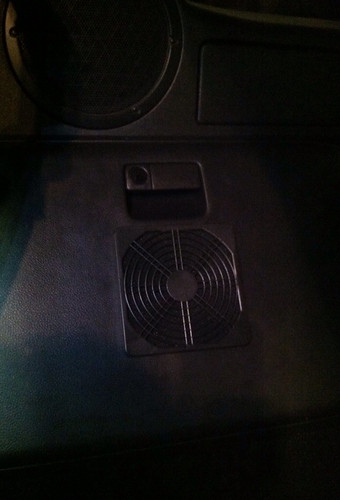

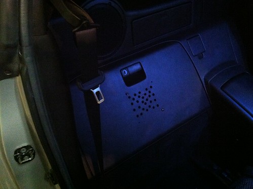

Intake Holes (Not perfection here.. but not finished):

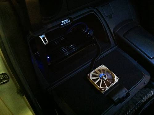

Fan Wired via Relay - mounted on spacers Pulling Cabin Air:
The holes aren't perfect,.. but I am not finished with it. I am going to get a vent and essentially cut a box out from the edge of the outer holes,.. and then place a vent so the outside looks better, and the airflow should be a bit better as well.
Cleaned up the Fabrication work -- It's finito now.
