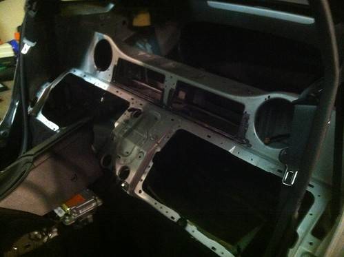

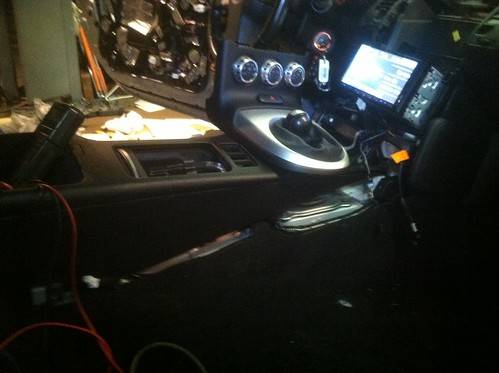

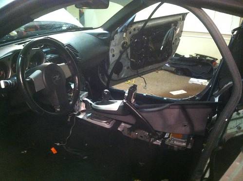

Car interior stripped 90%:

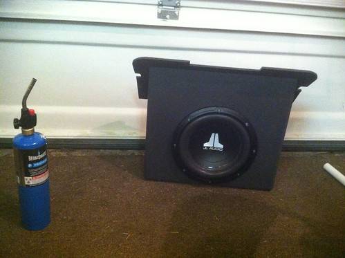

JL 10" sub wired, and mounted into Custom Box:

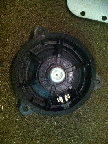

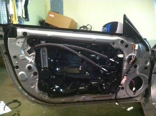

Factory Mids pulled out (Wow, these are terrible!) -- Had to cut them out of their spacer to reuse it with the new Components I bought.

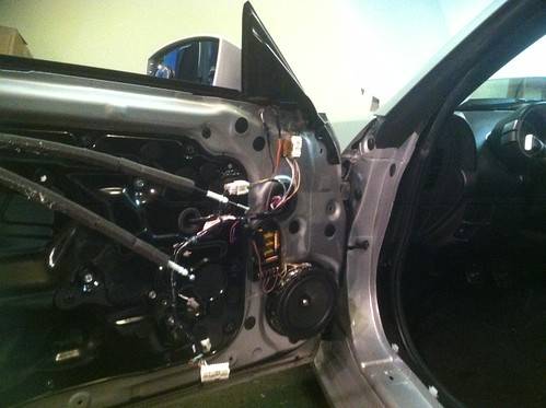

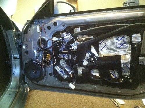

New JBL Components successfully in factory spacers (one heck of a job fabricating those spacers to put these JBL mids!) -- And put the 1" tweeter in stock location (had to cut/fab behind that sail panel quite a bit to get them to fit.. but they fit perfect)

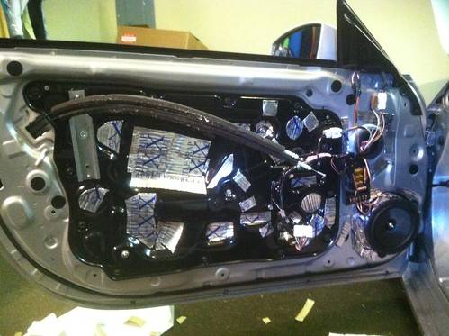

Used Rattle Trap Extreme to deaden doors -- Am running out of deadener, and the doors were A LOT better sealed by factory than I anticipated.
If you have some recommendations of where else to put the deadener on these doors let me know.. I have a little left.

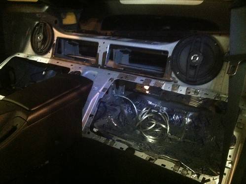

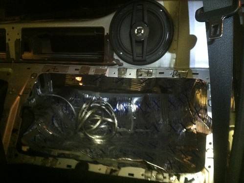

Slot where the Custom stealth box is going,.. Used a ton of sound deadener in this spot.. picture just shows bottom, but it's done up top, sides , etc. Plus there is a 1" rubber mat that is on top of this material, not shown in pic.
(Continued in next post).........................

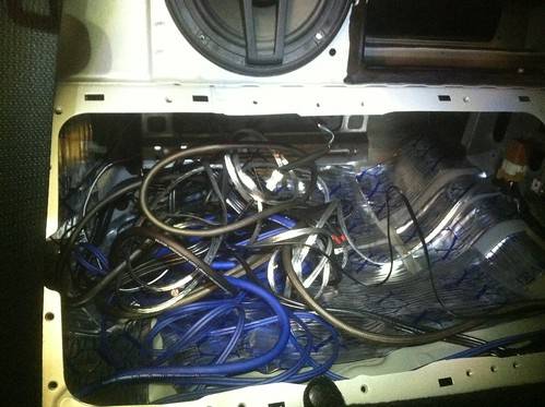

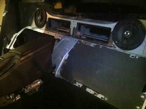

Rear 6.5" (Late 90's German) MB Quarts installed with X-overs. [i used 5+ sq ft. of sound deadener just up in this area.. that stuff goes fast!]

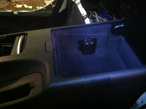

Yes,.. I opted to wire and install a Bass Knob. I KNOW many of you go against the notion of using one,.. but I plan on adjusting it on the fly quite often. So here it is mounted in a discreet "Invisible" location in the center console pop up box (top comes down and covers this). Used Industrial Velcro to mount it (worked fantastic!).. and dremeled below it for the phone cord to come through properly. I think it turned out pretty good:

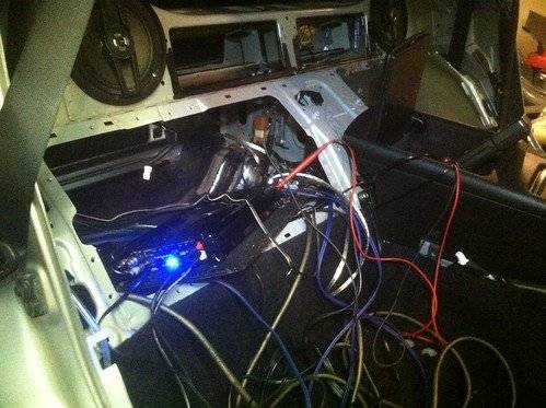

First I decided I should put more sound deadener in the car.. I deadened this entire area and bulk heads.. Plus other areas I didn't bother to take pictures of.
And.. it's ALIVE! -- Setting Gains!
And.. only other shot I took was of the headunit,.. as I tuned the system in after Gains were set properly.
Fired right up! Everything worked flawlessly.. I couldn't believe it //content.invisioncic.com/y282845/emoticons/smile.gif.1ebc41e1811405b213edfc4622c41e27.gif
It sounds phenomenal,.. way better than anticipated.
To get proper voltages for speakers,.. I ended up at 50% on gains for front,.. 50% on gains for rear.. and 60% on gain for Sub. Not too bad.
