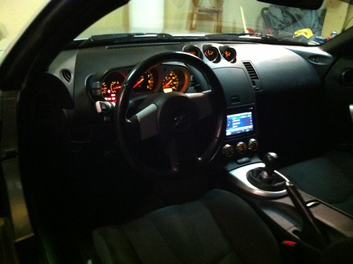

Finished! -- Went and bought the Kenwood DDX470 and BestBuy couldn't install today.. So I just brought it home and installed it.

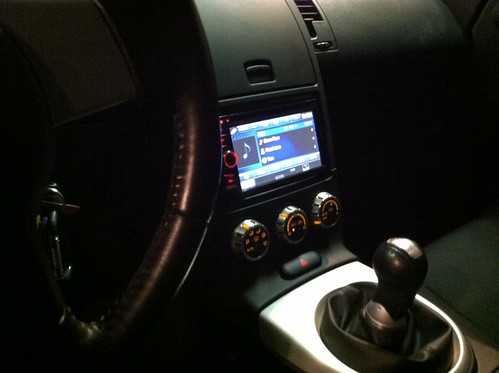

Here she is done:
I really like this headunit.. It has more features for Audio.. Built in Front, Rear, and Sub crossovers active -- Very handy.
I love the actual volume knob, attenuate button,.. Phone button etc.. Where I don't have to look away from the road. Still a 6.1" touchscreen and DVD player.. best of both worlds.
Bluetooth works excellent,.. It's new for me to have it in my vehicle, so it will get a lot of use.
There is a difference in this HU and the Pioneer one though.
To get the proper voltages when retuning the amp.. I had to bump the gains higher using this Headunit.. Despite it having 4V pre-outs as the Pioneer had.
Particularly the Sub channel.. Sub channel is probably 85% or so now to get it to the level needed. (That's at a 79hz tone.. at 40hz.. the voltage is WAY higher.)
The fronts/rears didn't need much of a bump.. about 10% compared to the Pioneer.
Sounds great though!
And.... she's done! My hands can heal.
Thanks for all your help.
