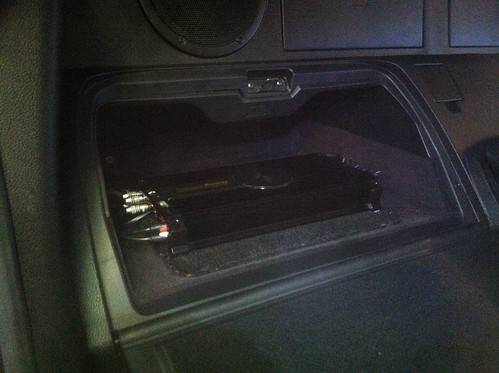

Fabricated an Amp "mount" from Plywood,.. carpeted it,.. put 1/4" spacers under it,.. and screwed amp into the Fabricated amp "rack" if you will. Have industrial velcro around the lip of the "hole" (where that little box goes, that comes out) inside the glove box.. and on bottom of plywood amp rack.. It holds amp in place VERY VERY well,.. And the upside is any adjustments to the amp are a snap.. I just pull up on it and it comes right off to adjust without removing any panels, screws etc. Plus the industrial velcro is so strong that amp isn't moving even if I slammed on my brakes. I like this solution, it's simple. (I'm going to add a carpeted piece on top of it later today to give me roughly half of my glove box space back, and to protect the amp if I put anything in there.

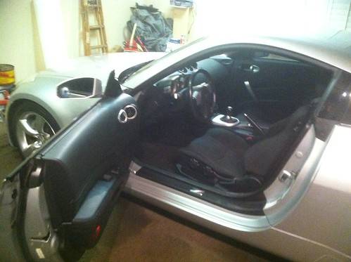

Also got half the car back together.. As you can see from this picture it's very much a "stealth" install.. not one thing shows this has high end speakers, a sub, amp etc..

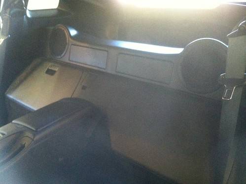

Here is the Amp on the rack I built, carpeted,.. and tidy'd up -- It's simple, but I think it looks great imho. (Under that amp is a HUGE square hole.. I didn't just screw the amp down to that.. I had to make that (First time doing something like this,.. What do you think?)

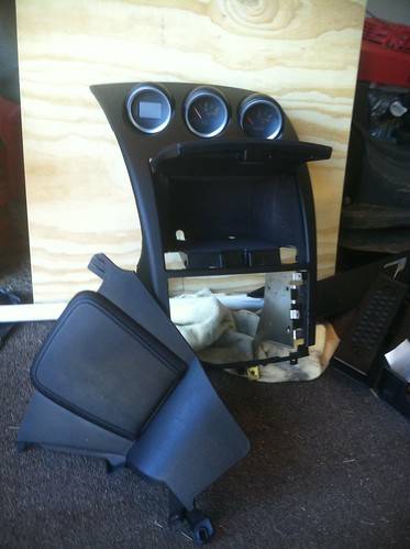

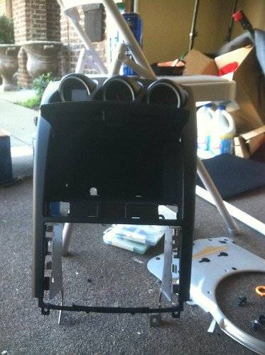

Here's the knee pad (next to the gauge cluster):
That Knee pad slides sideways into the whole unit there AND is bolted/screwed in. lol.. Don't know if you have these/this pad.
Here's a picture of my headunit and area as it sits at this moment:
Here is a picture of Gauge pod which is attached to that Double Din bracket I think you were referring to -- I tried to get a clear picture of all screw holes .. from the front at least.
Please Take a good look at those pics.. There are subtle differences even in the 350Z line, year by year in this area.

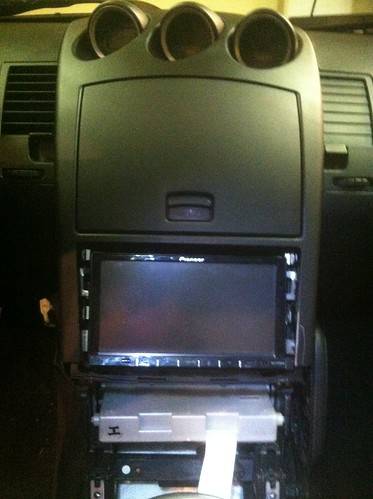

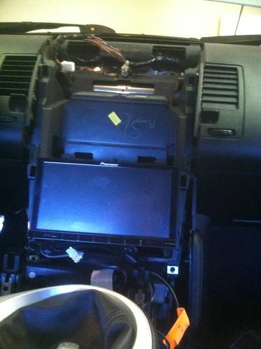

Got the car back together.. and FINALLY got the headunit in .. wow what a pain! But,.. of all things, the trim piece doesn't fit now! ??
I wrestled with it.. tried to adjust the headunit to make it more "level" , etc.. but it just wouldn't fit around it. Then after enough tries one of the clips on the trim piece broke.. So I just gave up. I ordered another trim piece that will be here Thurs,. but at this point I don't know what to do to get it to fit around there properly?
This is a picture of what it looks like and how it's positioned without the trim piece on it now:
I'm sure you guys know just the thing to make this thing pop right on there.

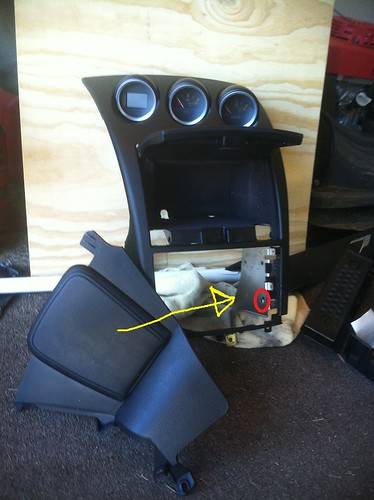

But.. essentially what it is.. Is an aftermarket, obviously,.. Pioneer AVH-P4100DVD doubledin headunit,.. and to mount these you take the side brackets off the factory doubledin radio and attach them to that hole gauge pod.
Here.. I quickly dropped some lines in paint to point it out:
The yellow arrow is pointing to the factory brackets.. see those LONG as.s legs on them ? Those were why it took me so long to figure out how to get that thing in there.. But that's not the issue now.
Now.. The red circle is the mounting holes.. two screws on each side that go into the headunit. It has the original factory holes.. and another set just beside them that whoever installed this head unit drilled to make it fit flush. Which , again, doesn't make sense to me.. because I used both sets of holes (more than once).. and it doesn't line up.. Well I'm guessing it's not lining up since the trim piece isn't fitting without gaps.
So basically it's the factory brackets.. with another set of holes drilled in it.. really simple set up (pain the butt to put back in due to how long those bracket bottom bolt legs/holes are.. you have to angle it down there where those legs go behind the very back of the bottom of the console area.. WHILE you have the top of the gauge pod hooked up and locked into the dash up top... Not a GOOD design at all. The brackets are attached to the gauge pod from the BACK.. so I couldn't remove the brackets then put them back on to make it easier.. as once you have them IN place.. you cannot possibly get BEHIND the brackets to put screws in them to mount them to the gauge pod console thingy..
But you see this picture of how the head unit currently is.. This is with it in the holes it was in when I disassembled it.. Should line up just fine right?
But it doesn't.. So need help on a freaking trim piece lol. At least I can put the seats back in and drive the car now //content.invisioncic.com/y282845/emoticons/smile.gif.1ebc41e1811405b213edfc4622c41e27.gif -- Still annoys me to have the headunit looking like that right now after all that work though,. //content.invisioncic.com/y282845/emoticons/frown.gif.a3531fa0534503350665a1e957861287.gif
