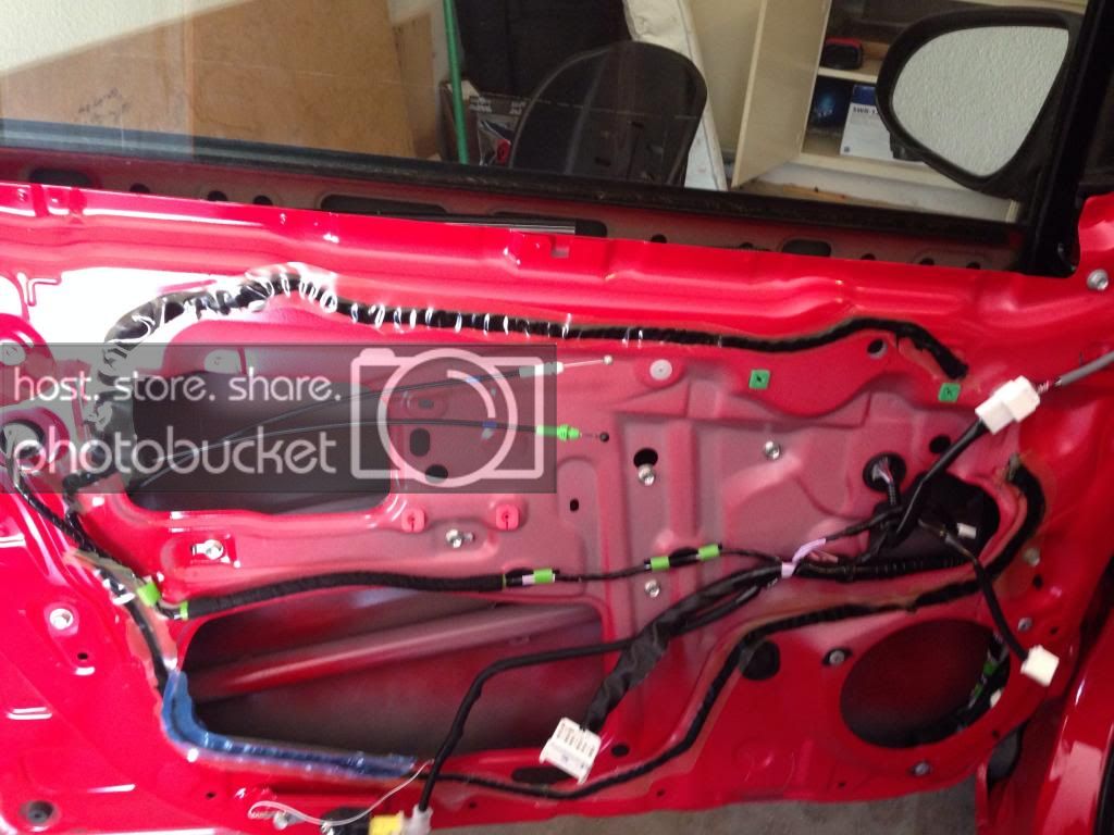

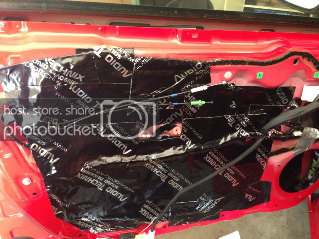

A LOT of sound deadener will be going into this little car. They come with nothing from the factory. So I have 80sq feet of AT 60 mil already and will be getting another 40 of the nvx 80 mil. Most everything will be done this coming week. I had a discectomy last week so I'm out of work for a while. Probably shouldn't be doing this but I'll be taking it easy. I'm going stir crazy already and this way I can completely tear the car down and do everything the right way all I one fell swoop.
And all done. I used duct tape to seal the hole up first and then applied the deadener over that.

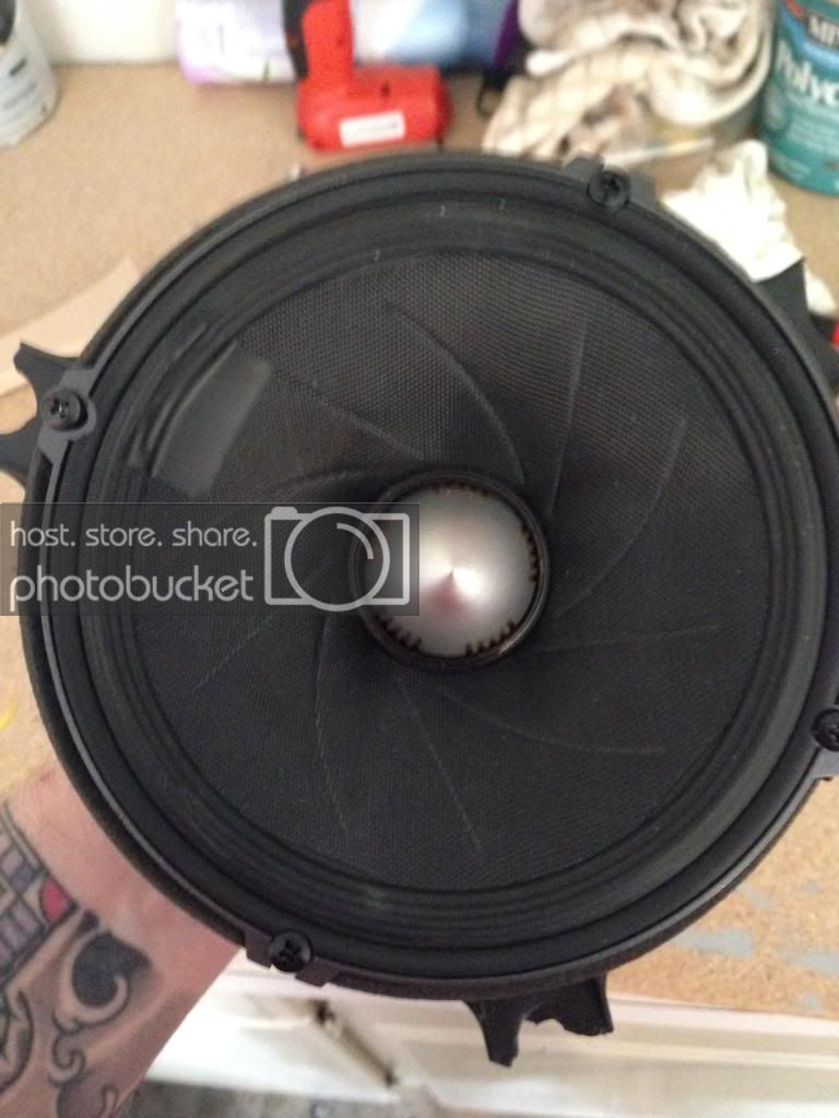

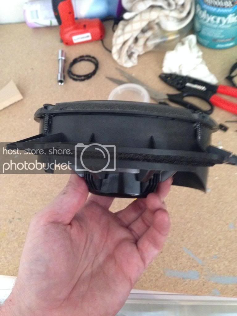

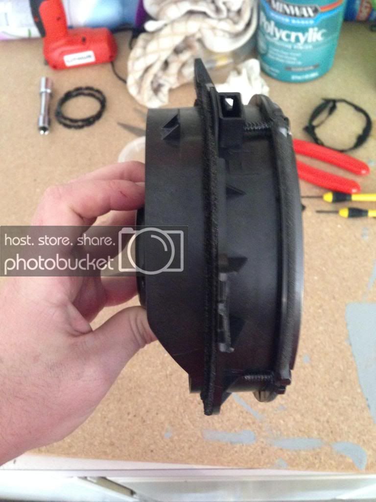

It work out perfect that I could take apart the stock speaker and use it for the new. It works perfect for 3 reasons
1. The speaker for perfectly inside of it and is sealed perfect to the "adapter"
2. With it having a neo motor it has a much more shallow depth so the water guard for the stock speaker also covers the new mid bass so I don't have to make anything myself.
3. The one good thing Toyota did was make the speaker actually seal to the door card behind the grill. So I don't have to worry about any sound waves or reverberations getting behind the door card. With the new speaker it also flushes against it perfect.

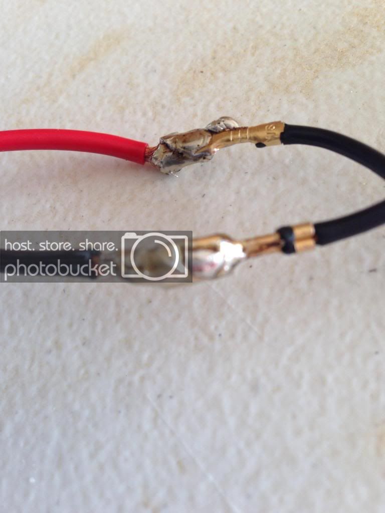

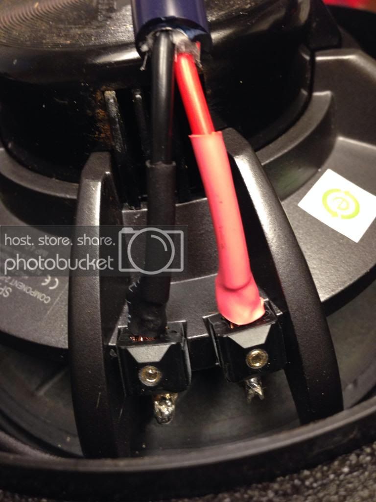

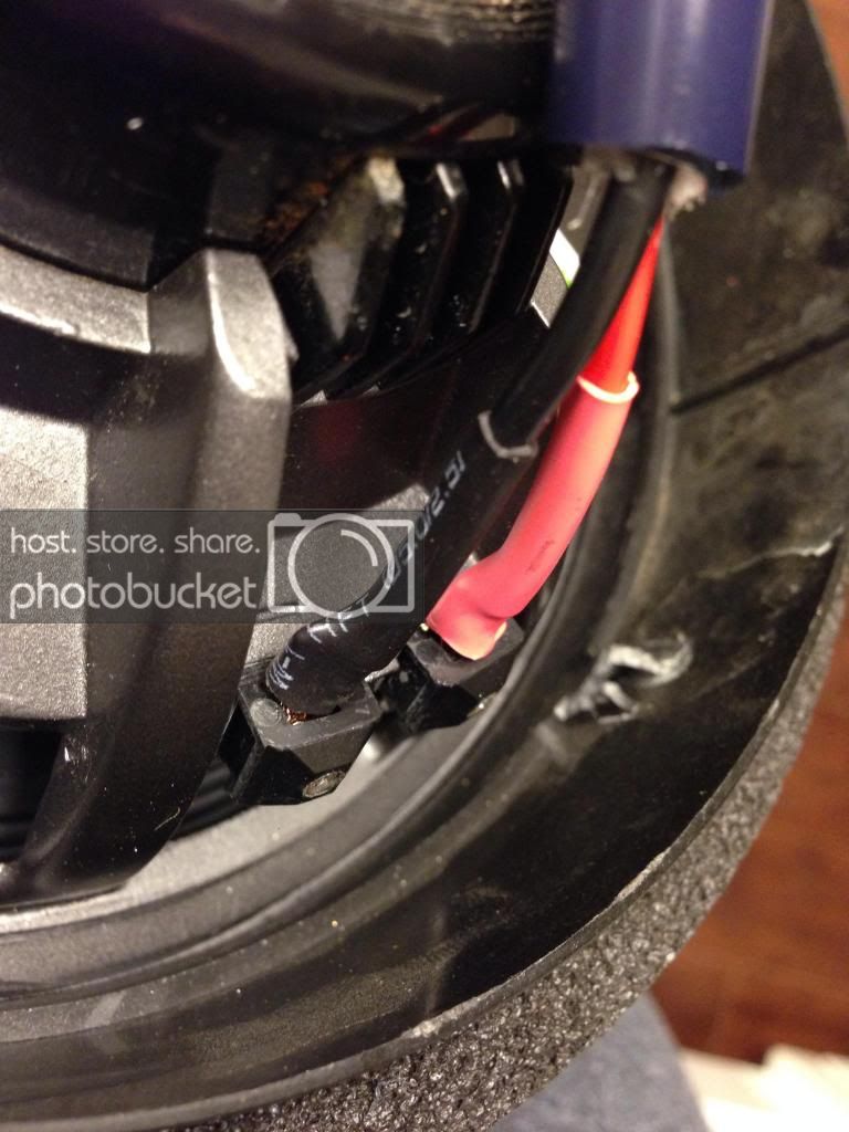

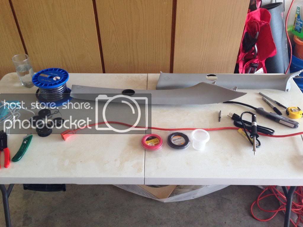

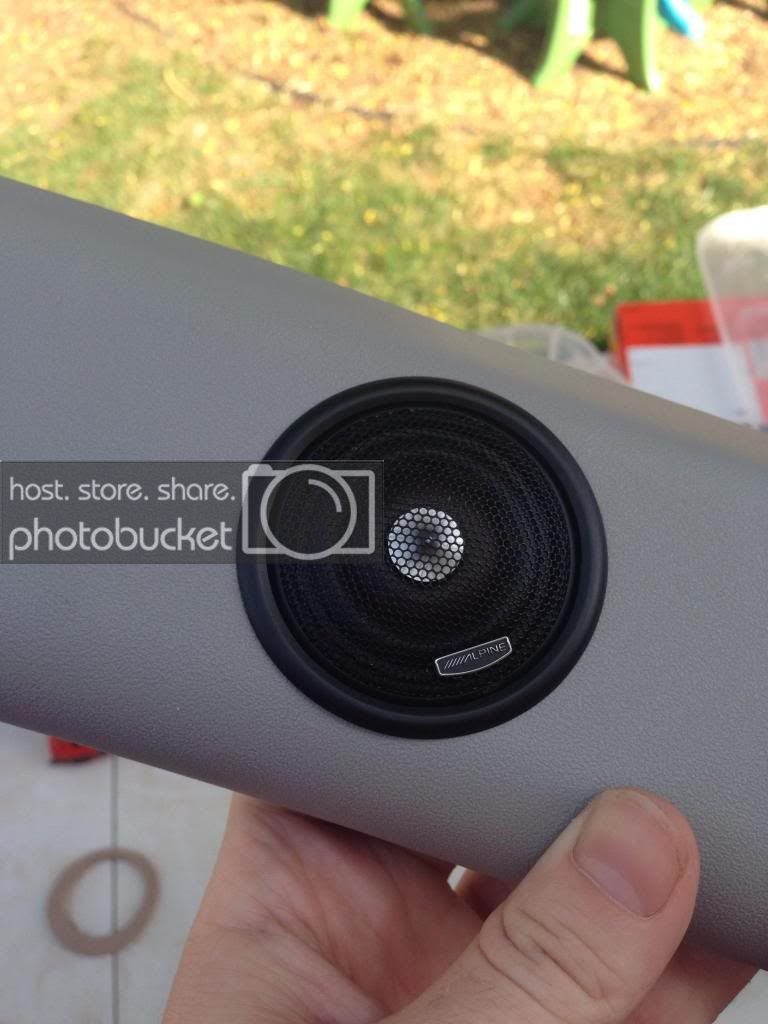

So today I got my a pillars done and my mids wired up and ready to be installed. The connections for the tweets were soldered. My first attempt at it on my own. Feel i did a pretty decent job on it.

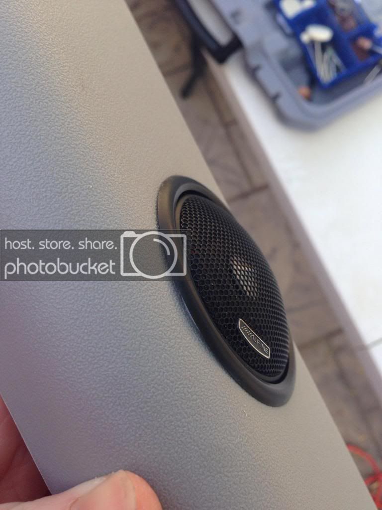

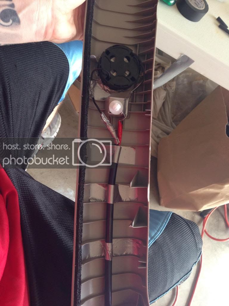

So after I mounted them flush, I wired it up and taped along the back side to be sure that there is no pressure being applied where the wire actually connects to the tweeter.

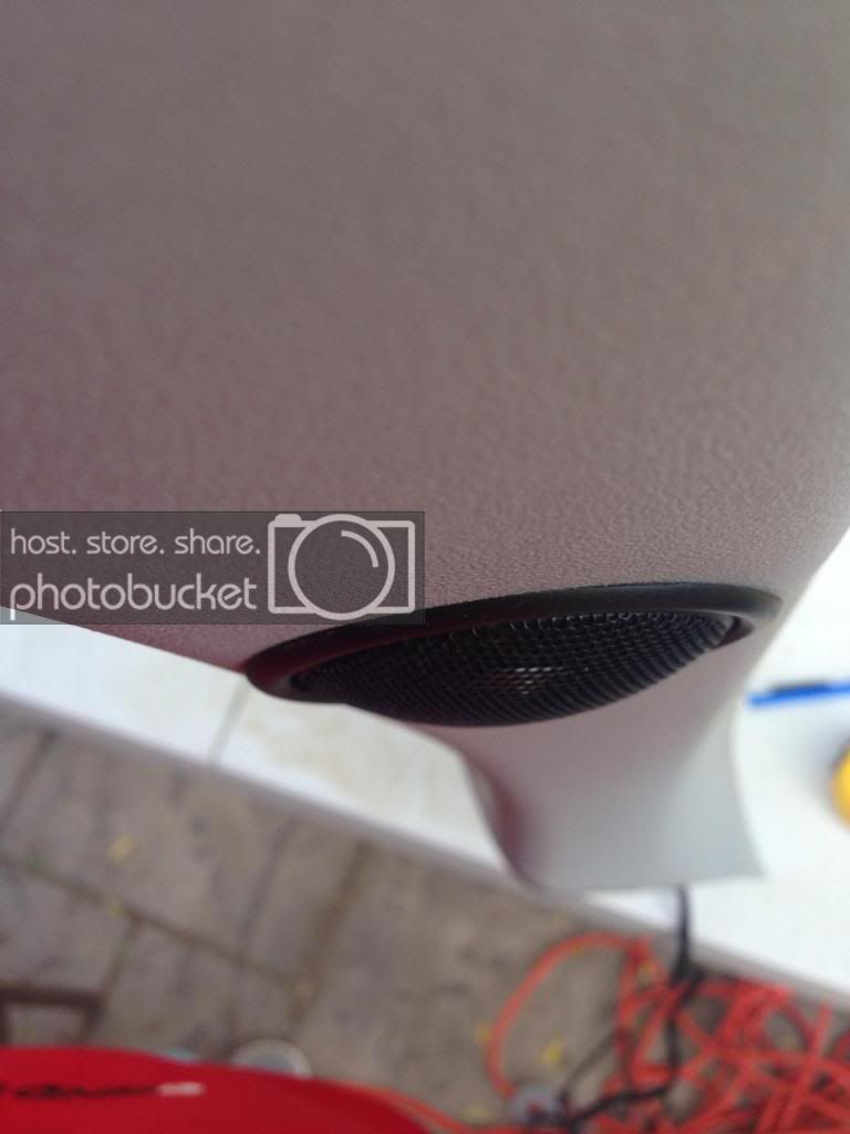

I started by using a jigsaw and cutting out the holes and finished the holes with my dremel to get the just right. After I mounted the cup in I used a hot glue gun and glued the inside so they won't move.

My soldering. Again, my first attempt on my own.

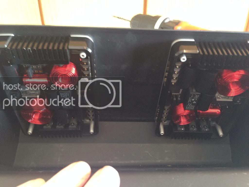

The crossovers will be mounted upside down in my glove box. This way all of my wires for my mids and tweets will stay under the front dash and only have to run the two wires back to the amp.

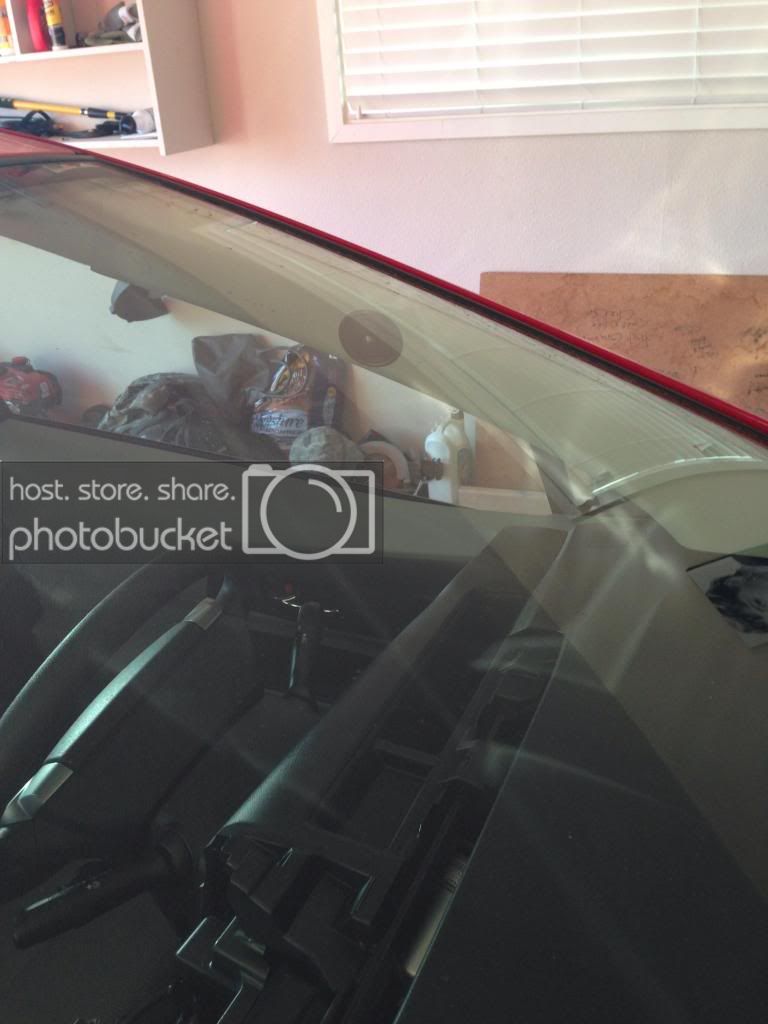

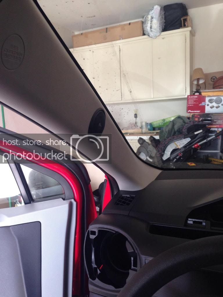

Pic so the back of the a pillar and how it looks from my seat.

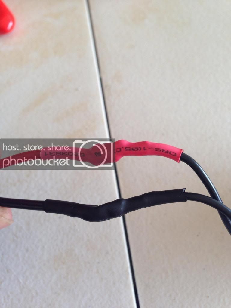

Pic of the mid all soldered and heat shrunk as well

Nice job on those pillars, after seeing what you did with a dremel and jig saw I think I may give it a shot in my girls car. Her tweets are in the door panels facing towards the headliner. Doesnt sound to pleasant.
It's pretty easy. I made the big cut with the jigsaw and then just took my time with the sander on my dremel. Sand a little and then hold up the tweet mount and sand a little more. The plastic actually cuts very easily.
Depends on the tweets too. Mine have great off axis response so I can get away with them being there
