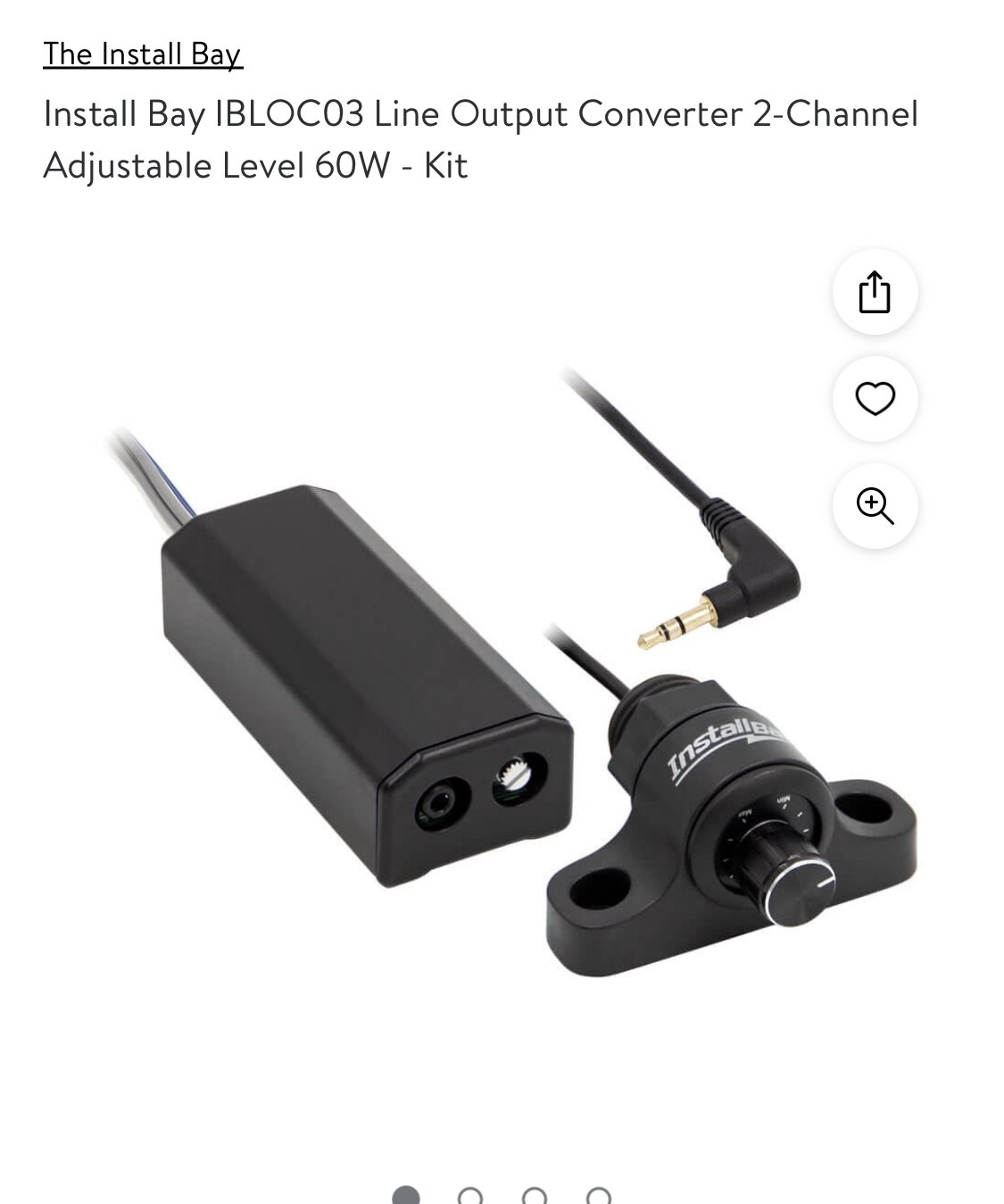

last night I attempted to hook up amp and sub to car only to notice the amp didn’t power on at all, tried tapping into only 1 rear speaker side instead of 2. Checked ground , power , sand the ground of paint. Any idea what would cause this issue ?
Only issue i can think of now I thought about it is that I cut some of the blue “remote” wire I had left over and used it as 12v wire to run from loc to 12v of amp , would that cause issues or do you need a specific wire for that?

I’m tried to use the blue remote wire to power the loc and to use the remote
Used remote wire that came with amp wiring kit
Remote wire from loc to “remote” on amp.
Yellow wire to 12v power in same slot with power wire from battery to amp

So if I'm understanding you correctly, you wired the remote and power for the loc to the remote and power terminals on the amp? Theoretically that should work. If you've got a multimeter on hand you can check the rcas coming off the loc for voltage. play some music and probe the rca to see if youve got a signal. Set the multimeter to ac voltage, positive probe on the center pin of the rca and negative probe to the outer metal barrel of the rca. Make sure not to short the two of them while you do it tho.

The amp should have a connection for the blue turn-on wire. If you ran the wire to the 12V connection on the amp, it won't work. Possibly blow a fuse and cause some negative issues. Run the blue wire to the turn-on connection on your amp and check fuses to make sure you didn't blow any. What type of amp do you have, so we can google it and look at your connections.

No I mean I ran the blue turn on wire on the loc “remote” to the “remote” of the amp so it can turn on amp
Cut and used the remaining of the blue wires left over to ran the yellow of the loc (12v to the power in the same slot as power wire )
I’m guessing my amp just bad after sitting in the car a year unused , or either I really have to tap in on both right and left speakers or actually ground the loc (only amp grounded )

It’s power acoustik rzr1-2500d amp I installed it previously on 2 other cars and worked perfectly but had a aftermarket radio with rca slots , no loc was used then

Okay I misunderstood what you were saying. So neither end of your remote wire is connected to the vehicles remote wire? That's probably going to be your issue. I forgot you said the amp isnt turning on at all. That remote wire needs to go to the remote wire at the back of the headunit. Then you can add a jumper wire from the loc to the amp. That way they are both getting a remote signal from the vehicle. That loc doesnt have any instructions on the install bay website so I cant be 100% sure but I'm pretty confident that is a remote input, not an output. Also, if there's a ground wire on the loc then yes it needs to be grounded just like any other electrical device, otherwise the circuit won't be completed and it won't get any power.

Ok thanks a lot I thought only remote wire need to go from loc to amp only because auto sense would kick in / recognize and turn amp on /off
Got it , LOC black wire actually needed to be grounded . Every video I watched said said it doesn’t and that’s just to reduce noise but apparently that wasn’t true
