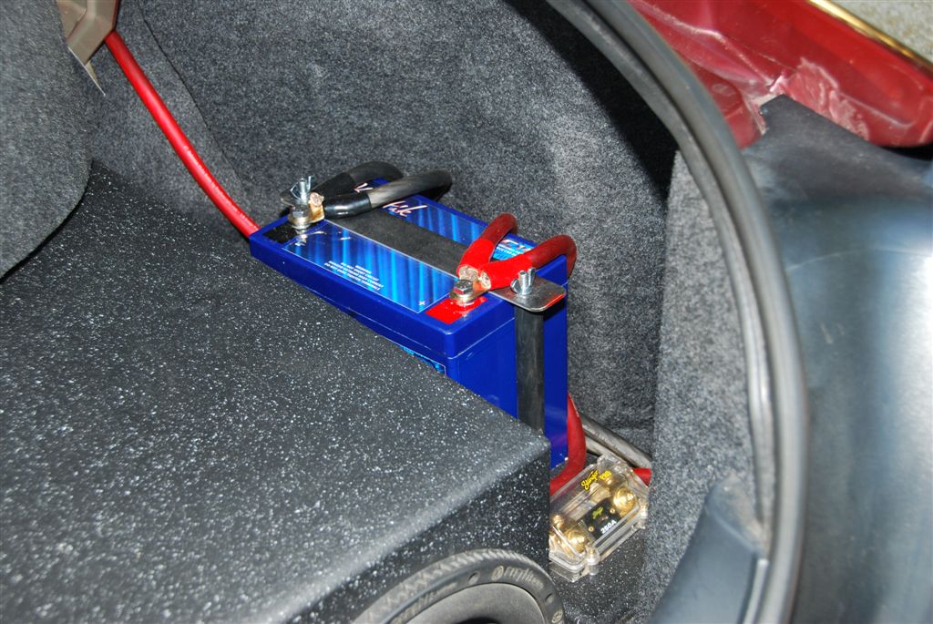

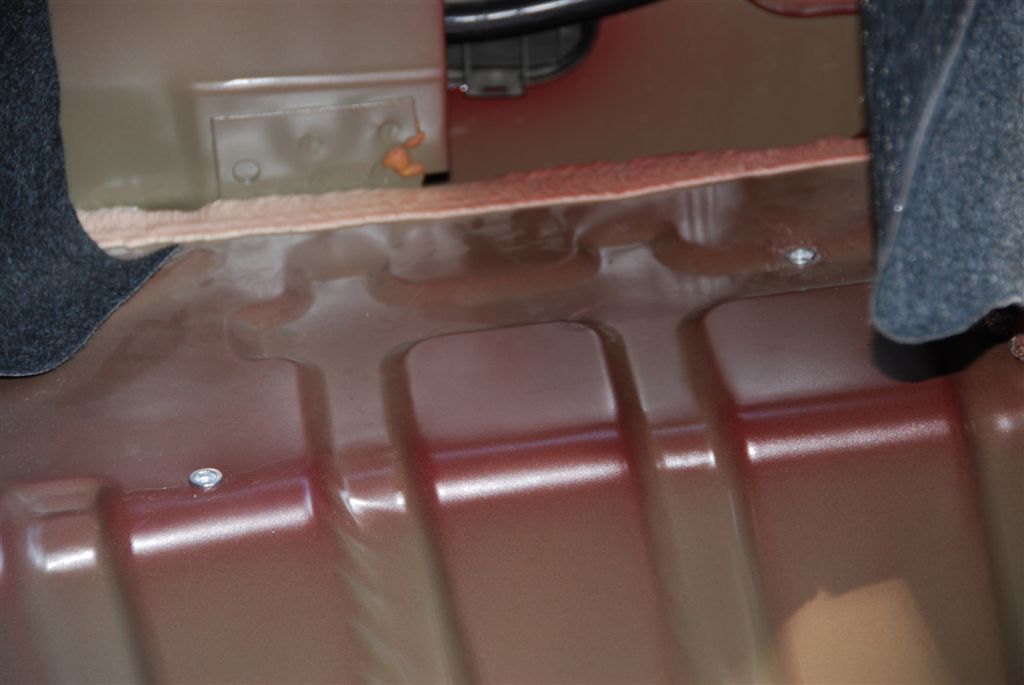

These are of the battery mount. Sorry I didn't take more.
Speedy nuts in the trunk for mounting battery

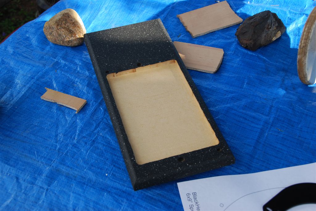

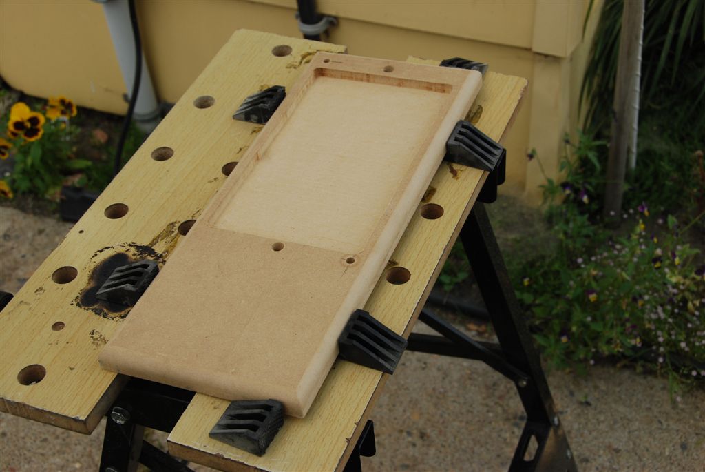

I searched far and wide (drove around for a couple hours to auto parts stores) looking for a battery holder and got frustrated... so I made this (with trusty Mr. Ryobi again...)
00156z58
00157xg9

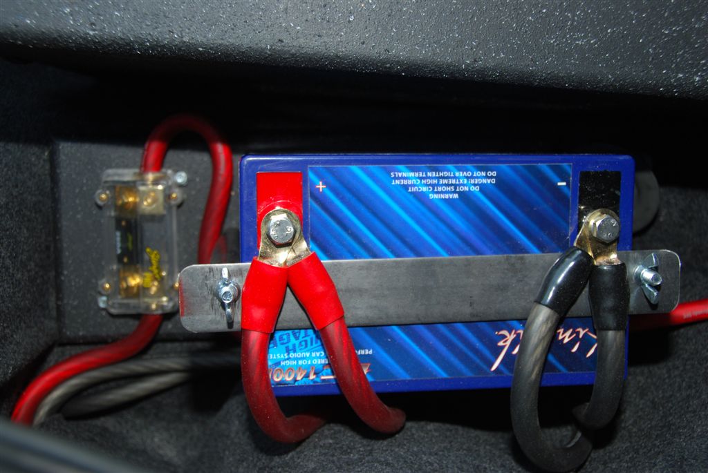

Then a trip to the hardware store to get some flat bar, ready rod, wing nuts, and those wood nuts (the ones you hammer in from the oposite site that have the big teeth that go into the wood). Threaded rod into those nuts, then battery and vaccum tube, flat bar ontop and put on the wing nuts. Then a couple bolts through the wood into the speedi nuts that are in the trunk and you have...
00158qwp
00159dqx
That one possitive wire there was too short so I had to run it like that... I bought some more wire and plan to run it through the fender (behind the carpet) like the rest.
And there you have it... battery mounted. I have still to put some dielectric compound on that flat bar as it is a tad close to the battery terminals for my likeing.
