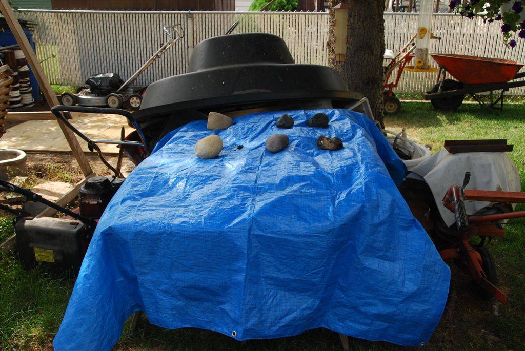

I dont have a garage or anything to work in so I had to do this all out side... thus the tarps and stuff to cover stuff up lol.

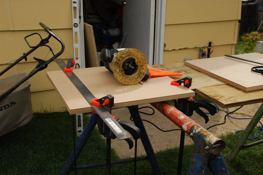

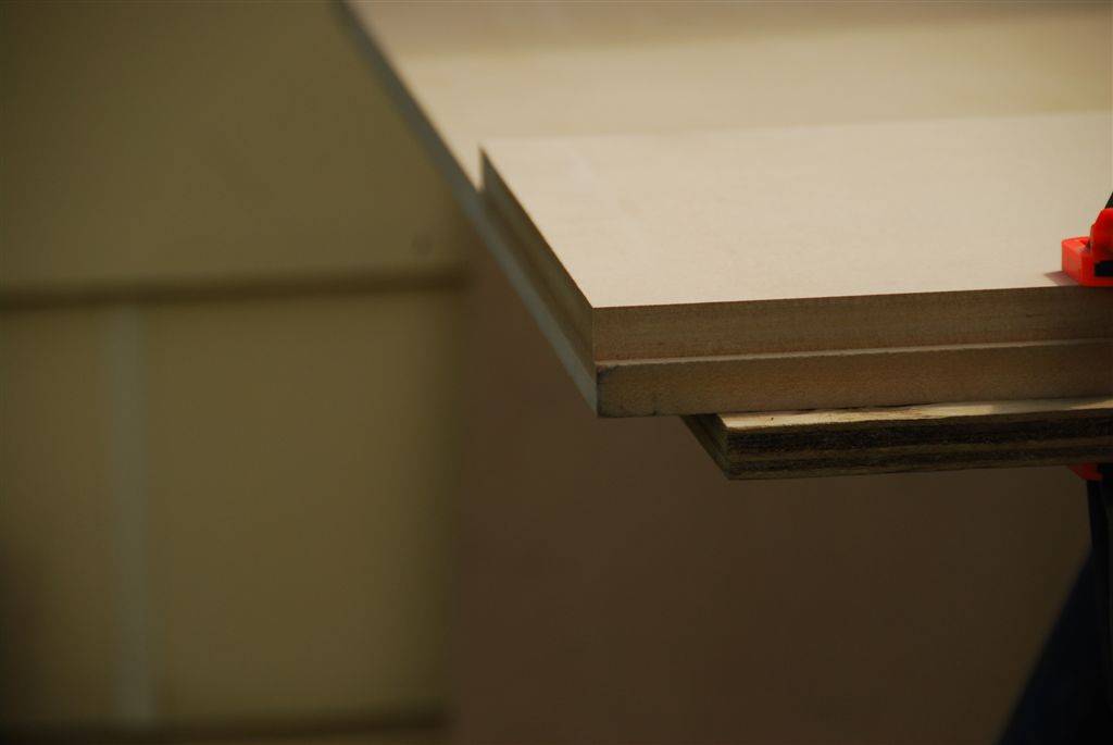

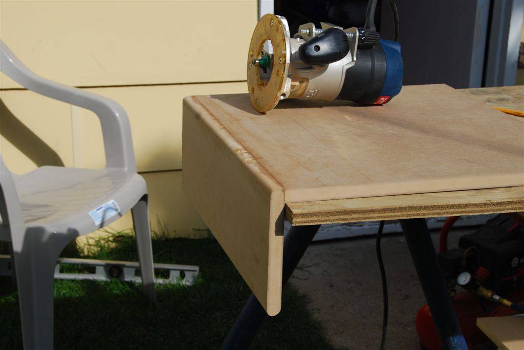

Mr. Ryobi router cutting wood to finish length
001291yq

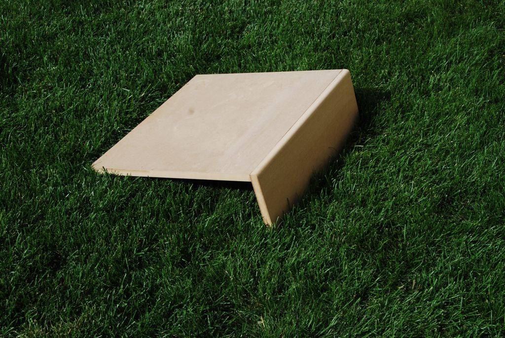

Since I wasn't using the most accurate means to cut to finish length... I would cut one peice to length and then line it up to its opposite peices (IE side to side to middel and top to bottom) and use the flush trim bit to make them exactly the same.
0012bx3h
Worked pretty good actually... I did the same thing with the front and back. Once I got them on I ran around the entire box with the flush trim bit to make all the edges flat. I think I made good due without a table saw //content.invisioncic.com/y282845/emoticons/biggrin.gif.d71a5d36fcbab170f2364c9f2e3946cb.gif

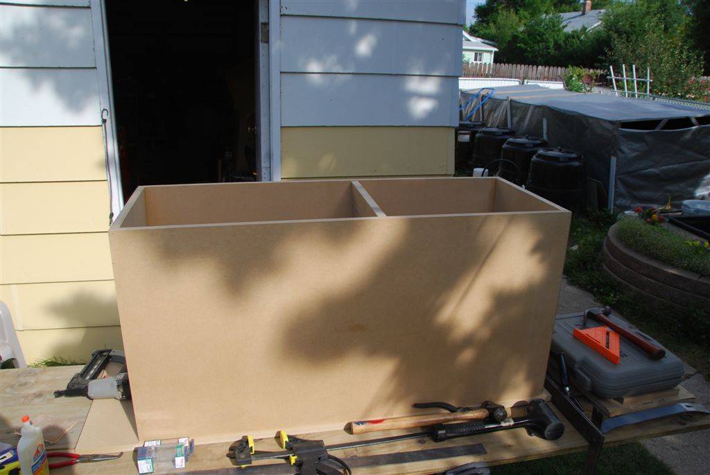

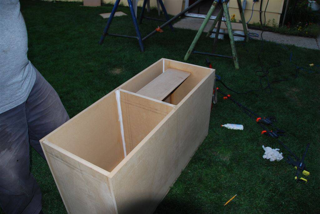

sides and top and bottom (middle in for test fit)
0012e6r3

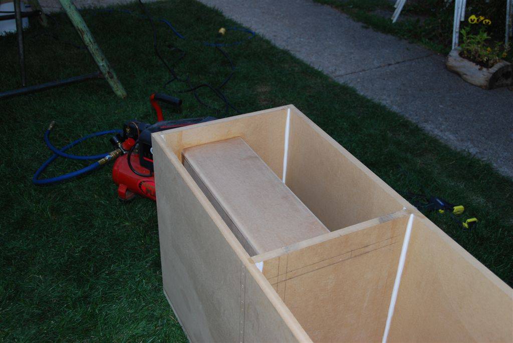

Middle glued and nailed as well
0012fegd
Port 1 in
0012gpps

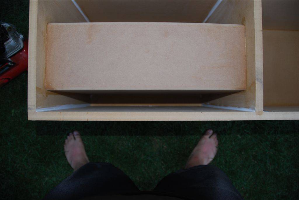

0012h29c
0012kx3b
Both ports in and clamped to dry (couldnt get nails in on the one edge of the port... lots of clue and silicone it will hold =D)
0012phd8

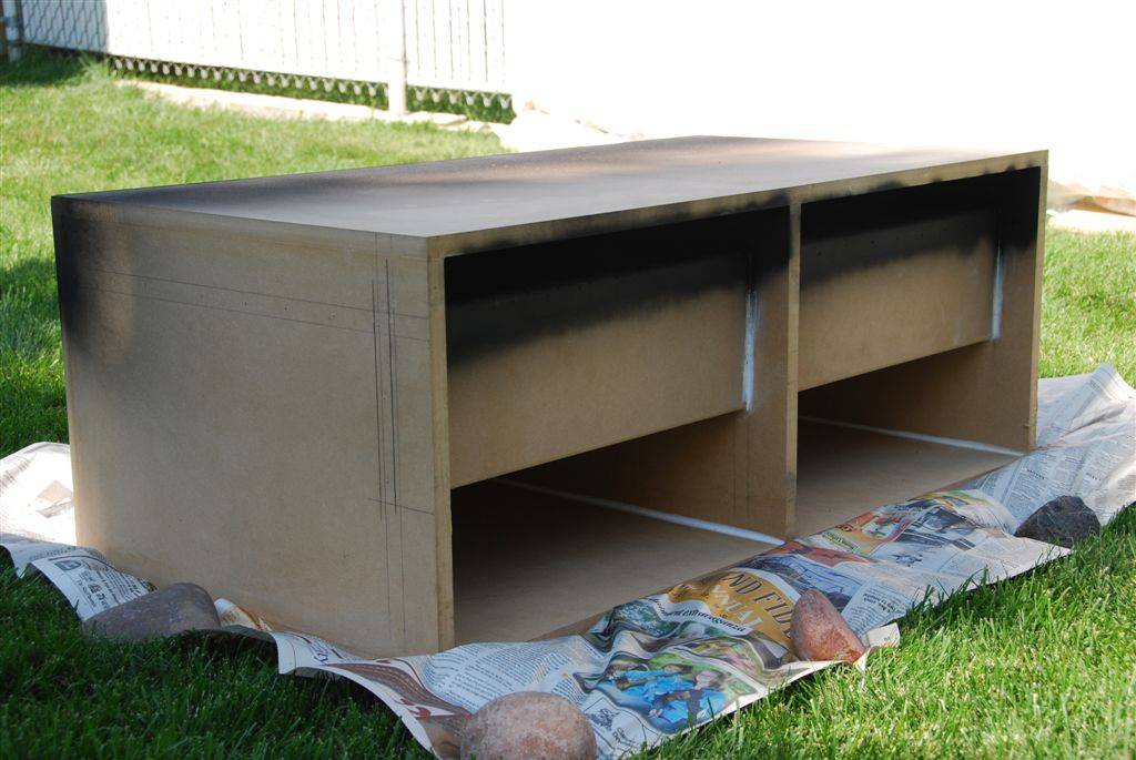

Next day (bought a new bit for rounding the port)
0012rk6a
Port painted
0012sykr

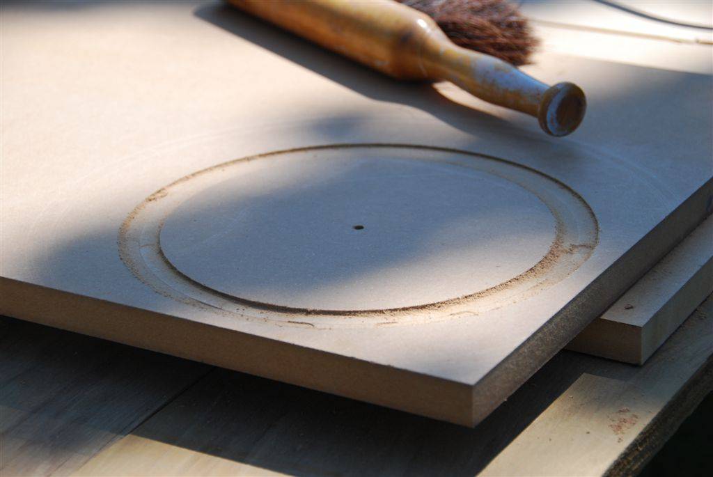

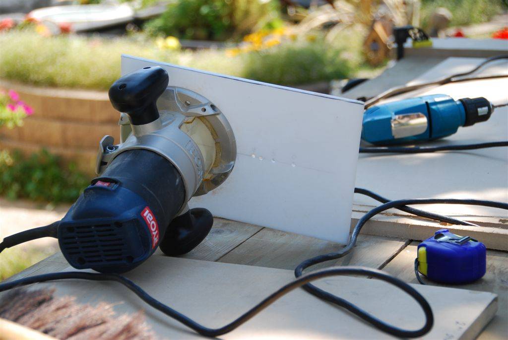

Testing circle guide
0012t73f
Circle guide on Mr. Ryobi
0012wqs4

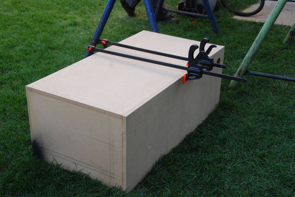

Back on and clamped (that one edge was being stubborn!)
0012xf3k

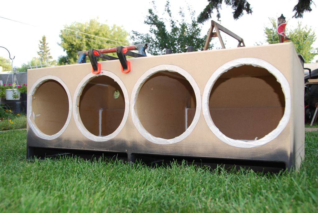

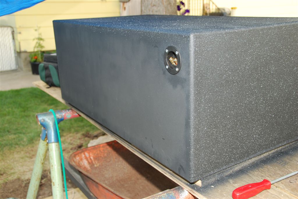

Also cut the holes and masked them off before putting the back on...
0012yqfz
0012zg1f

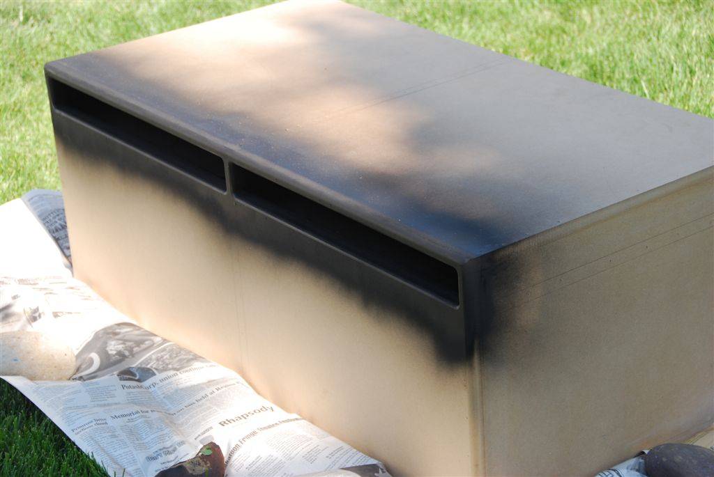

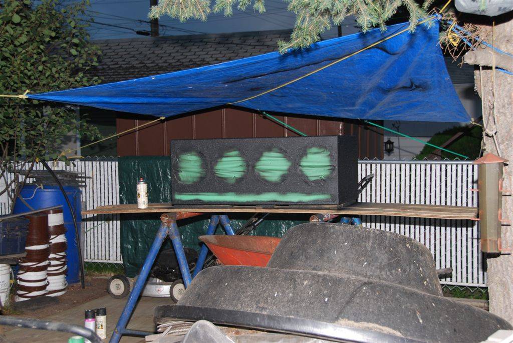

I routered all the edges with a 3/4" round over bit and then painted the whole box in flat black and masked off the port to do this...
00130tq4
Again its outside and weather is being dumb and thus...
0013124c
ghetto rigged sub box tent!

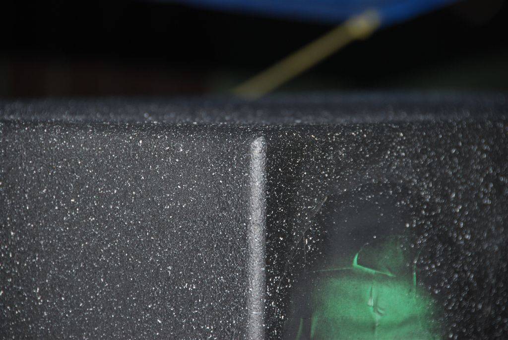

The paint...
001326f5
001338f7
