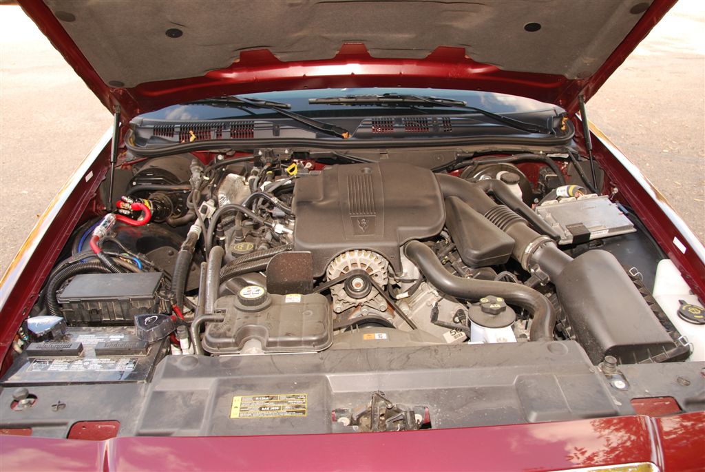

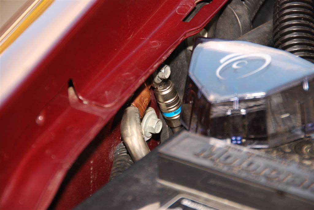

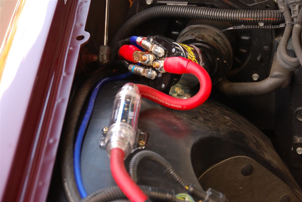

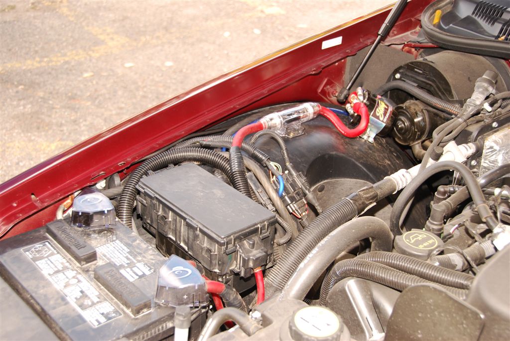

There some pics of my car and the isolator I installed on the weekend. That officially signifies the end of my build for now.
Sorry for the dirty engine bay... havent had a chance to clean it...
And you can see where I tapped into the stock harness with the blue wire for true ignition on for the isolator. I got the relay number for it from my manual, opened up the main fuse box there by the battery and got scared away by the rats nest (the wires i mean). However I used that to trace the ignition wire through the harness where I melted the insolation on the wired and soldered my new wire to it there. Worked out well actually. As it stands now on idle I have a .06v drop between the front battery and the back battery.

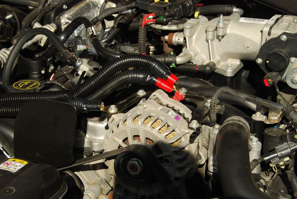

Alt to front and rear batt pos and alt to rear batt neg.

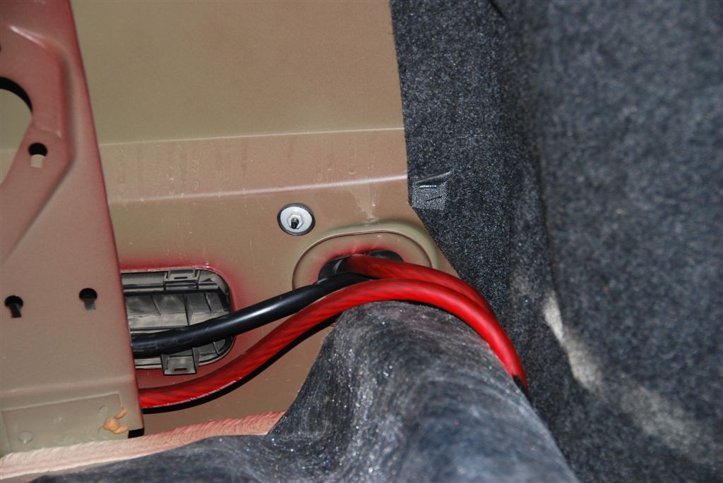

I run the cables underneath the car and tucked them up next to the frame (secured with some heavy zip ties) and then brought them up into the trunk through a body plug shown below.
0014fakz

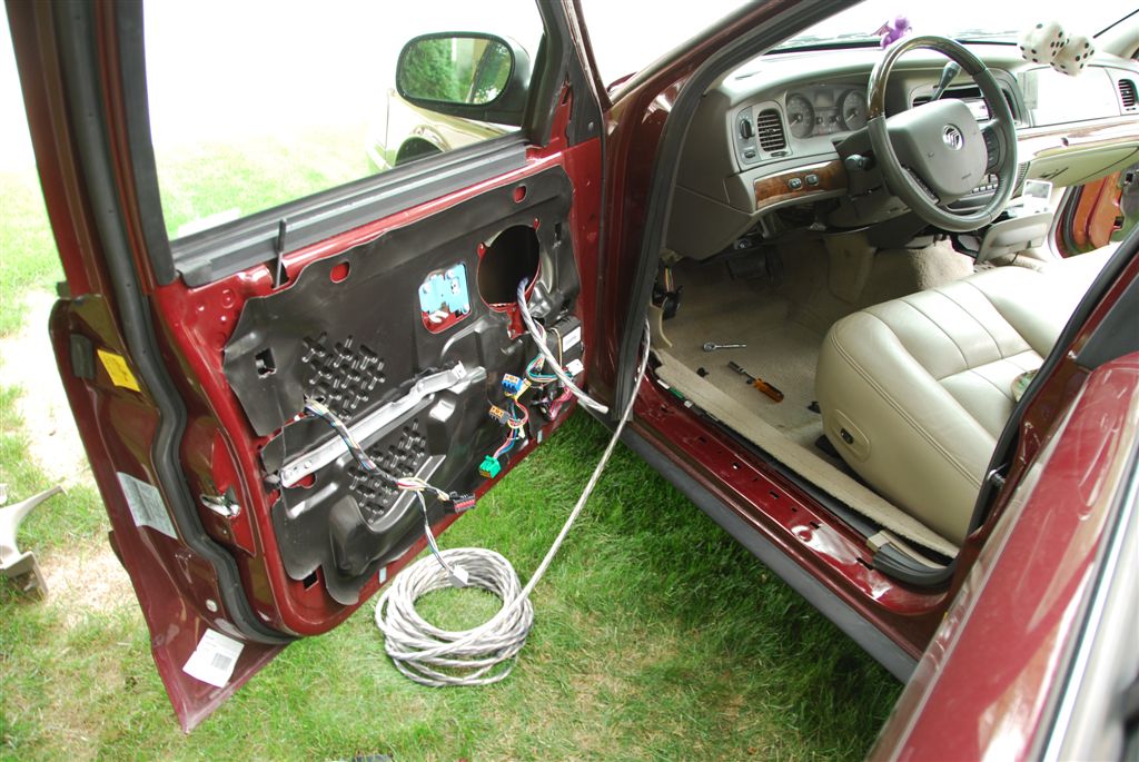

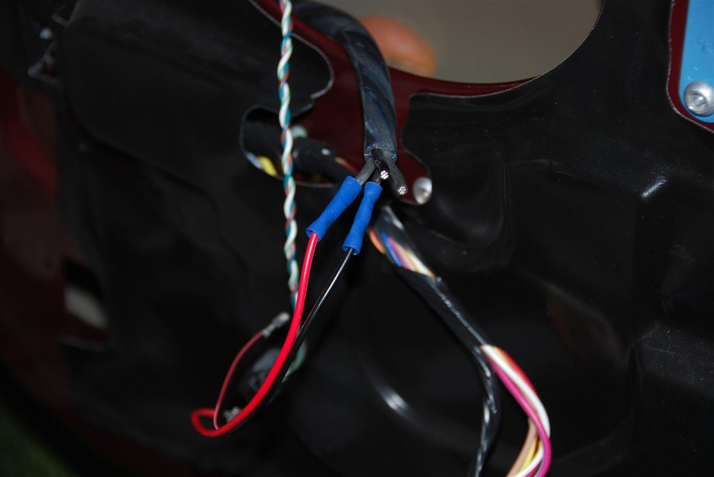

Running speaker wire...
0014g2rb
0014h3w3

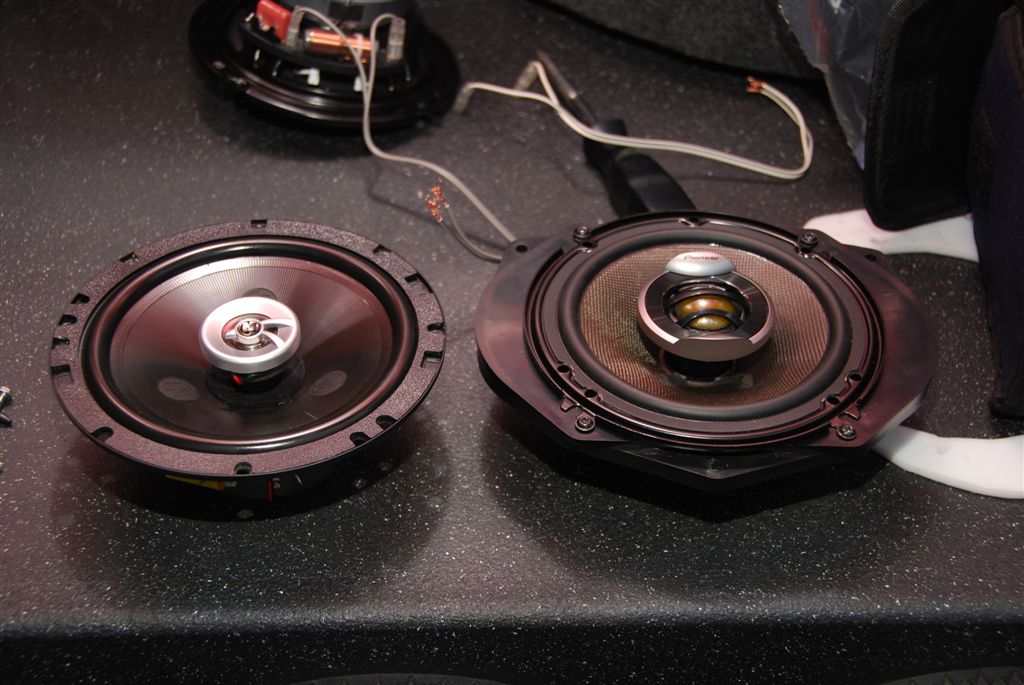

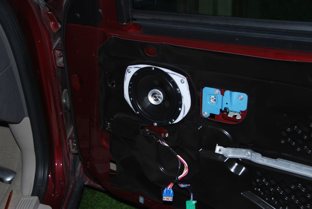

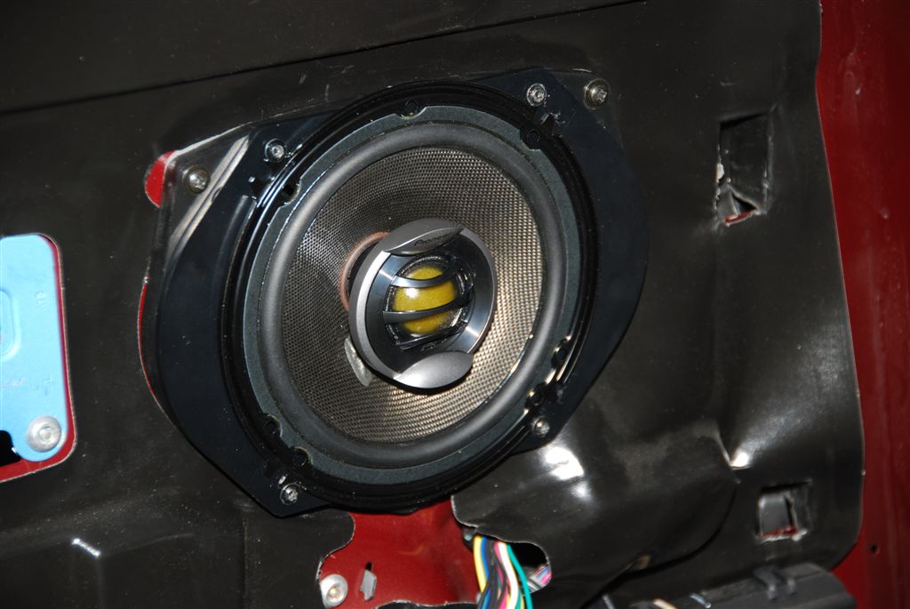

Installing Speakers...
0014ksfp

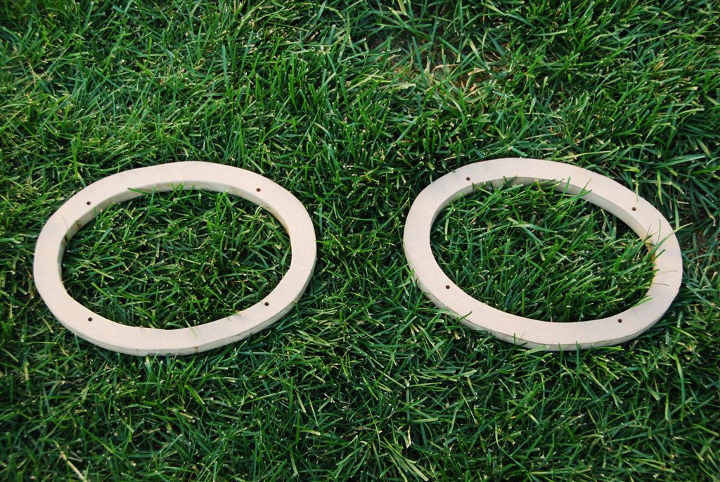

Made a baffle out of plexi.
0014p9c6
Can't even tell they are there...
0014q850

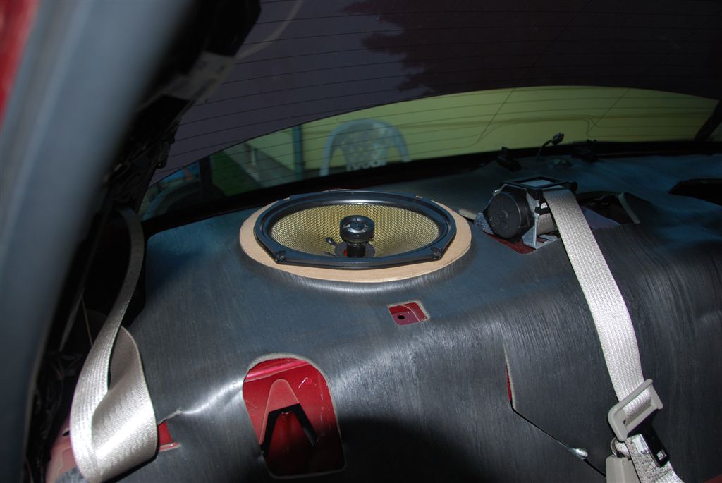

6x9 baffles...
0014r9wd
0014sb9e

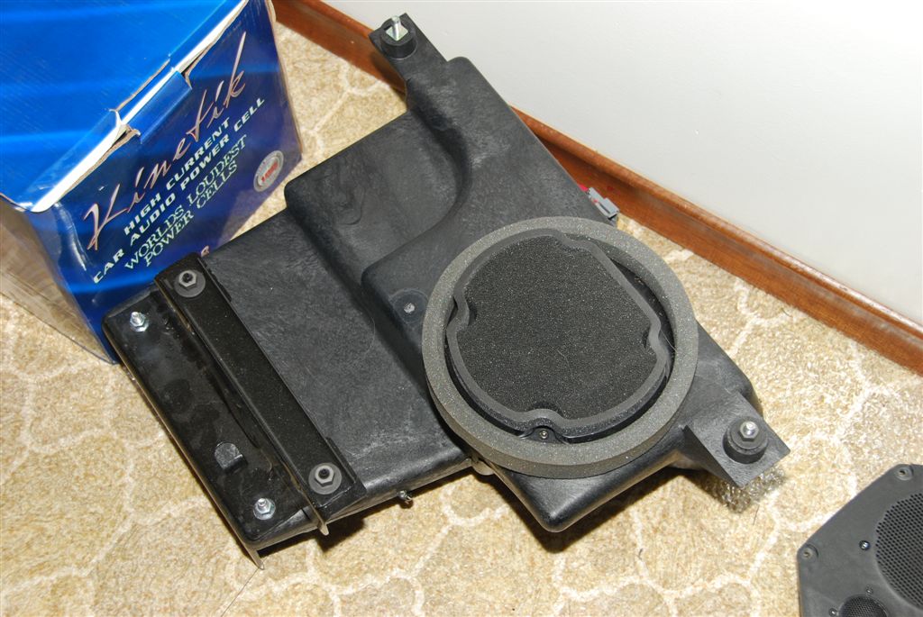

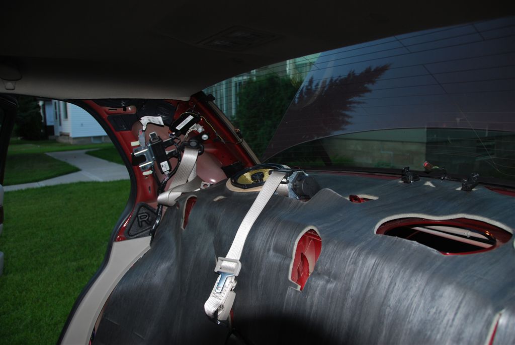

Here you can see the stock sub hole in the rear deck
0014t3rs

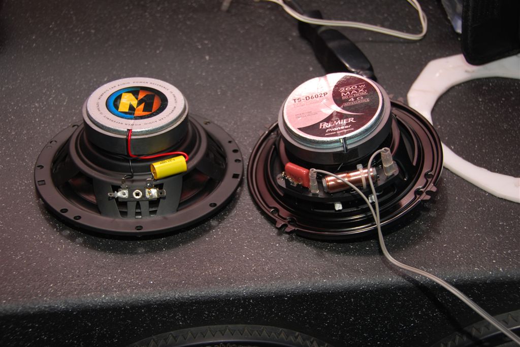

Driver side speaker tweeter went after a couple weeks (was only getting 20wrms so I have absolutely no idea wtf went on there)
0014x54r
0014ytbd
0014zgqy

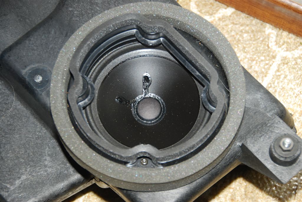

Dont fit as nicely behind my doors but they work. Crossover's look much nicer on these pioneers then the memphis and I think its the crappy crossover on them that is the culprit to the blowing tweeter.
Also I want to go components but not sure where to put the tweeter... am currently thinking of modding the sail panels and putting them there. I already have the bi-wire in the doors so might as well take advantage of it there isntead of pulling the wire back out for the a-pillar...

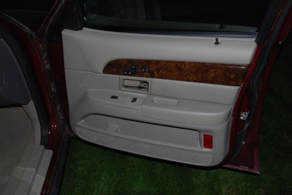

STOCK!
001504w7
You can see the two way speaker in the corner kinda... 4" mid and a 1" tweet... descent... kinda...

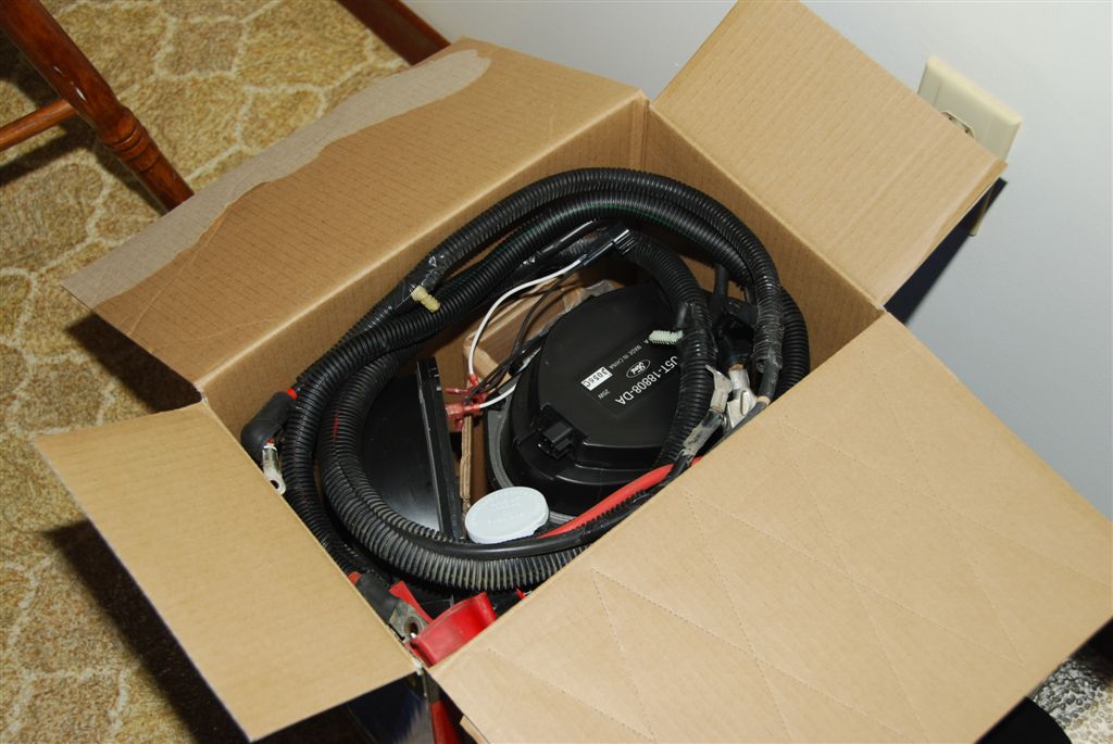

Shoved it all in a box...
00153fer
Hehe... glad its out of my car...
