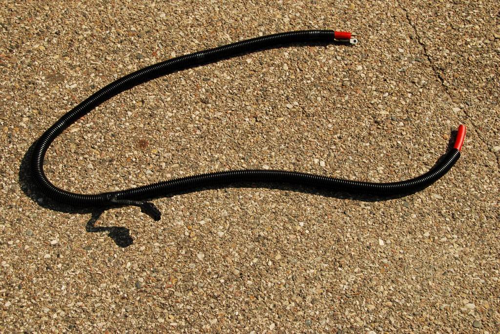

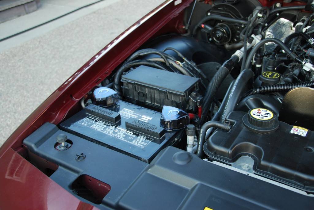

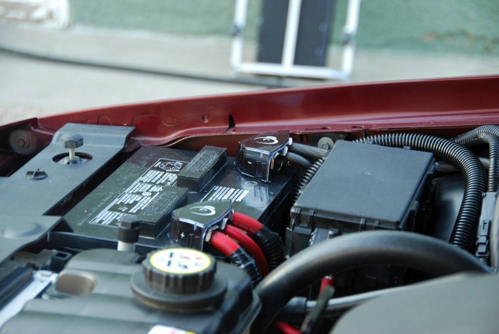

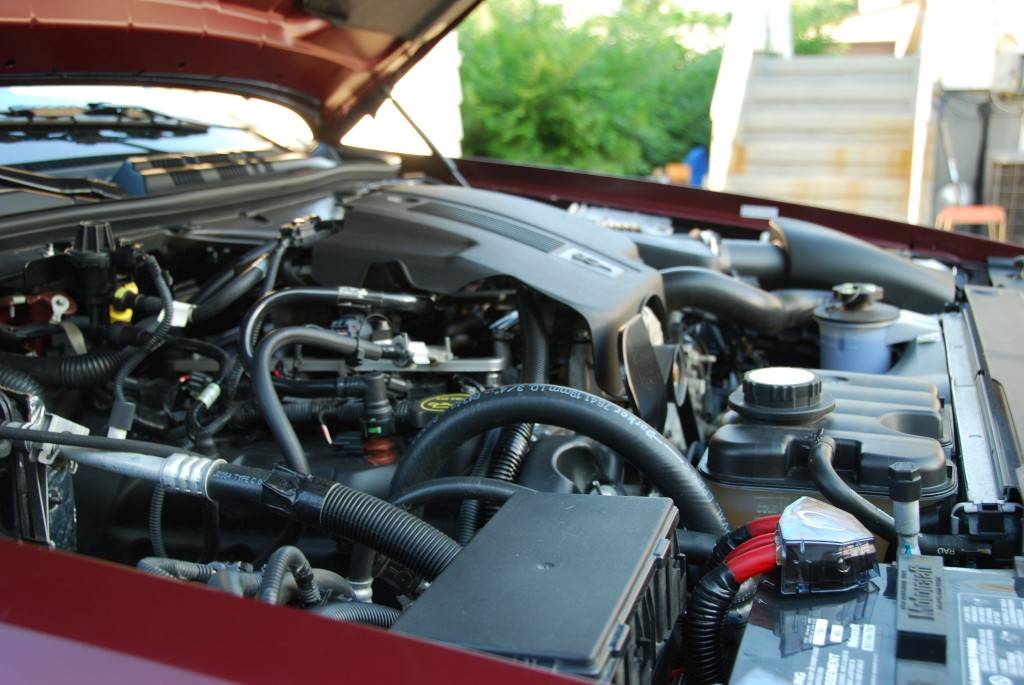

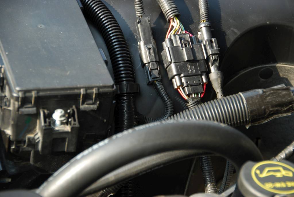

All I have done to date (did it today actually) is the BIG 3. Without further adue... PICS!

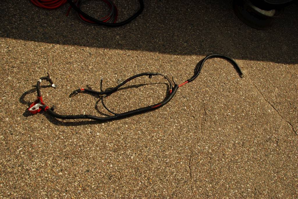

Stock wiring... gotta love it. At first I was impressed with the stock wiring... all 4GA! but! if you look closely there at that black peice between the red stuff... yup thats right... 8 GA connect two 4GA... grrr. WHY!??!??! Oh well doesnt matter no more.

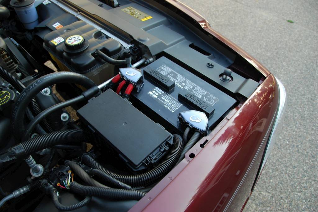

going for the sorta stock look... even got the starter soilenoid wire running in there and it looks really sweet all mounted up.

And there you have it... BIG3!
Completely replace stock wiring. 1/0 from batt to starter, alt, and block. 4ga from batt to body and fuse box (like 4" runs). Already I noticed a difference when I roll down my windows. Before if I rolled down/up more then one window you could hear the motor slow down and strain. Now they stay full power even with all four rolling up with the sun room closeing!
