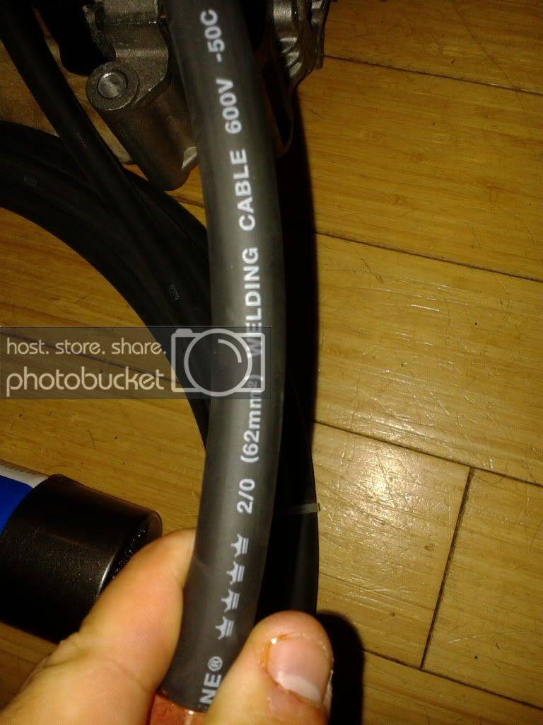

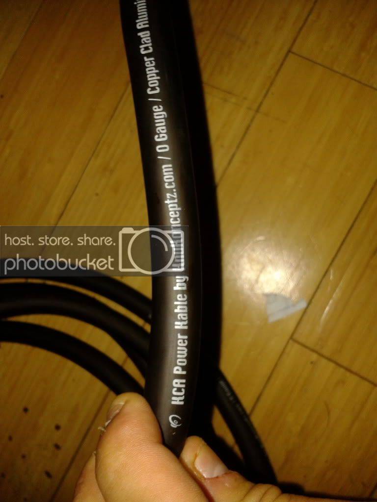

- 280 amp WSP altenator
- Dual XS Power D4700
- 2/0 excelelene cable for power/ground

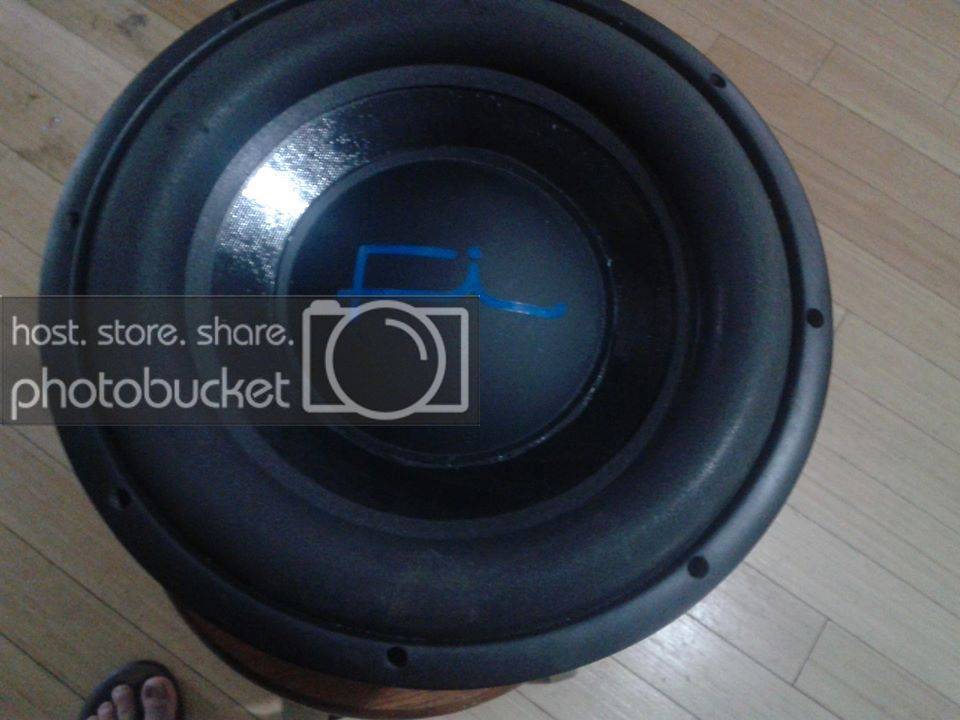

- Subs: Two FI Q12 D1's

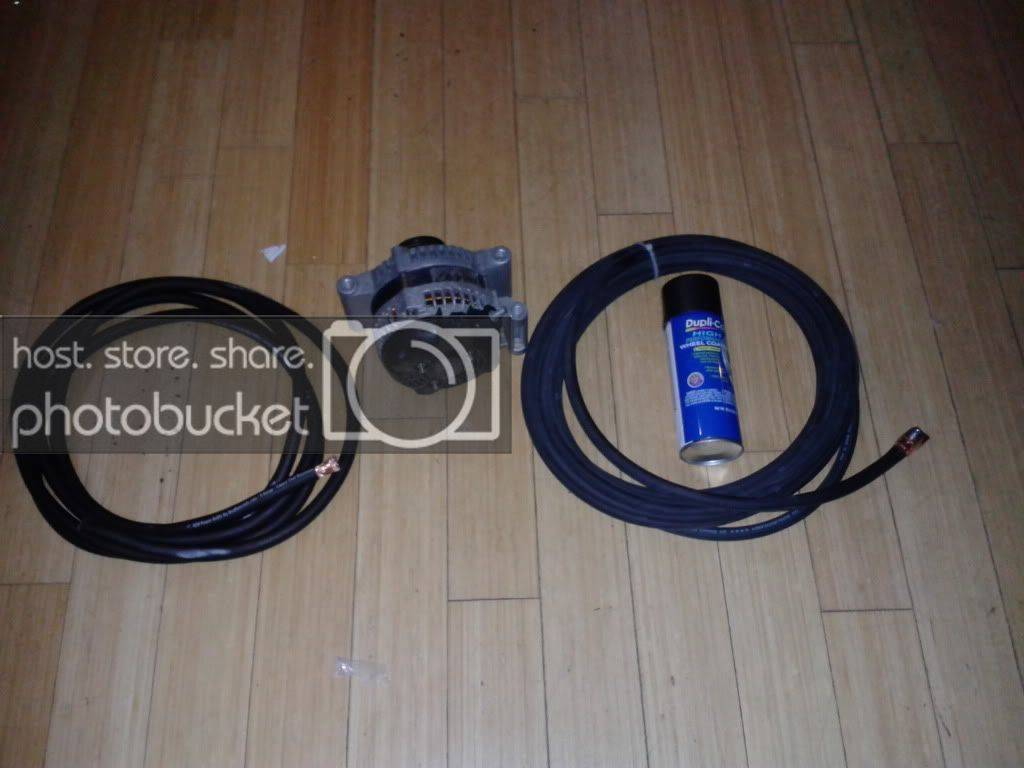

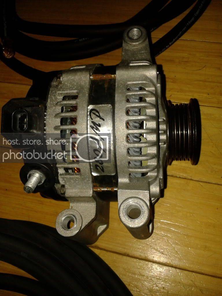

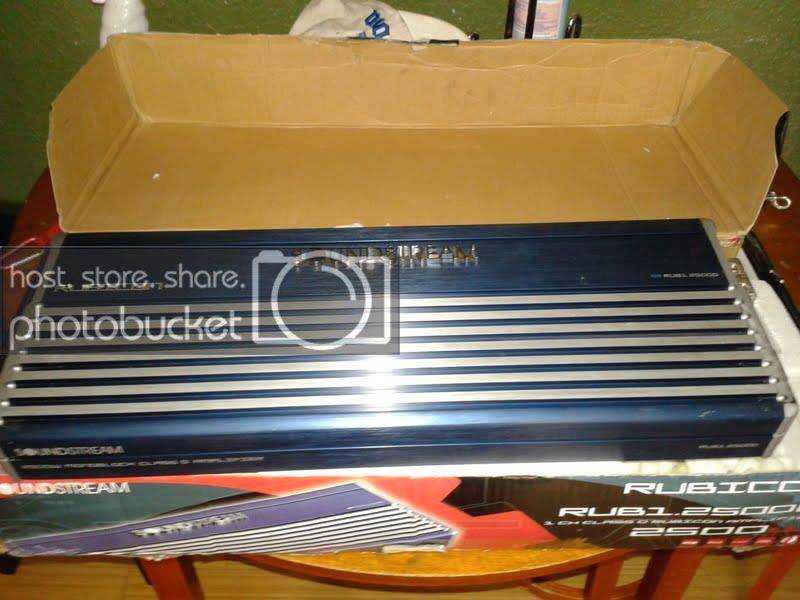

Some pics of the equipment:
Got some work done over the weekend.

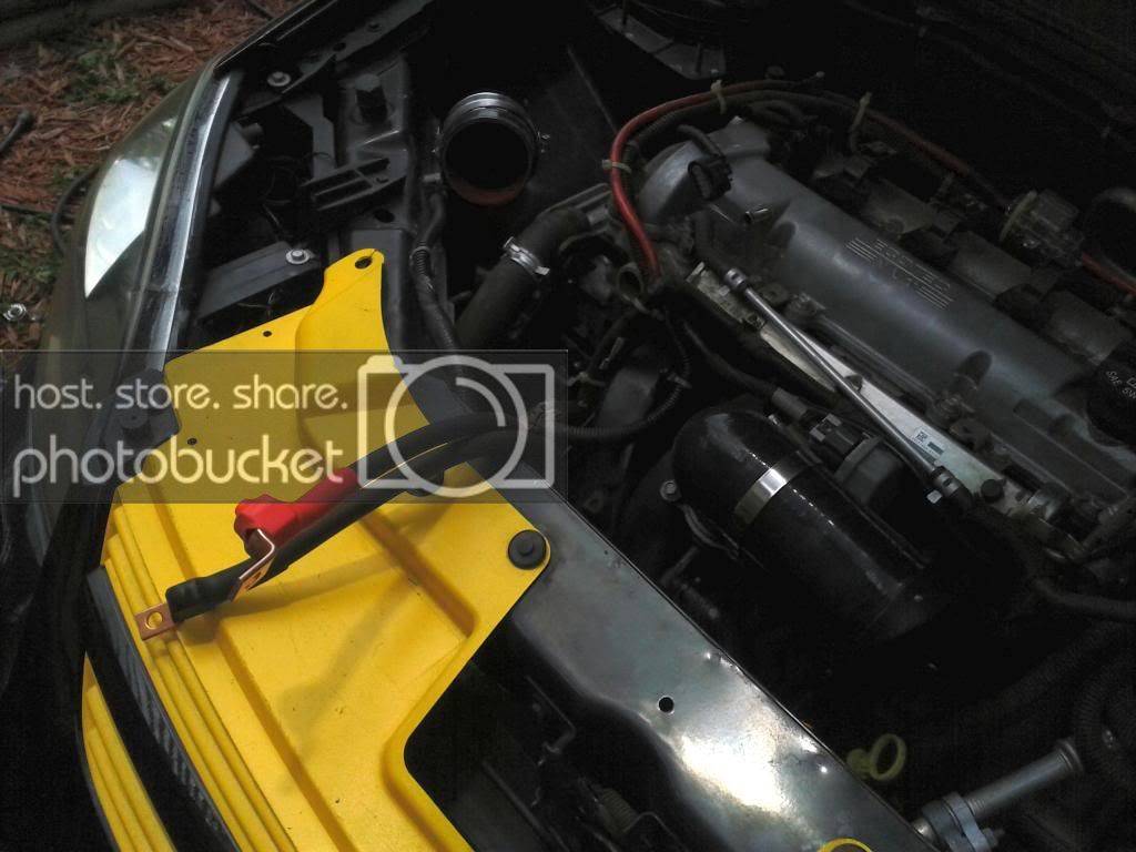

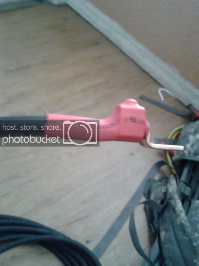

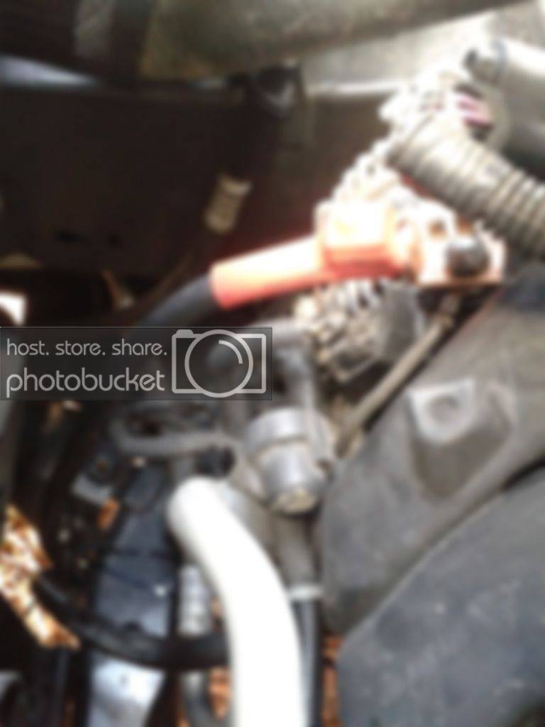

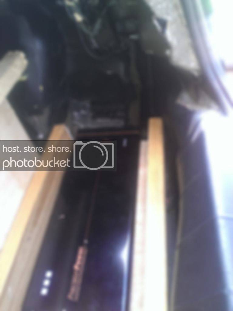

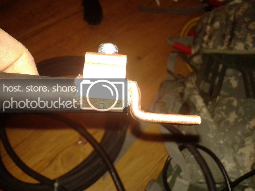

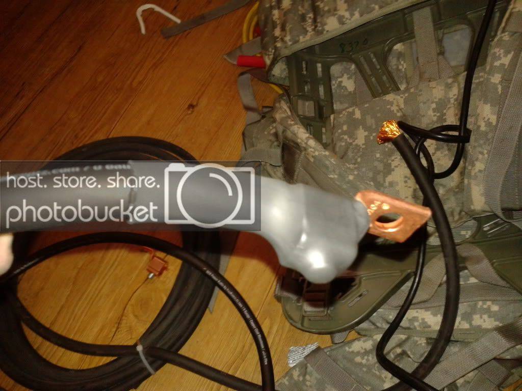

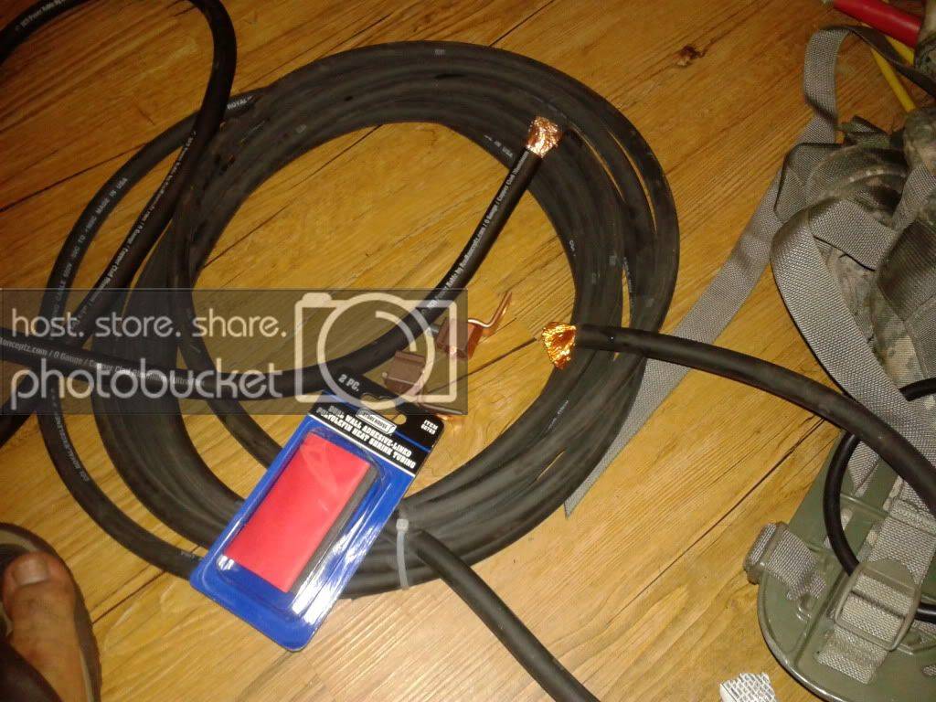

Installed HO altenator, 2/0 supply and dedicated 1/0 ground to batteries. Wasnt gonna run a dedicated ground but I had the 1/0, so yeah.
attaching Cable Lugs
Connections at altenator
Buttoned Back up

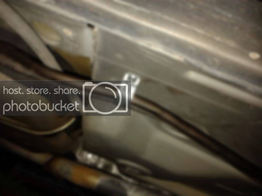

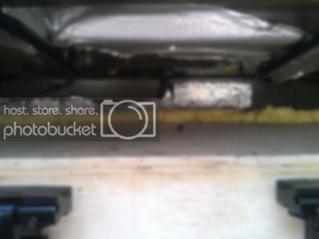

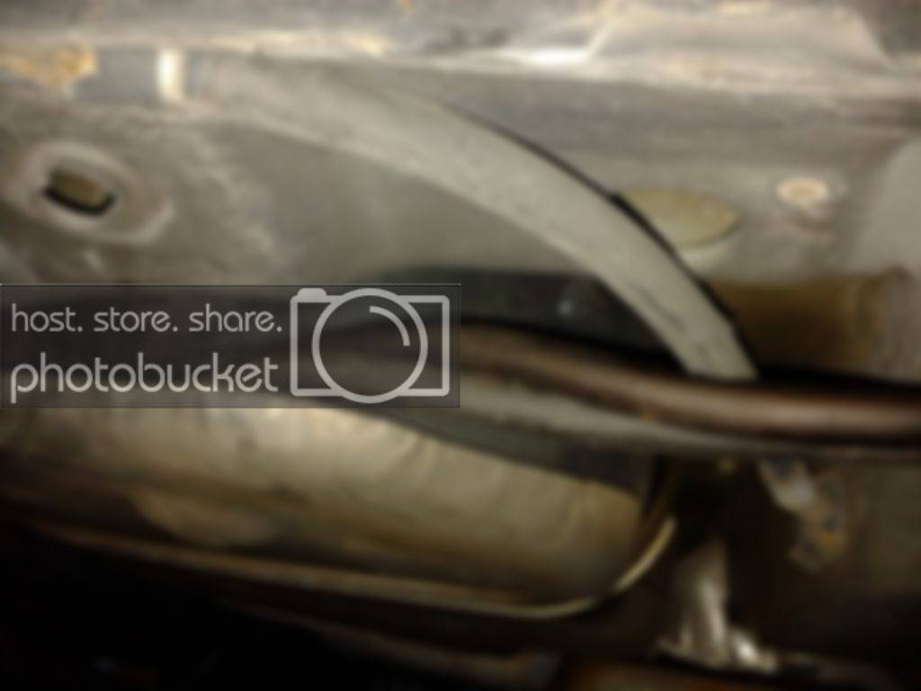

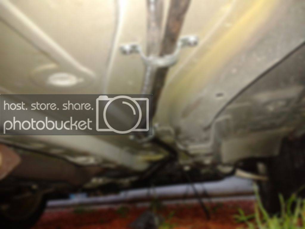

Ran cables under the car

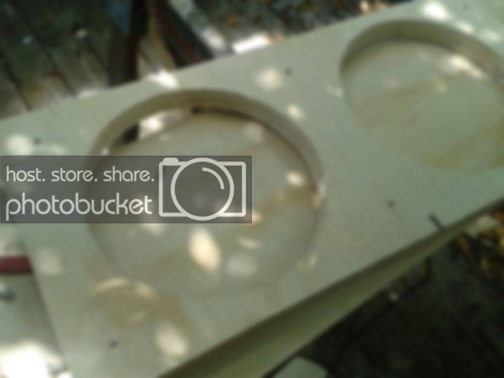

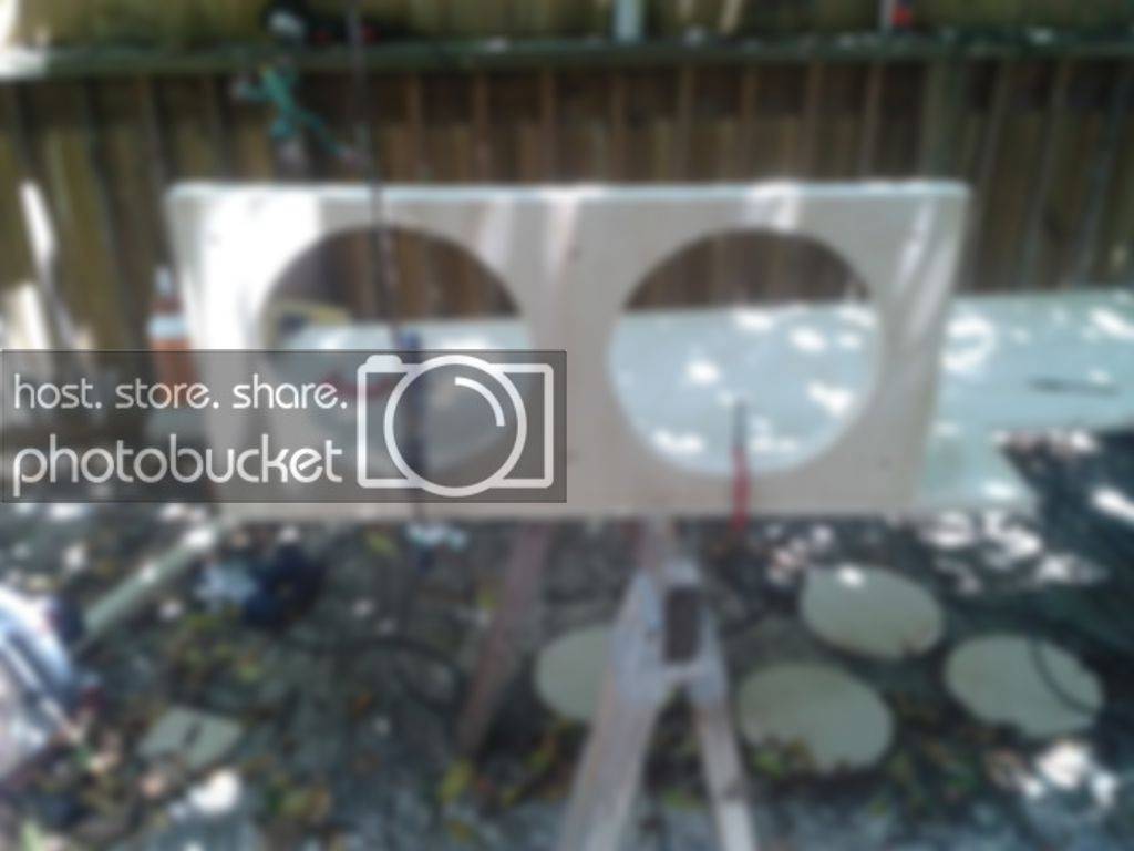

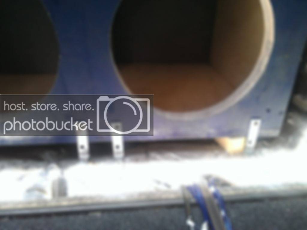

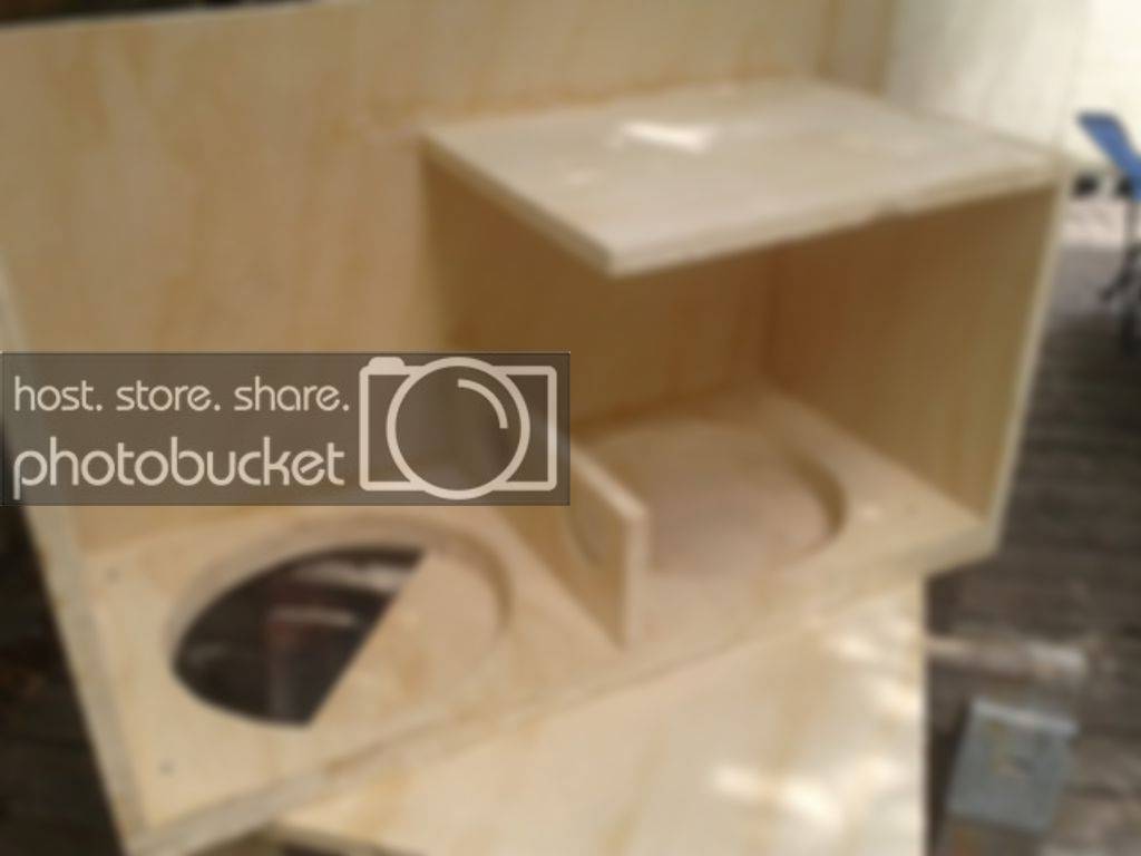

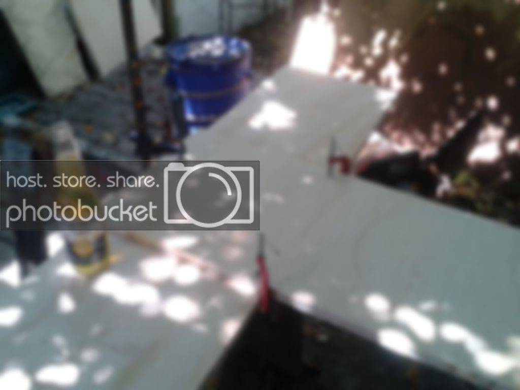

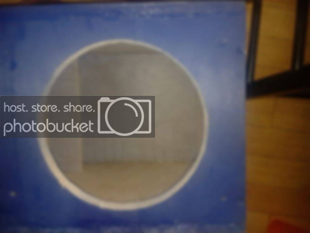

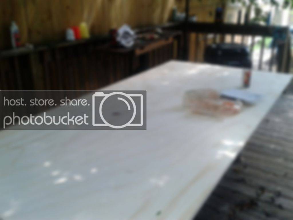

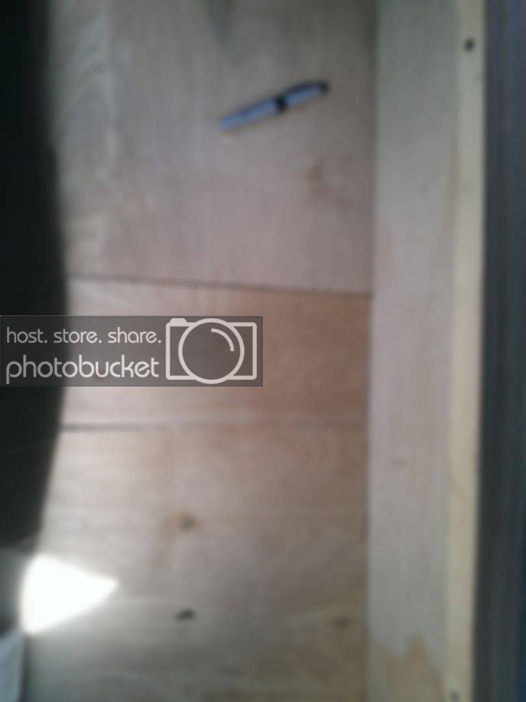

Got the box built this weekend. 3.2 cubes @ 31HZ. I went a little smaller on the enclosure due to space, port size (14.75 inches of port per cube), and Sound quality. Should be +/-1.5 DB down to 30z or so before cabin gain.
Used aruaco cabinet grade pine. Relatively void free stuff and much cleaner than MDF. As a bonus, pine is a softer wood so, with some torque, drywall screws will self countersink. I have been using this stuff for years over MDF. its 23/32 and 35 bucks a sheet. No one has ever told me it sounds any different than MDF.
The supplies and my helper:

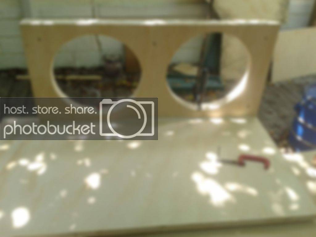

Cutting the baffles:

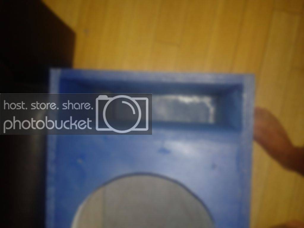

Got the port put together.

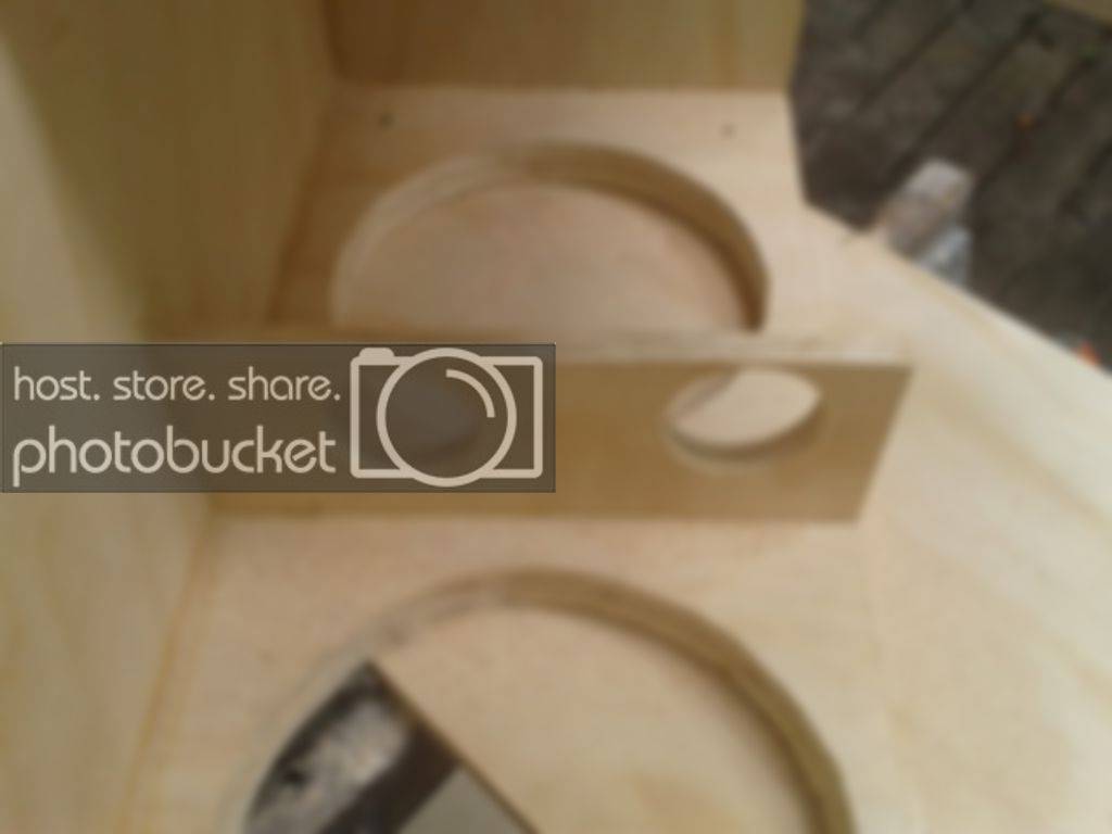

Center brace with air holes
---------- Post added at 12:50 PM ---------- Previous post was at 12:49 PM ----------

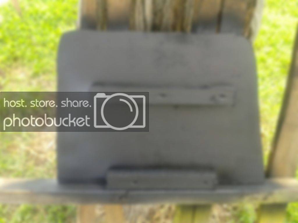

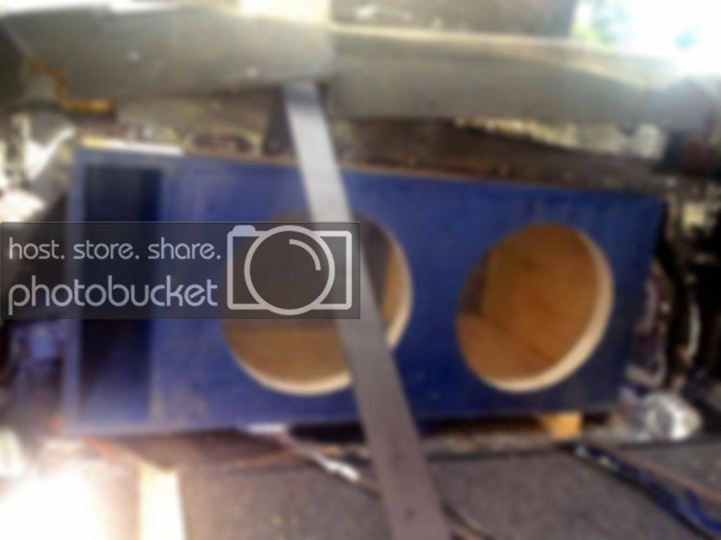

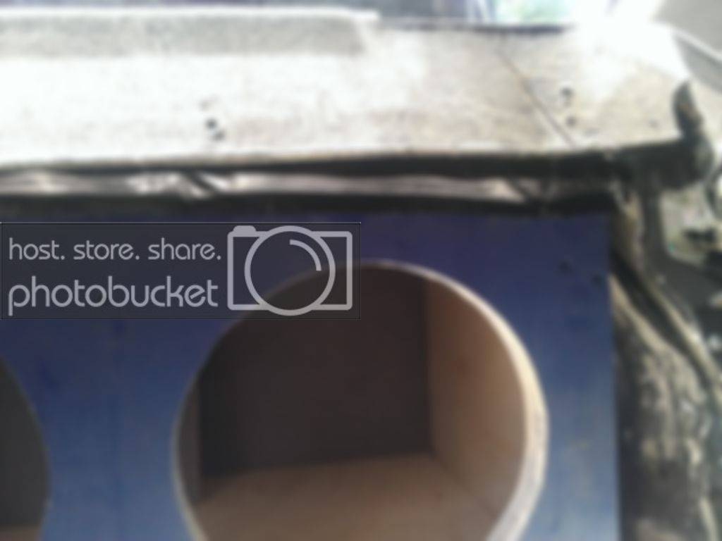

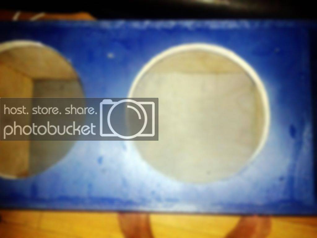

wrapped it up and put some blue spray paint on the baffle. not sure if the painted piece will be showing and will need to sand it some if so, but the color matches the dustcaps.

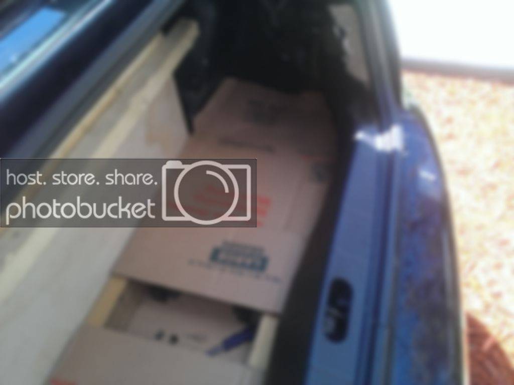

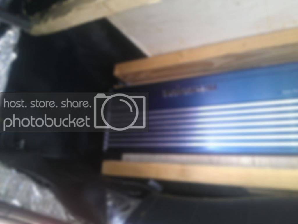

Totally forgot to post these up... Got the box in on monday, as well as started figuring out my battery mounting and amp racks. I plan to get the batts connected and at least the bbase amp rack in.. the Ruby and the 800.4 will run horixontally across the trunk with the 210.2 and 340.4 mounted vertically to the sides. I gotta check out the prices of 1/8 inch plexi locally as I want to make the amps visible an backlight...
On a side note.... anyone now where to but frosted lokking decals to go over plexiglass????? I seen steve meade do this and it looked amazing..... thinking of "SS" logos over the amps but in that frosted look so the lights hit it.... If you get what I mean, lol.

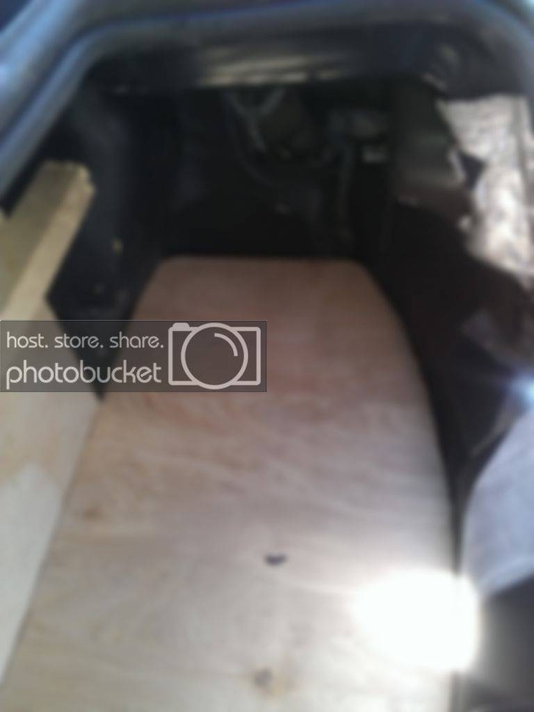

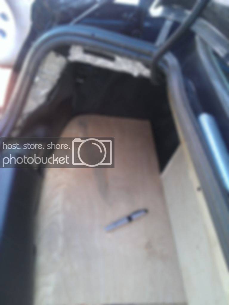

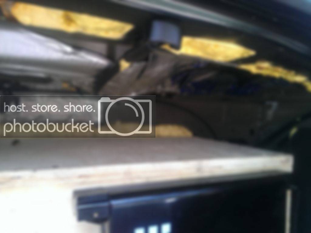

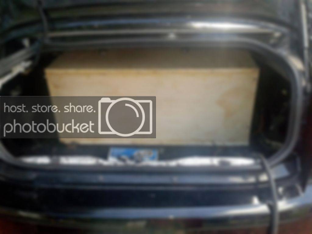

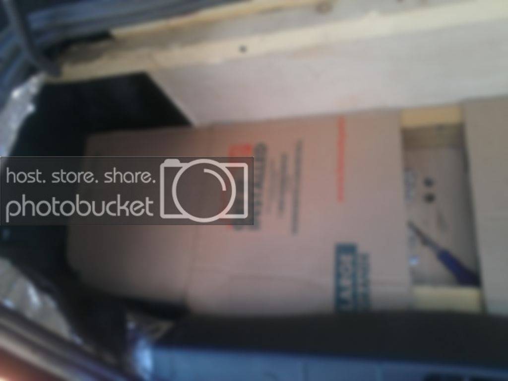

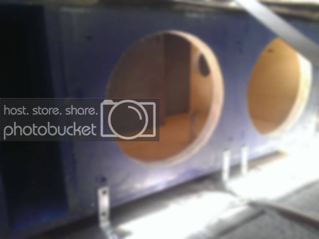

Box in.... got 2x2'x beaten in underneath it to level it... willl do some L brackets this weekend.... it is solid a fawk as it sits thogh.
From the back

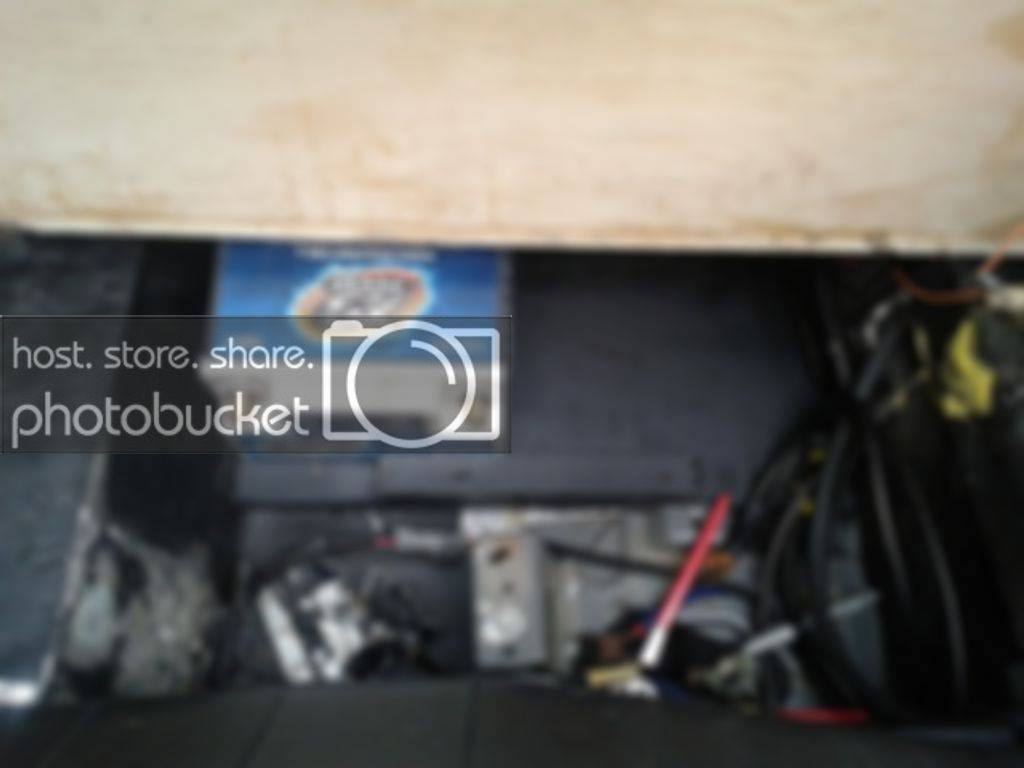

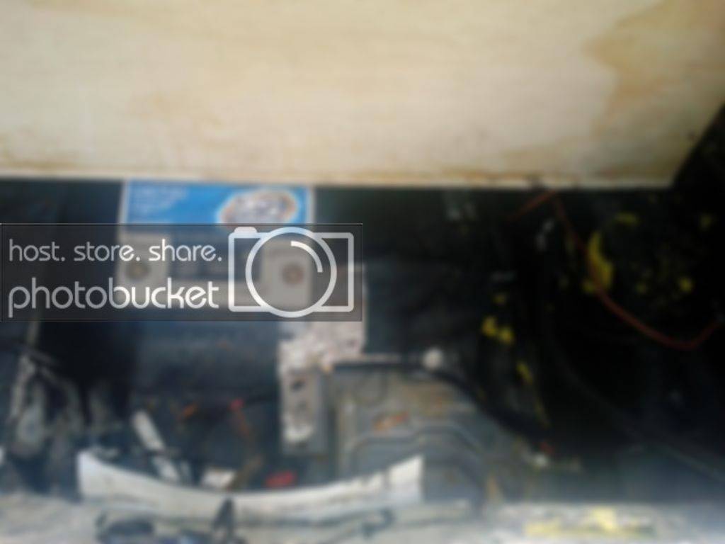

What I started with for the batteries.. I went the D4700 route as I installed one about a month ago in the stock location..... now I have two //content.invisioncic.com/y282845/emoticons/smile.gif.1ebc41e1811405b213edfc4622c41e27.gif
built this pannel to hold the battereies. I added another 2x2 on each side for lateral movement.... the amp rack wil stop vertical movement. not that Illl be jumping any hills soon.
Ill get some more work done this saturday as the wifey works all day and I dont.

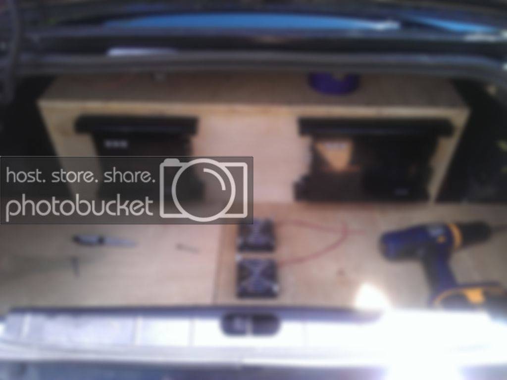

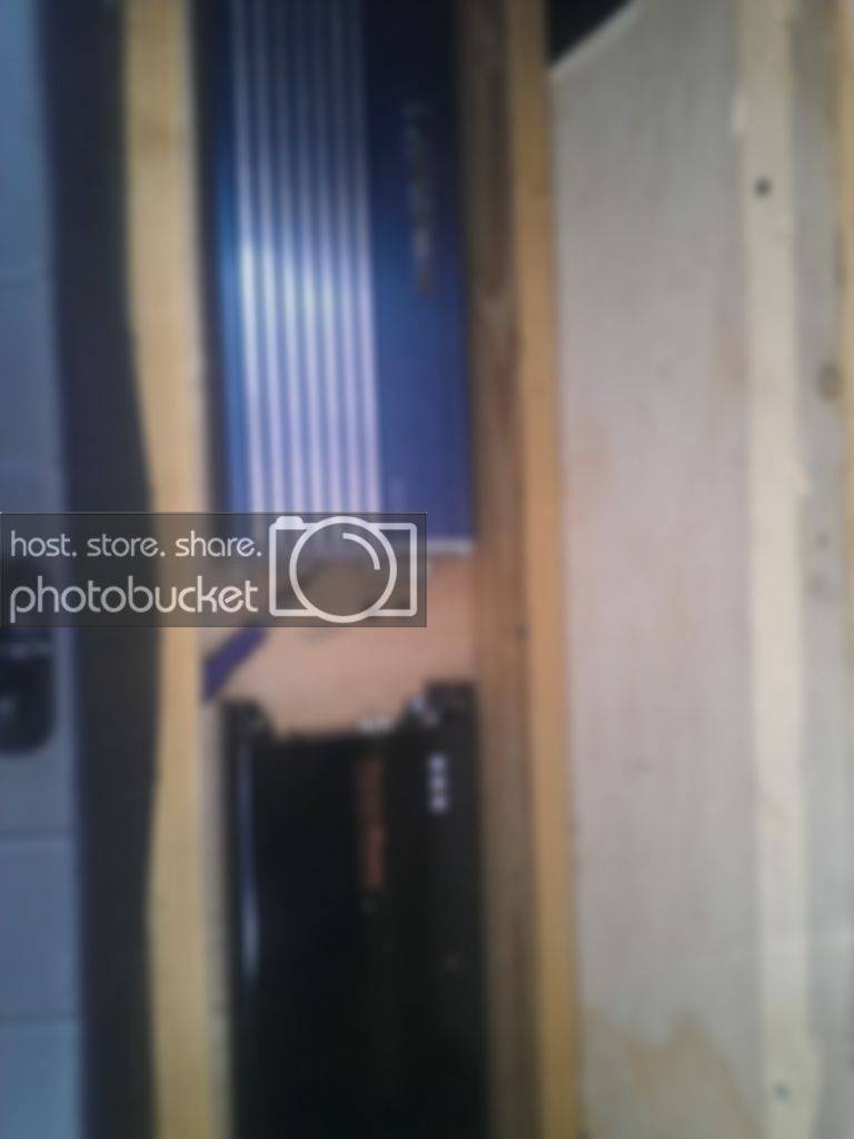

Got the amp layout decided. big amps across the floor under plexi... mids/highs amps on the back of the box flush... I plan to use some foam and rubber washers to limit vibrations.
MAde some cover panels for the amps. made out of 1/8" ply... two layers. one base and one to flush the plexiglass.

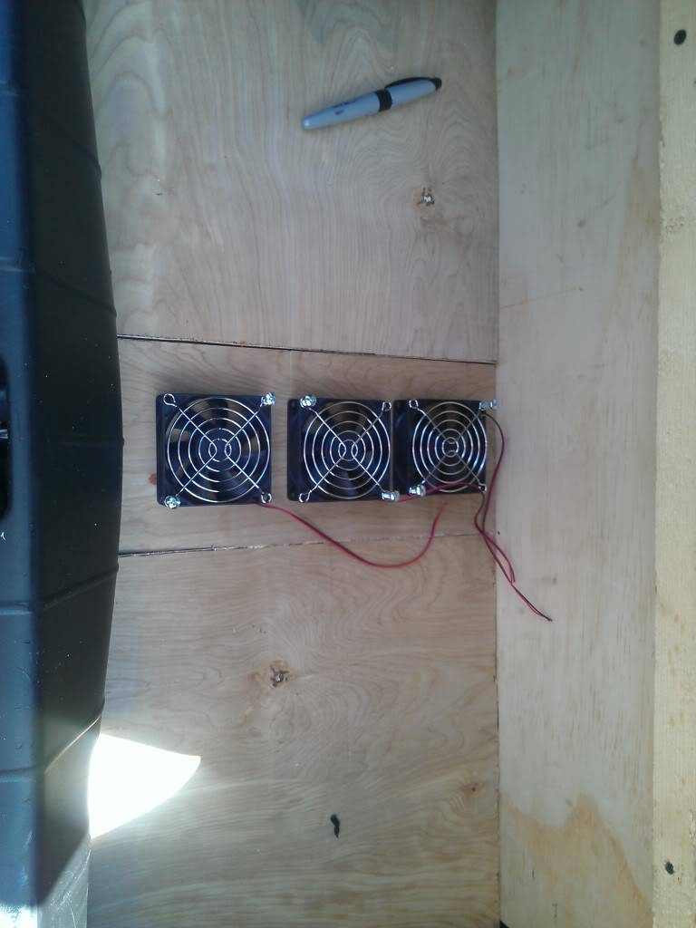

Also got some questions, if your following:
----should I go with two or three 80MM fans in the center of the amp rack or sapce them out two on the sides and one in the center? I would prefer to go with two fans in the center of the rack between the big amps.
