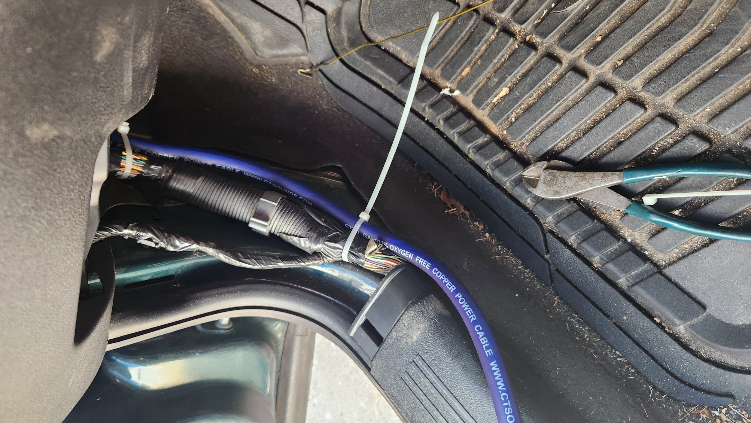

Do ya'll think I will pick up any noise being so close to these wires?
Not at all man. That supply wire is well insulated and you should be just fine. make sure you do a cleaned off surface to bare metal when you do a solid ground and you should be just fine man. You should be able to run your RCAs just under the carpet about 4-6" along the same path if you want to run down the same side. even the Remote wire. You can zip tie that to the RCAs and you shouldnt have any issues as well. keep on trucking man. Looks good! Take your time.Never rush things. Wiring is always time consuming. you will get there

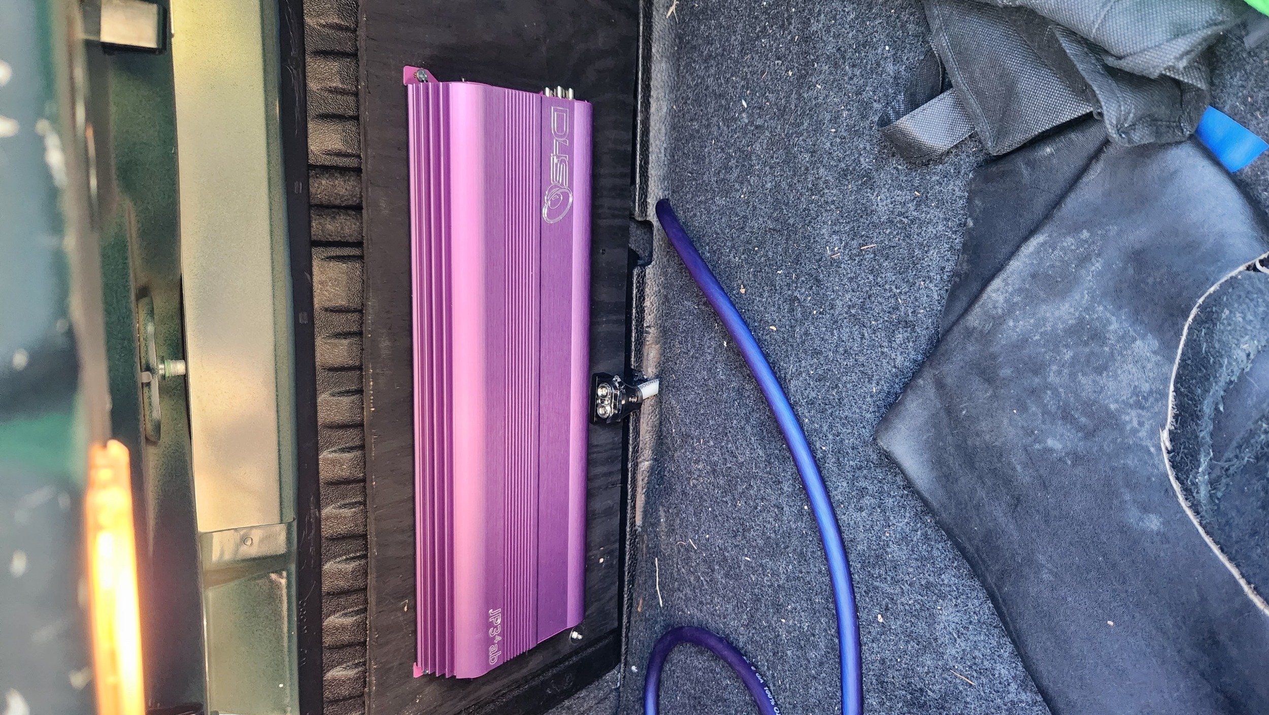

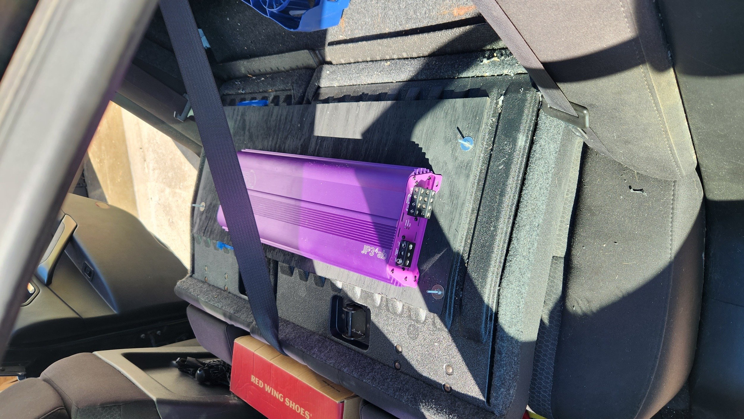

I would recommend placing 4-5 washers under each bolt hole on that amplifier to get it off the surface to get some air circulation, or if you still have enough of that wood you used to make a couple of like 2" strips to raise the amp up off the surface will deff. help get some air circulation under that amplifier and dissipate heat. Xscorpian also makes a couple of scroll fans(6" and 8" ) that I like to use to blow under to move some air. Easy to wire up. Poss to the Remote line on the amplifier and negative to negative. fan will turn on when amp turns on and turn off when you turn system off. Ive never had any electrical noise issues wiring to a sub amplifier. They are about $25 bucks, may find a decent deal by searching on them. You will and can hear the fan while at idle/no music usually inside the cabin space, but quite unnoticeable in trunk space and when most music is playing
Thats one big azz 4ch amp man.. 👀 👀 😚😚 Love it man!! Nice!!( I still have some Old School Monsters that size left,and still sound very nice). Sometimes you just need to sacrifice the space for what you want and need and what you are willing to give up man. Being realistic and practical deff. saves a headache and a lot of Slurring man. LOL. Ill give up just about any space to put what I want in any of my rides. Looks like almost the same size as my Elemental designs Nine-5.
