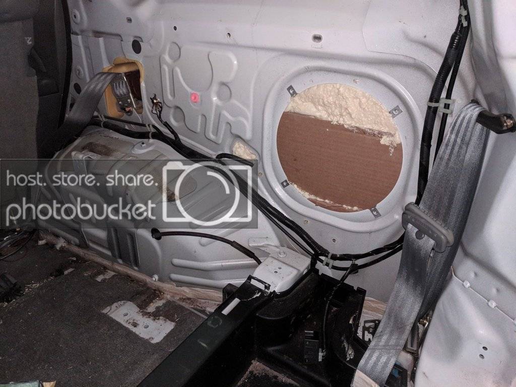

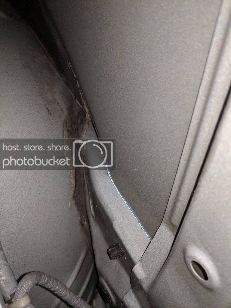

Problem 2....There's a 12 inch rip in the right rear quarter panel. I've got one more show this coming Sunday, and I'll be tearing the car apart to fix that after this show. Pics of that coming later.
The rip cost me 1db. Tape and a couple guys holding the panel got most of it back.
Removed the interior and here's a view of the rip from the inside
Welded it up and foamed the whole 1/4...

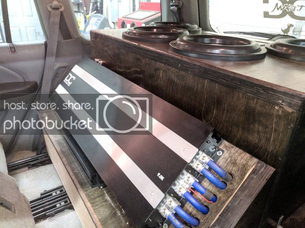

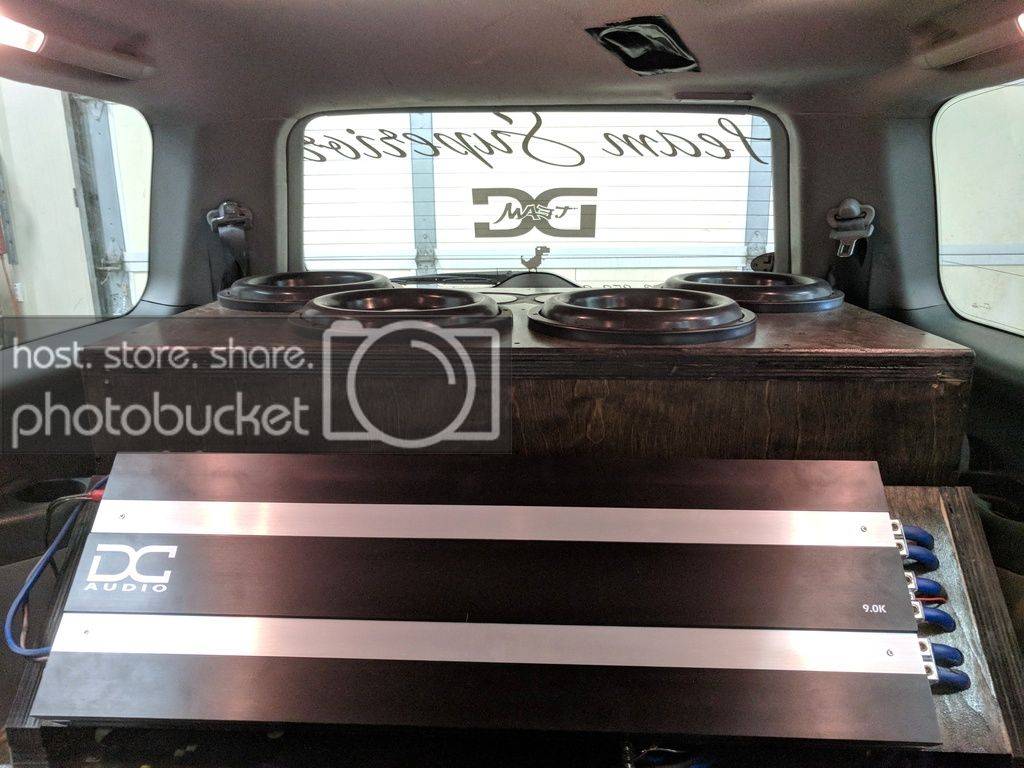

Put everything back together, and replaced the Sundown amp with a DC 9.0K. Clamping 800 watts more (same rise as I had previously), my score went down to a 53.9. Likely due to everything that changed with the 1/4 panel.
53.9 isn't going to win shows, so back to the drawing board I went.

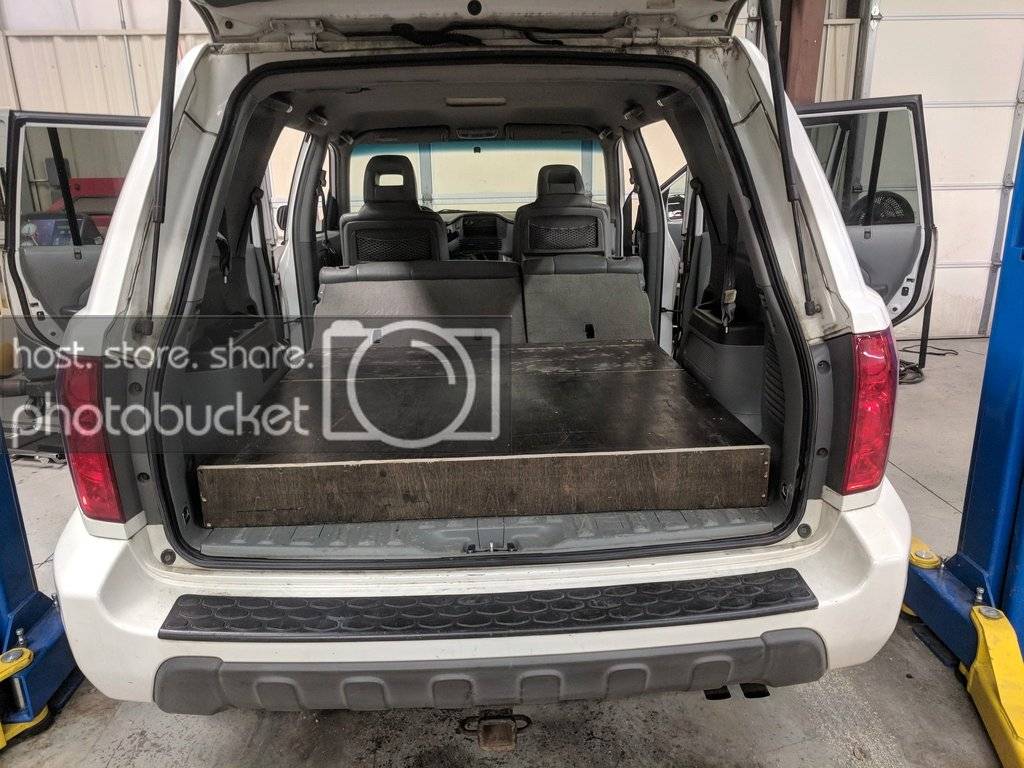

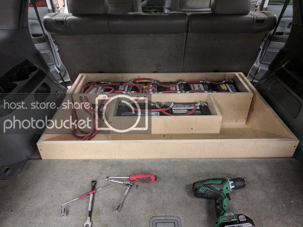

Pulled everything back out and decided to do what I should have done to begin with. Pulled the third row seats out and mounted my batteries there.
Also remade the amp rack so I'd get a little more room to slide the box further forward.
All the work was well worth it and got me this...

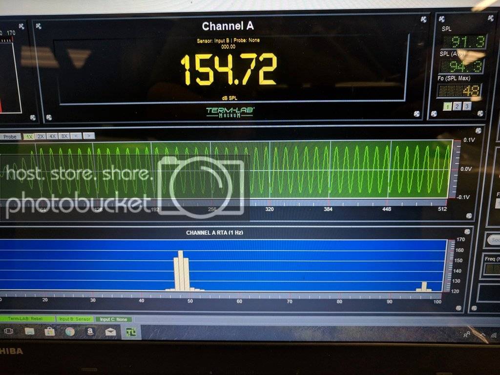

Good score money. Only thing I can suggest is phasing but you looking good.
Congrats. What numbers did you get?
Sent from my SM-G950U using Tapatalk
154.8 in the kick (state record), 153.5 on a 30 second music average (state record), and 151.5 sealed on the glass.

157 in the kick by finals in September is the goal.
The current NSPL world record for that class is 156.1, so I've got to do better than that to stand a chance of winning finals.

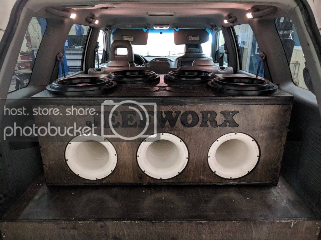

Ordered a JY lithium 80ah this morning. Picked up a couple XL motors that I was holding onto till I rebuild for no wall next season...but they're probably going in now. So I'll have 6 12's on the single 9k. All in the cargo area so I'll still have the back seat.

Also I think that the false floor with the batteries in being raised like that doesn't help. IF you possibly can when you re-wire your bank, see if you can test with the batteries outside and the box flat on the floor of the vehicle without that battery box under.

I agree on the false floor being raised. Originally the battery bank was in front of the box (and everything was flat on the floor) and I suspected the ports were being choked being so close to the hatch. Moving everything around and raising the floor gained, but I've always suspected if it was flat it would have gained more. Going with lithium and dumping the AGM's will allow me to do that.
I'm fairly certain I can get 6 12's in there in the proper air space with the proper clearance around the box with the lithium batt and moving amps to under the floor, while making the floor flat instead of raised.
