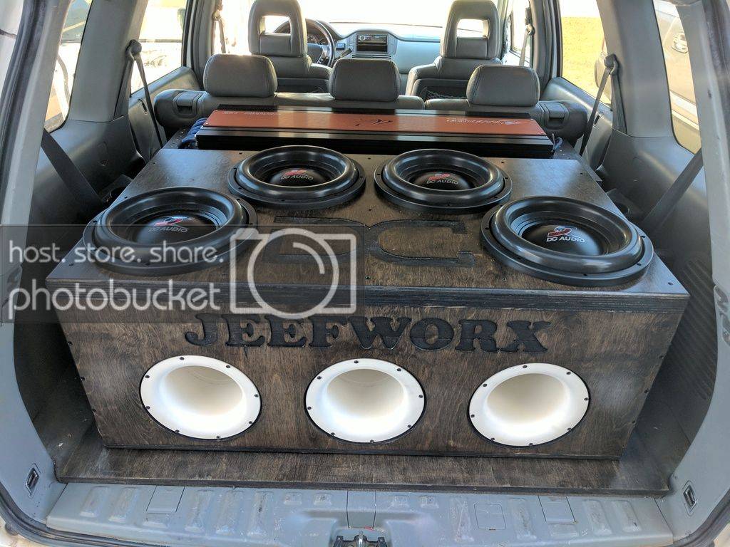

Went ahead and threw all the subs in the box and just left the one f'd up coil disconnected so I could at least hear the setup on low power. Did some testing at 1 - 1.5k watts with the termlab.
Peaks at 31hz with all the ports open (tuned at 38hz) and peaks at 28hz with one port plugged (tuned at 32hz).
At 26hz, on 1500 watts, it's trying to rip the front doors off. Haha.
I'm in love with how the looks of it turned out. Couldn't be happier.

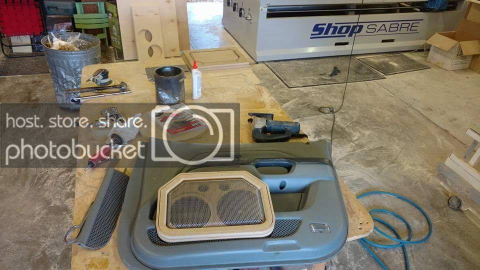

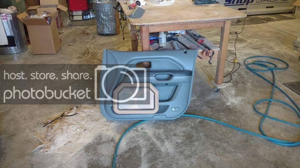

Couple pics of my door panels from the guy doing them. Still a lot of glass work to do to them. Hope to have them by the end of this week, but realistically expecting them sometime next week.

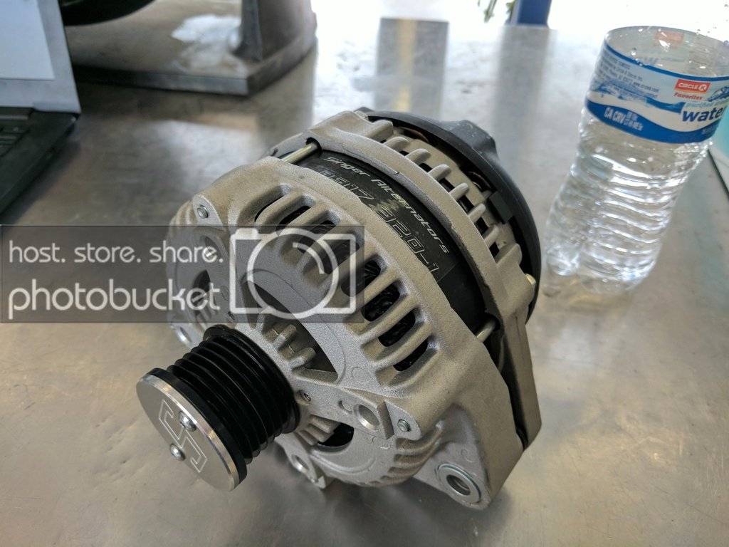

Alternator should finally be here Monday or Tuesday. Recones will hopefully be here by Friday.
Dying to get this thing finished up!
It's three 6 inch ports. As it is now, it's tuned to 38 hz with all 3 open, and 32 hz with 1 plugged.
This vehicle peaks loooow. With all 3 ports open, it's peaking at 31hz. With one plugged, it's peaking at 28 hz. That's testing at low power (1k watts), but I don't expect it to change drastically at full tilt.

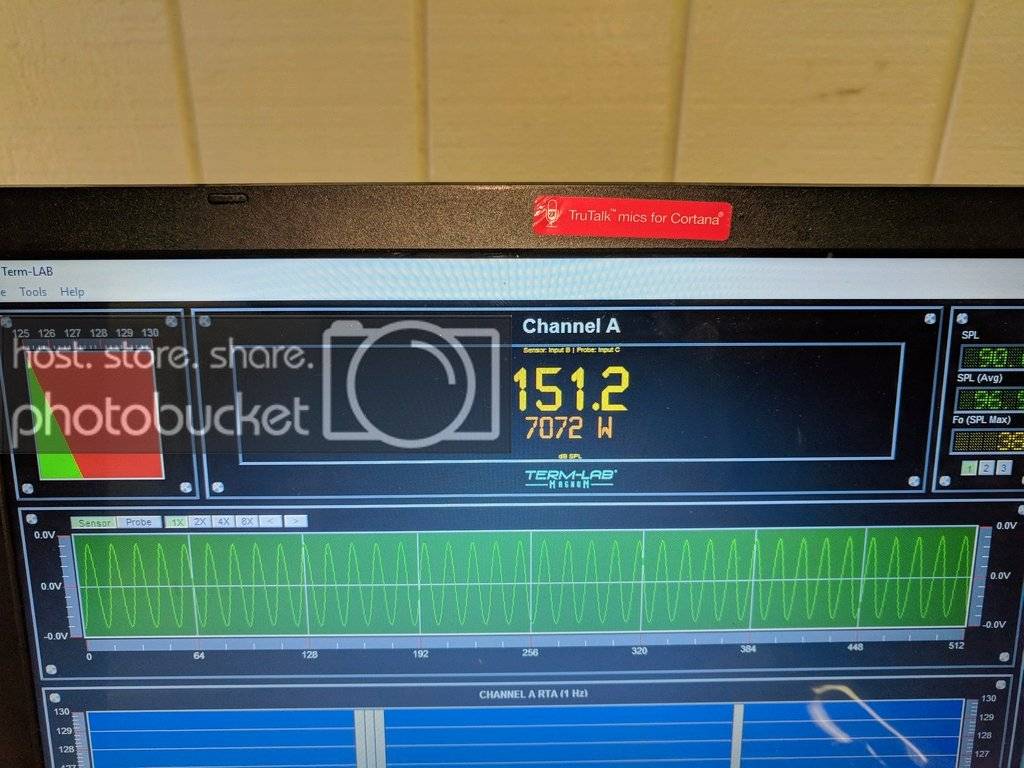

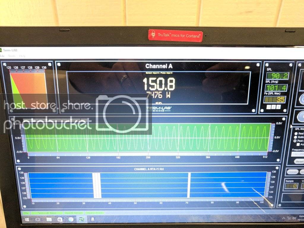

Metered it today. There still some power left, but that is irrelevent. This thing is such a freaking disappointment. I need to gain 5 db outlaw to be a winner at shows, and at least 3 to be even a little competitive.
My civic did numbers very close to this clamping 1/3 the power with half the cone area.
