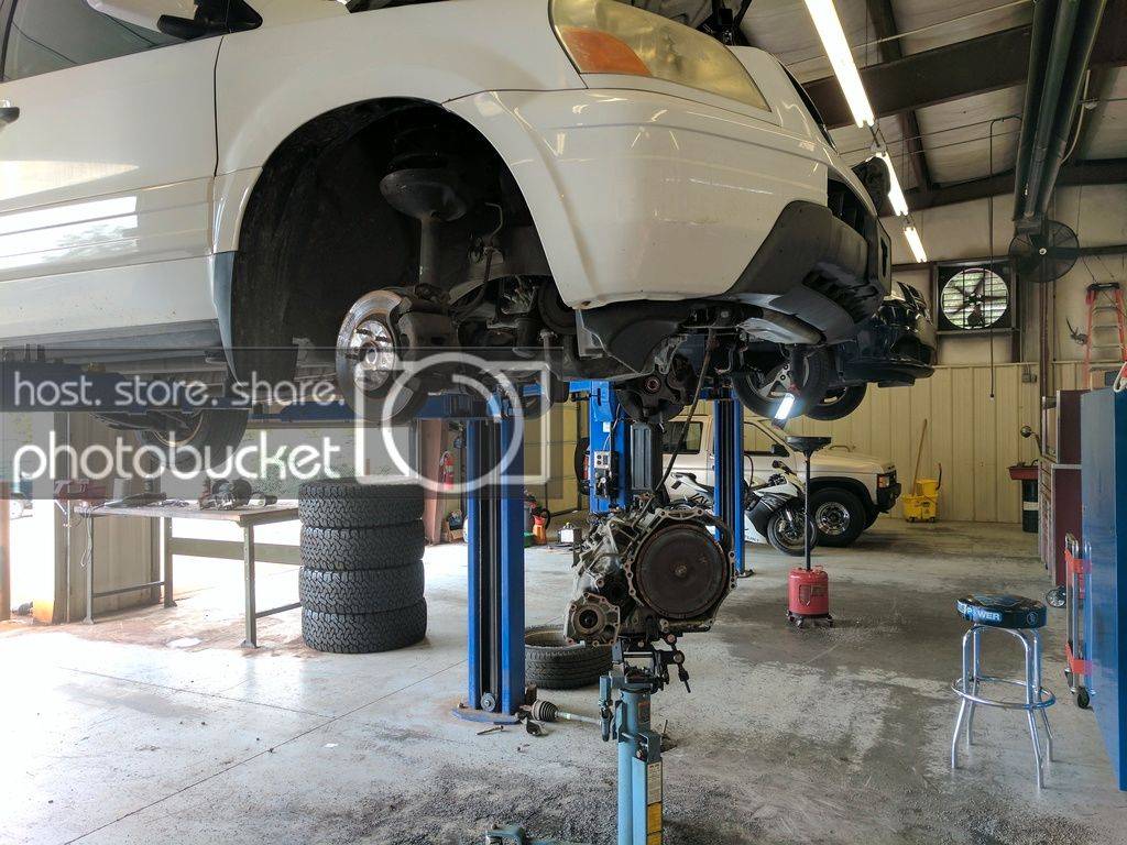

So this happened today. Got the new transmission in. Have to do 20 min worth of work to it tomorrow and test drive it, but it should be done.
After working in it, it's obvious this thing has been neglected. Will be replacing timing belt before I start driving this thing. Paint is pretty dead as well, so it'll get a good polish soon.

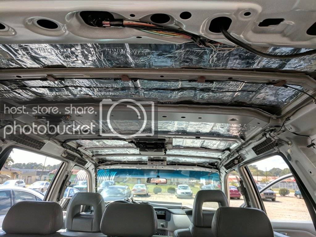

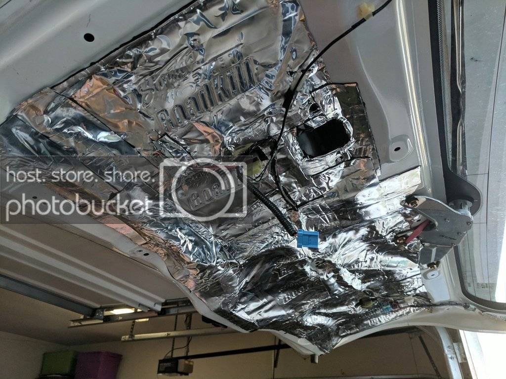

Deadened the roof and hatch. Doors next. Eventually will do the rear quarters and floor, but that's gonna wait for a little bit I think.
About 30 sq feet in the roof and hatch. Probably not enough, but again, it'll have to do for now.

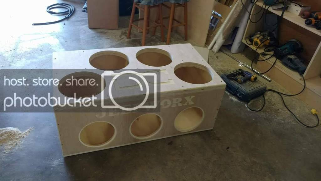

My box builder dropped my box off with me this morning. Going to stain it tomorrow, and hopefully get a lot of other stuff done to the Pilot as well.

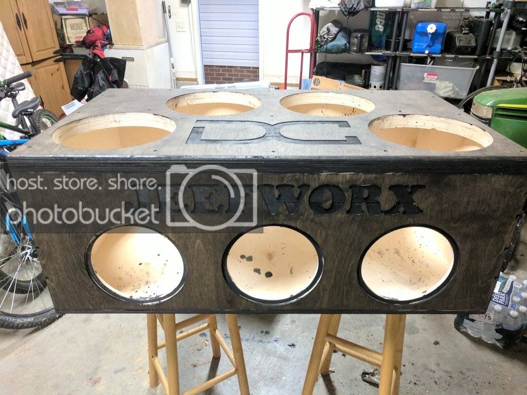

Stained. Gotta lay some clear on it tomorrow.
That looks pretty nice/great. Didn't realize there were many stains to choose from. Any ideas for a stain on my current enclosure? It's made from baltic birch....would really bring out the beauty of the wood. Thinking of using the same stain that SCStang uses on his, but dunno what particular stain he uses.
Thanks! I don't know much about finishes/stains, but I do know there's a ton of stains. I've seen some wood done even in a purple and blue stains, but I don't know if it was the stain itself that had the color or if they did something to the wood prior to staining.
The stain I'm using is "Ebony" color made by Minwax. Lowe's Hardware stocks it.
The wood this box is made of is Birch, but not real Baltic Birch.
