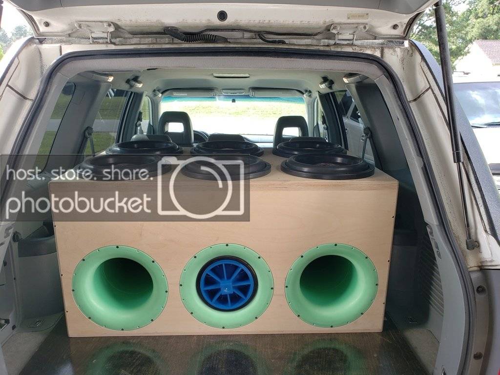

How far are the ports from the rear wall ? I didn’t read the whole thread ..is the rear hatch deadened ?
12 or so inches from the rear hatch. It stopped gaining at about 9 inches...I just never moved it back to 9. Wasn't any reason to.
Rear hatch is deadened.

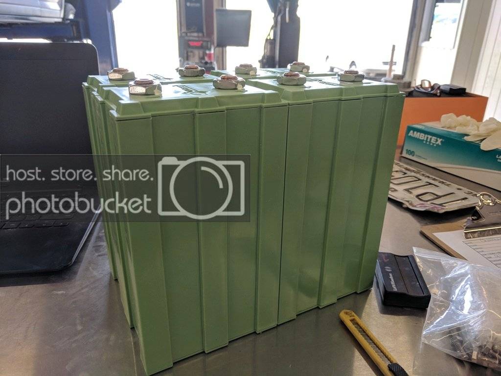

My JY80 arrived! Perfect timing. Will be pulling everything out this weekend to fix the ripped panels, pulling out 500 pounds of agm's and replacing with 30 pounds of lithium. Hopefully I'll gain a couple mpg with that. Dropping the raised floor down to the same level as the factory floor.
Hoping I'll be able to finally get a 155 with this.
Lithium is in and AGM is out. Dropped the floor down to factory height.

hows your voltage? any difference?

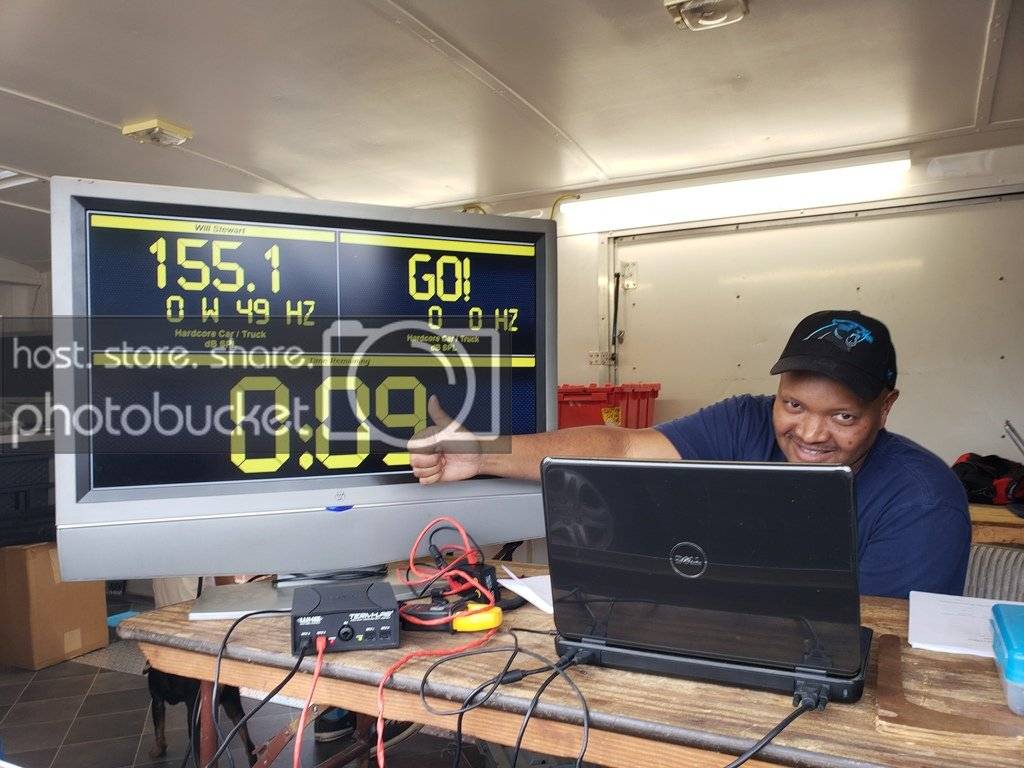

Did some testing on the meter after paint, and it did .07 better than it's ever done in testing before. Went to a show yesterday and was extremely surprised with this...
Tested the night before the show, and conditions in testing vs at the show we're nearly identical...but I somehow gained .3. The only thing different was elevation. I've been to that location before and my car has always done the same thing at higher elevation as sea level though, so I dunno.
Regardless, I'm ecstatic to finally get the 55 I've been chasing for months. Everytime I'd get close, I'd rip a panel or have some major issue. I'd fix the problem, and still be down from where I started.

Four removed, and six put in!
Gained 1db sealed and outlaw. Gained 1.3 on a 30 second music average. All this was in testing. I expect to gain .2 to .3 at a show, as the car does better once it heats up in the sun.
While it only gained 1db, it FEELS like it gained 3db. It is a night and day difference on how it demos.
