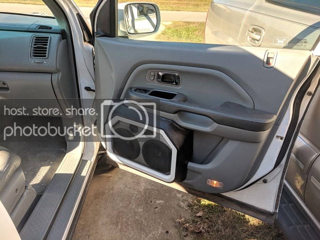

Finally got my door panels back, got the mids/highs hooked up, and got them half way eq'd. Still gotta work on that last part a little.

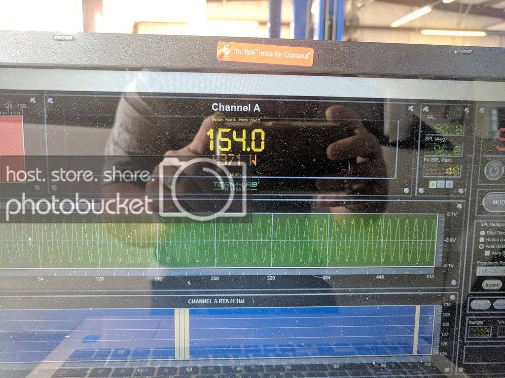

Got a loaner amp from a friend. A SCV-7500. Did a little testing and tuning today.
Lot more tuning to do. Confident I'll get a 55 with this amp. Goal is a 57 outlaw. Will primarily be running a outlaw class this season, so sealed score doesn't matter quite as much to me...but I'll do a little testing with that as well later.
Hah. I didn't elaborate on the "testing and tuning".
Moved the box forward. I suspect it was getting choked off a little initially.
Found a 2nd peak in the vehicle at a much higher frequency. Box rise is likely to be much higher, but cabin efficiency is much better.
Moved seats around.
So lots more rise and a lot more efficiency got me a lot better number.
Still should be a lot more to gain as well.
Haven't played with port length at all yet. With all 3 ports open (I close one off for daily), it's tuned at 37hz. I was burping at 48.
I only moved the box forward 1 inch and got a 1.3 gain with that by itself. Can still go forward another inch.
And should get a decent power increase when I get my amp back.
I'm fairly certain there's another easy 2db left in it. My goal for the season is 157, so I need to find 3dbs.
