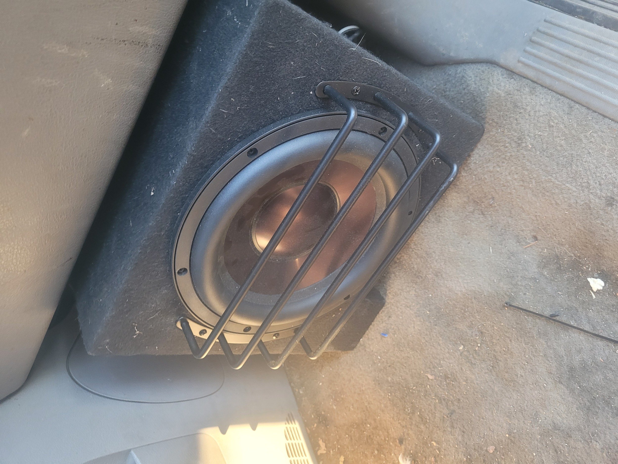

I really do appreciate volume, but after getting these dual 33v2's stuffed into a 3.44 cubic foot box, double baffle, the sound is SOOOO good, not thinking that I'll ever do ported again. it's not like you can't get nice ported setups, all 5 of my HT subs are bass reflex, but these Focals 13's are really nice.
Where is your front sub mounted?
In the footwell under my glove box on the passenger side
I still got some fiddling with the crossovers to do to get it dialed in more but it already makes a huge difference in the the lower midbass range
Does it need with your imaging at all being that your mids are crossed at 150? I would think low guitar notes or upper bass notes may get pulled to the right side?
It's pulls slightly to the passenger side right now (nothing severe or distracting) but it's lp at 300 from the installation. I should have time this weekend. Once I bandpass it from roughly 60-180hz that shouldn't be an issue though
