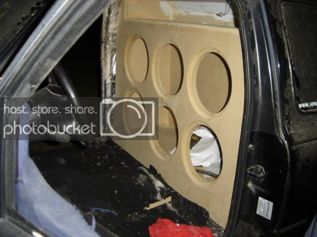

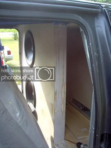

here's a pic of my old setup.. was doing 155's at 57hz for streetmax 1-2 last year with 4 IA 20.1's and a pc2150. those were standard Btl 15's also.
Here's What it looks like now
All I can say is WOW!!!! Is that a current picture of your truck or do you have your equipment in? I can't wait to see how much of a difference our new box makes, but man, it's going to be nothing compared to that.
i'm putting 6 soundstream T5 12's in there and going to be running 4 Sundown 1500's. each amp will be running at .7 a piece. i also have 7 optima g31 yellow tops in the bed. we are still currently working on the box still. i do have to modify my seats now though the back is too tall. i am putting new seats in that has a lower back to it. the box now is framed with 2x4's and has multiple layers of mdf on the floor and top. like a rock when you hit it.
