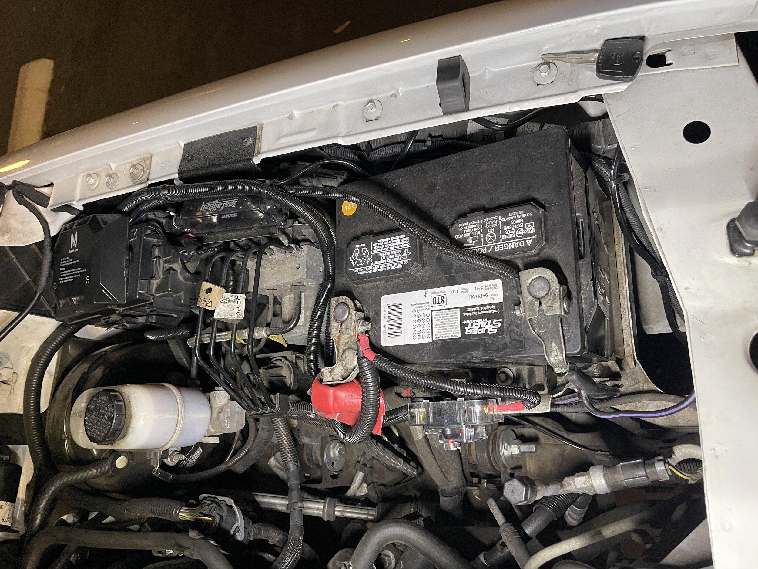

Figured probably a good ide to throw an AGM in this 2010 ranger?
Factory application is a group59 battery.
Looking for an economical option has been challenging.
I find something & posts are on the wrong side.
Seems like most are just a fuzz to long, length wise.
I could grind the front lip off the battery tray which will give me some more room but doesnt resolve the issue of figuring out finding something.
I did find the xspower that will most likely work, theres some notes stating bending the lip...
But at probably $450 after tax & shipping...
Not sure if it will even benefit me much to justify that cost..
a bxt59 is what it calls for roughly 10" long,
they make a bxt65 in mag but thats 12" long, excessive.
Any other options?

An AGM is essentially a sealed lead-acid battery, and performance is slightly better than regular lead-acid batteries of equal spec. (not cost)
I would argue that for under-the-hood use, you may even find a larger, standard lead-acid battery that is the same price as a smaller AGM, as they generally cost less (sometimes much less) than their AGM counterparts.
Shelling out $450.00 for the XS power seems like a high-dollar investment, low return.
Lithiums that are approved to use under the hood are a better option, but cost a bit of coin. Dakota Lithium, XS power, Limitless, and a host of others, I'm sure, all make a couple that are approved for use under the hood.
If you're going to plunk down $450 for an AGM under the hood that works slightly better than the stock LA battery, then think about shelling out $500- $700 for something like LTO that is vastly supporior to either LA or AGM replacements.
You're kind of right on the cusp of where you need a 2nd battery, and in a small vehicle, not a lot of options there.

Yeah, trying to keep cost reasonable as no idea if it will truly make a difference....
Some ranger battery trays will take a larger battery, this year wont...
I just tried a group 65, its ugly....
I get get it in the hole, but overlaps the tray....
& modifying wont hep any.
as far as I know a bxt65 is larger alternative to a bxt59 but longer 10" vs 12".....
