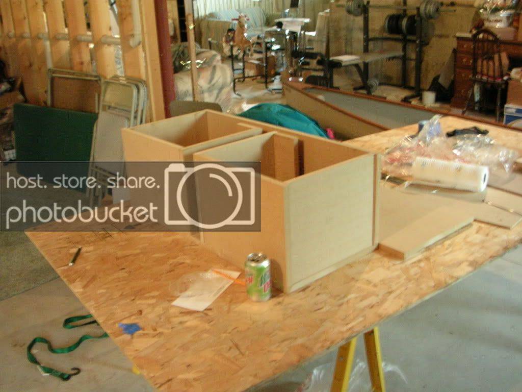

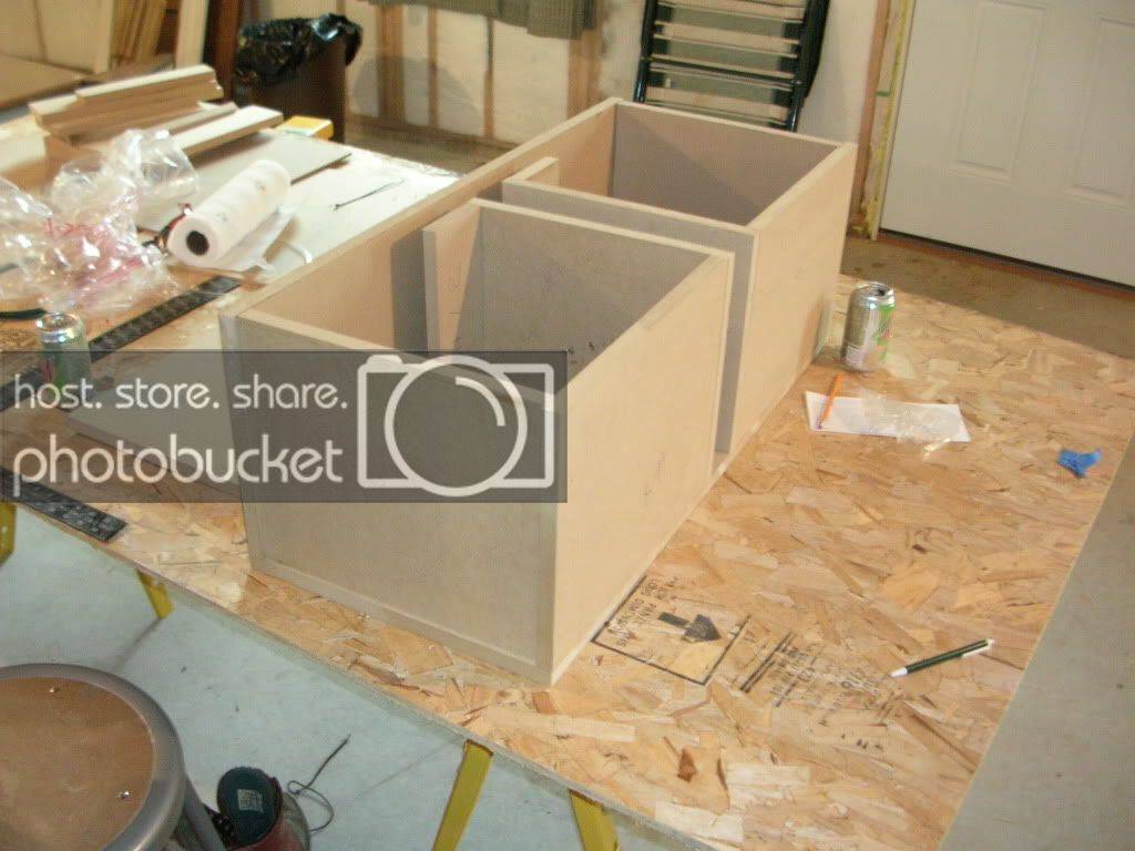

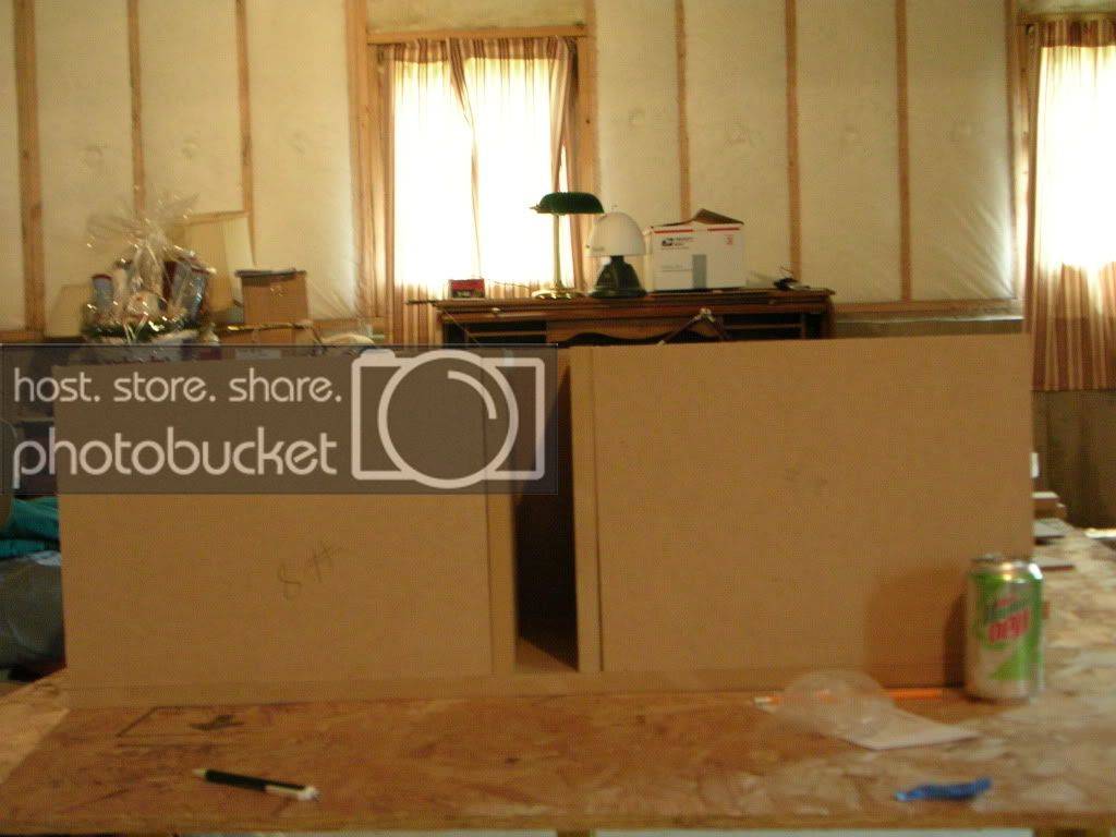

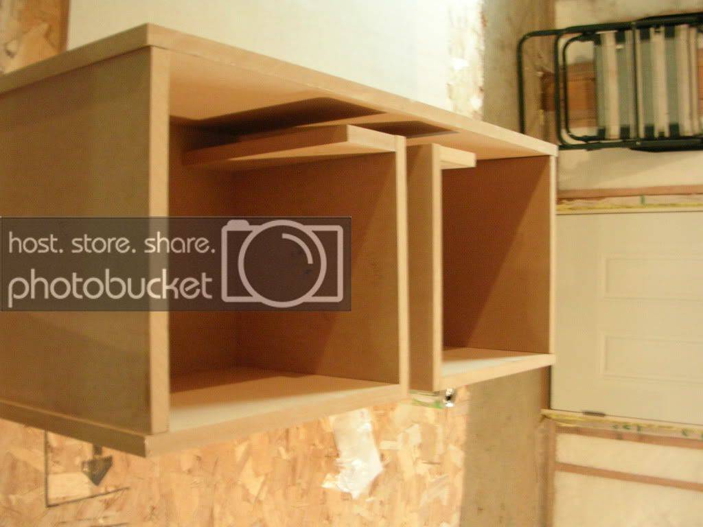

Well yesterday I got around to cutting my pieces for the box and today I wont get a chance to glue/screw it till later so I figured I would test assemble it w/o fasteners or glue
It will be around 1.15 Cubes for each sub the port is tuned to 32hz
I forget outside exactly but I think its 34.5x14x13(Ill update with exact later)
The Main port is 2.5" and obviously the secondary ports are 1.25"
Pictures
Also this is my first box

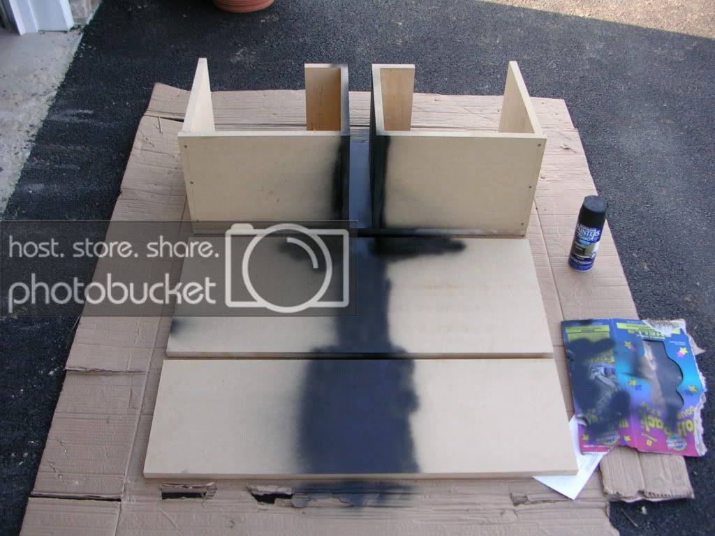

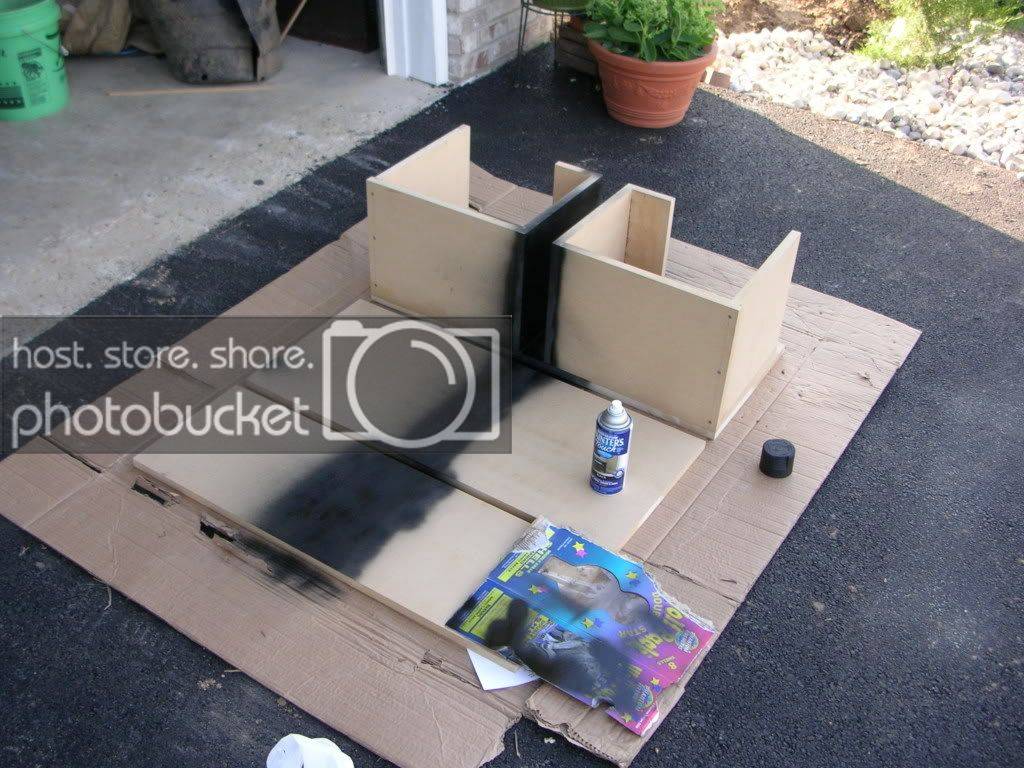

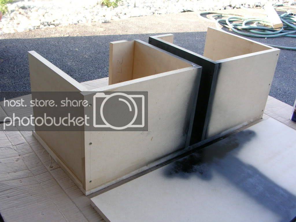

Any time I want to paint the winds pick up to atleast 30mph so.... Its sitting outside waiting for tonight to come (and the winds to die off) so I can paint the port.
More Pictures after the paint
New Pictures
Almost Done Painting

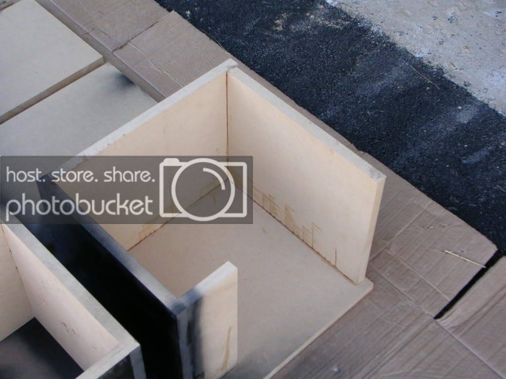

The Right side isnt attached yet so I could easily paint it but the Left side is screwed and glued
Inside the Box (titebond 3 works pretty good)
