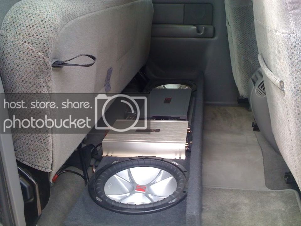

Sense your rear away isn't raised, I'd go w/the two 10s in a properly ported box. I have two 12s in a ported box and they're in as small as a ported box they can go in, but remember, my seat is raised 2". 2 cf is about right w/o raising your seat. I have 3 cf after the seat lift.

At a 2" lift, the back of the seat will just lock in. Using every bit of space I could I got 3 cf. I could actually get another .4 cf total with a slight redesign, but I didn't like the down firing set up. Cost in materials alone is about $85 here.
$33 for the wood, $5 glue, $6 box terminal, $30 carpet, $10 spray glue. Then there's the labor, I'd do it for $50 then the S&H ??.
At a 2" lift, the back of the seat will just lock in. Using every bit of space I could I got 3 cf. I could actually get another .4 cf total with a slight redesign, but I didn't like the down firing set up. Cost in materials alone is about $85 here.$33 for the wood, $5 glue, $6 box terminal, $30 carpet, $10 spray glue. Then there's the labor, I'd do it for $50 then the S&H ??.

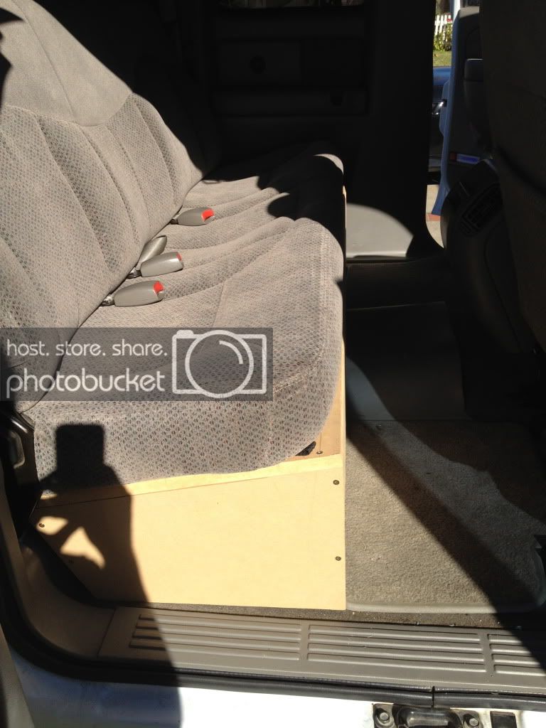

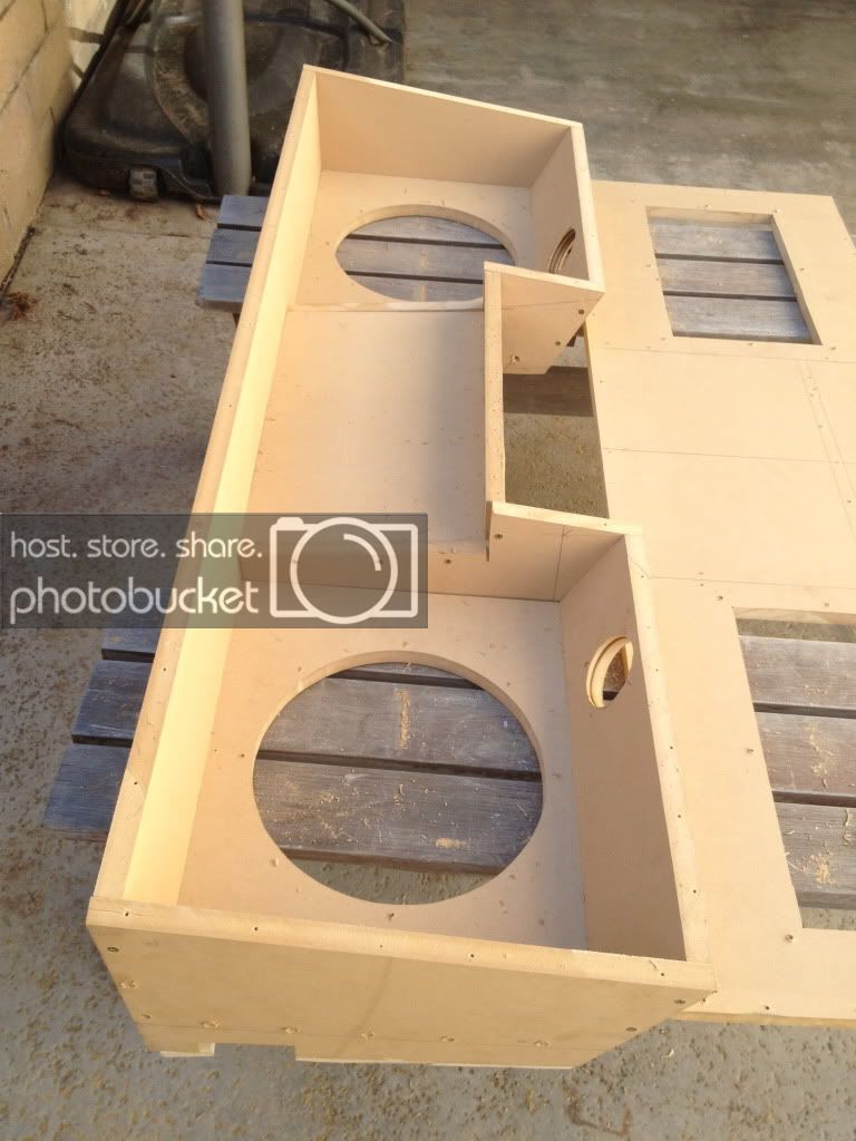

Yes, and I've never worked with fiberglass before. Another thing, I want a downfiring enclosure, because I'm pretty sure my car is going to get broken into again, and my theory is, if they can't steal it they will trash it. So if it is downfiring they cannot touch the subs, if it is forward firing they can ruin the subs, even if there are grills over them, which there would be, they still could ruin the subs. Down firing is what I decided on, how much space do I need to leave between the sub and the floor? Also what if I just paid you for blueprints of a box that way you wouldn't have to send anything but an email. Haha and I agree, not sure hom much that jack is going to help being that my truck is lifted, might need to invest in an aftermarket jack. But I don't think I'm going to be doing any glass work to get up in that area. So far what I have, It maximizes the space under the seat, but its just a rough design out of cardboard. A little scared to start with the wood, need to do some more research first. And with the 2" seat lift you didn't have to extend the locking tabs on the back of the seat?
Well I think I need to get started on the box soon since I leave for school in 13 days, so the plan is to have everything ready to go because I don't have the money for the subs yet, so I plan on ordering them in a week maybe two, I want to have everything done and ready to go when the time comes. So I think I might just build a sealed box for two twelves since I'm not really sure how to design a ported box for a truck like mine. Probably won't start building till Wednesday or so.

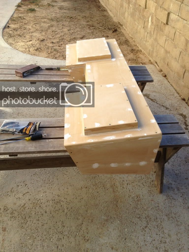

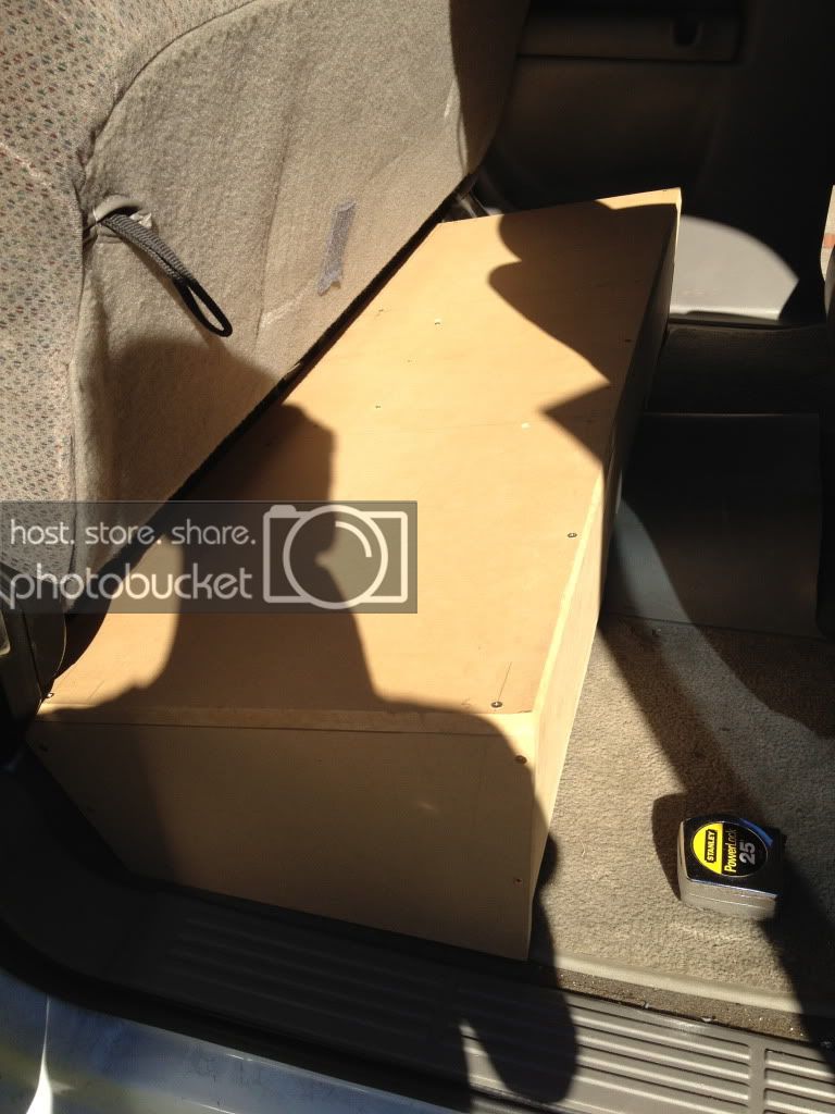

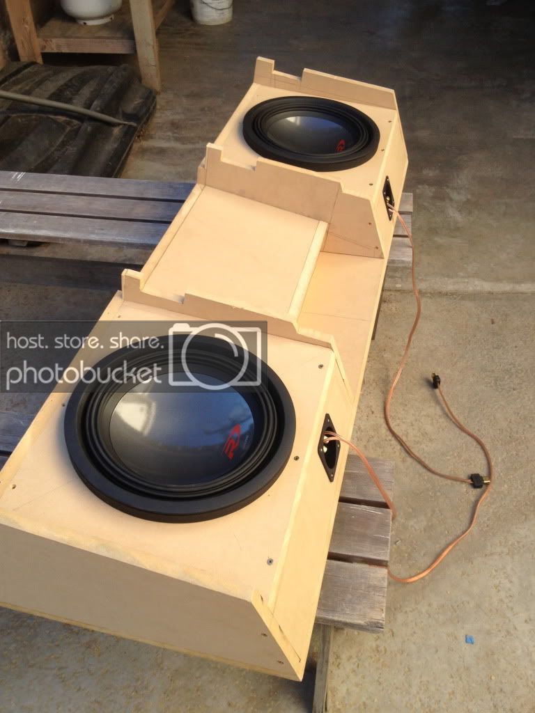

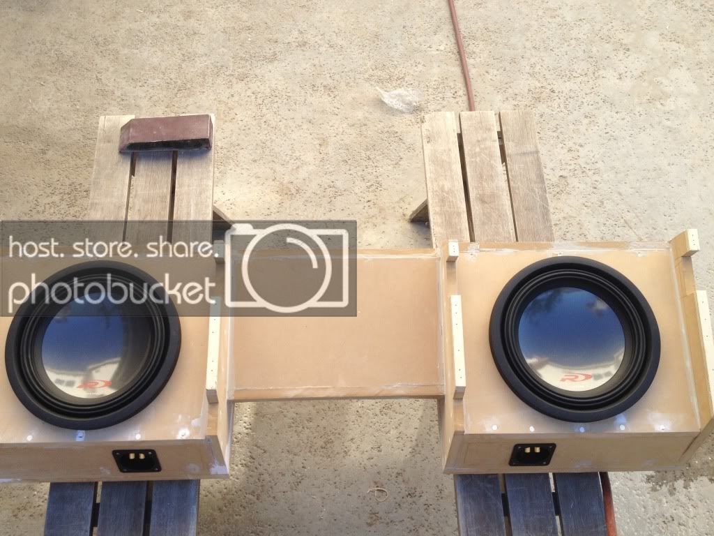

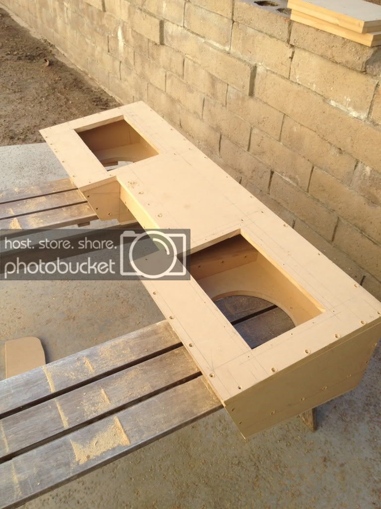

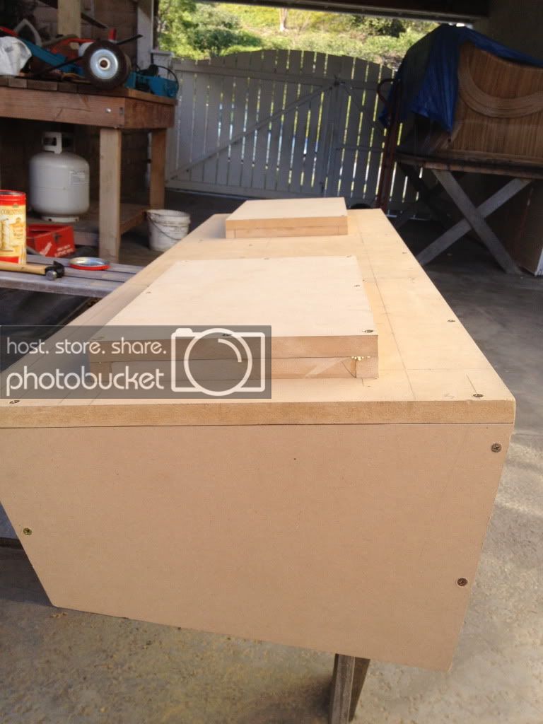

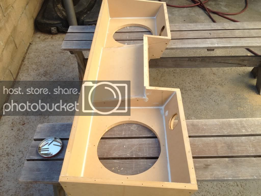

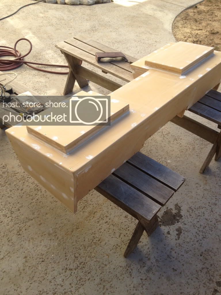

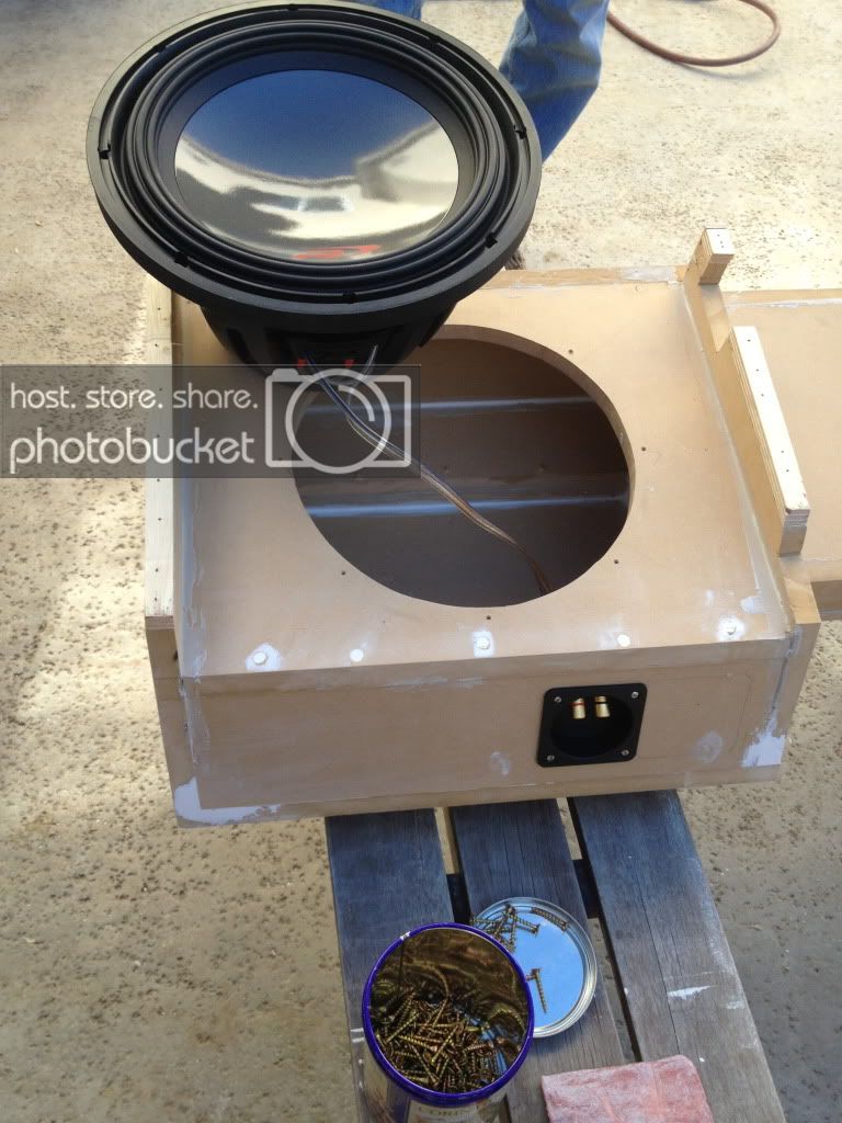

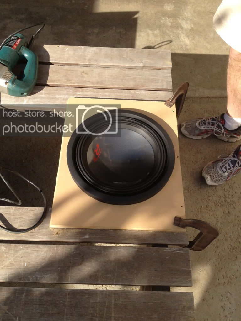

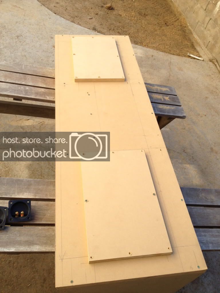

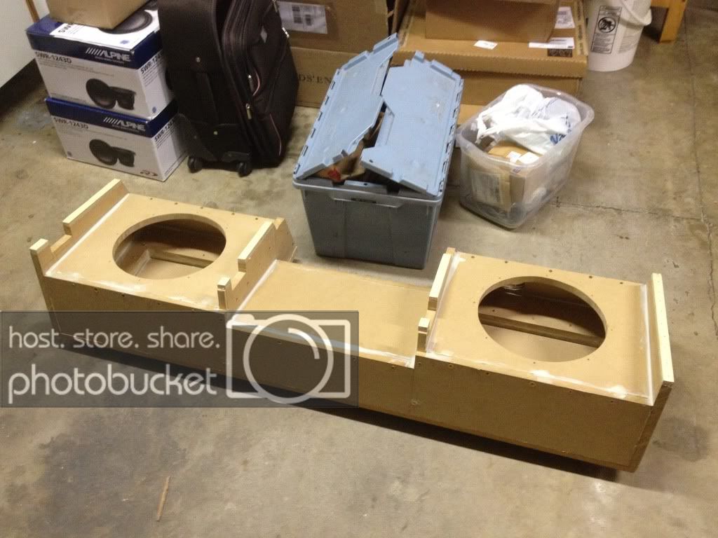

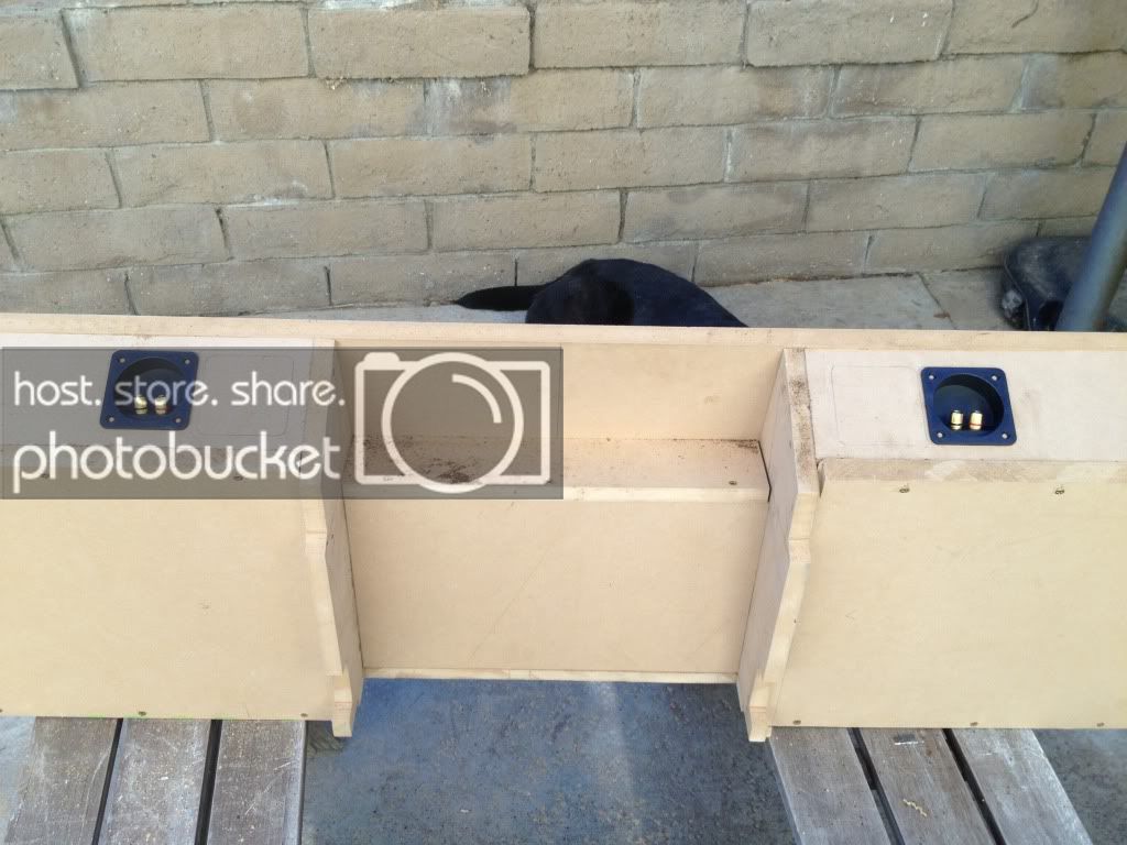

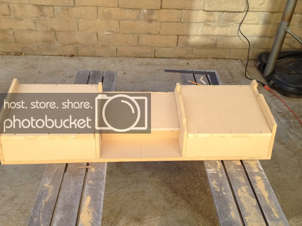

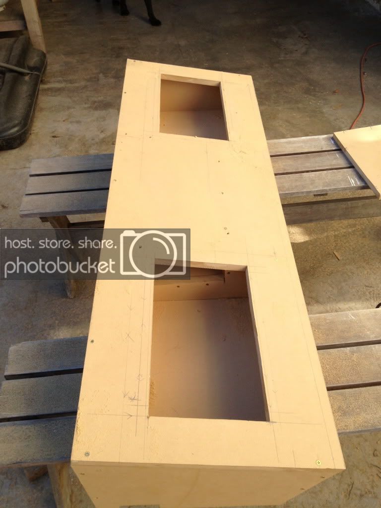

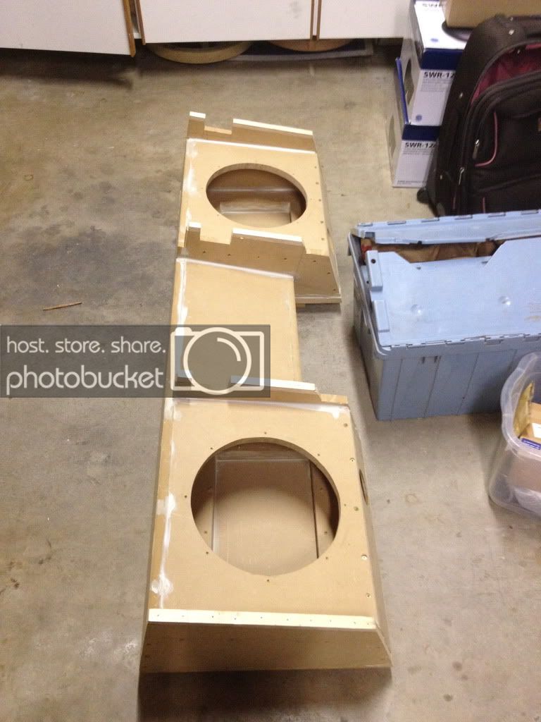

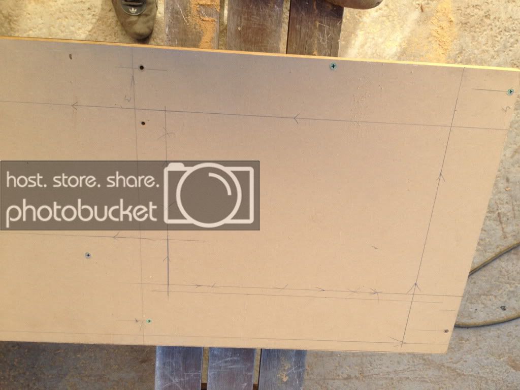

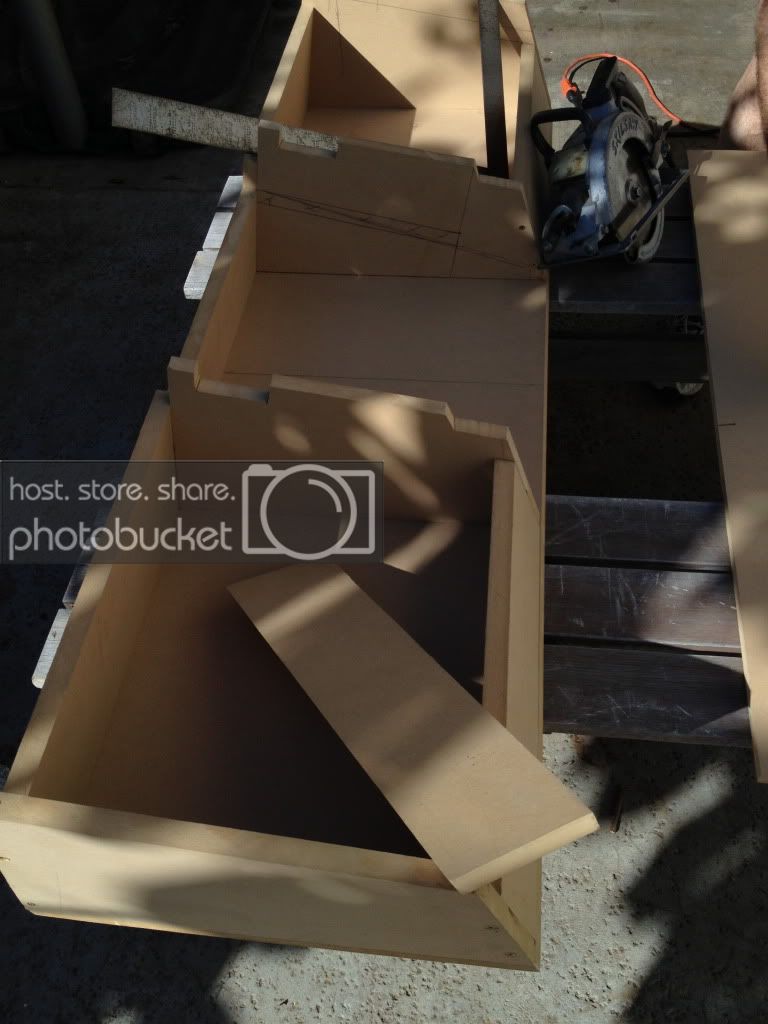

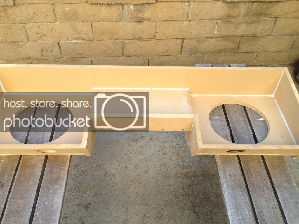

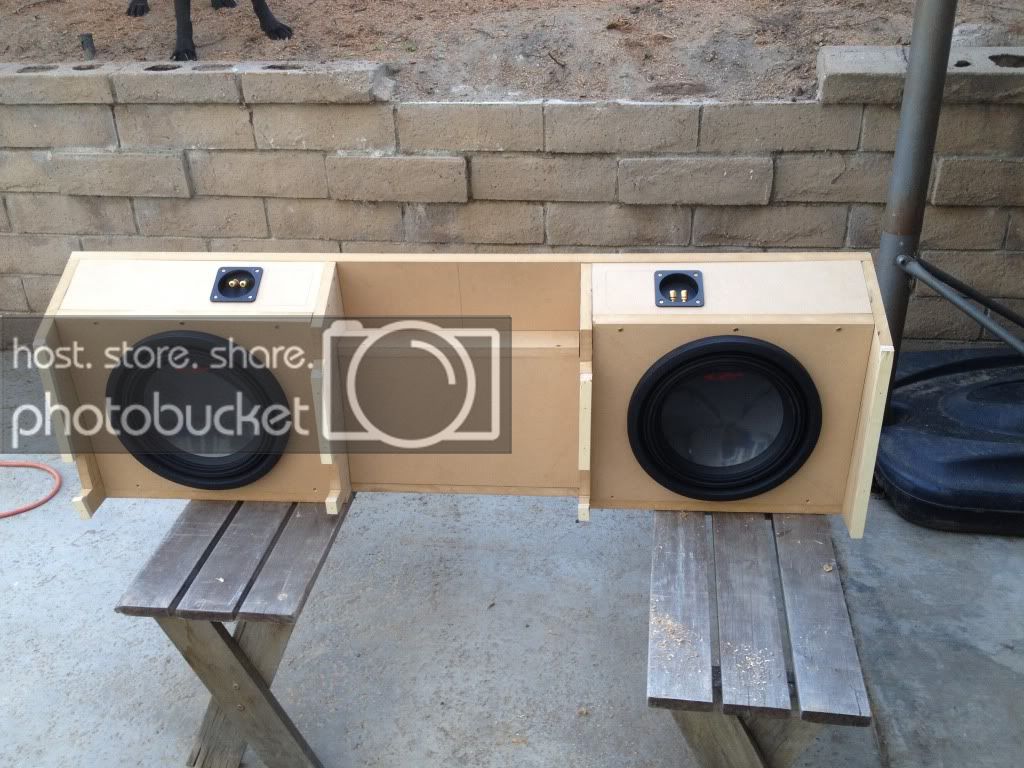

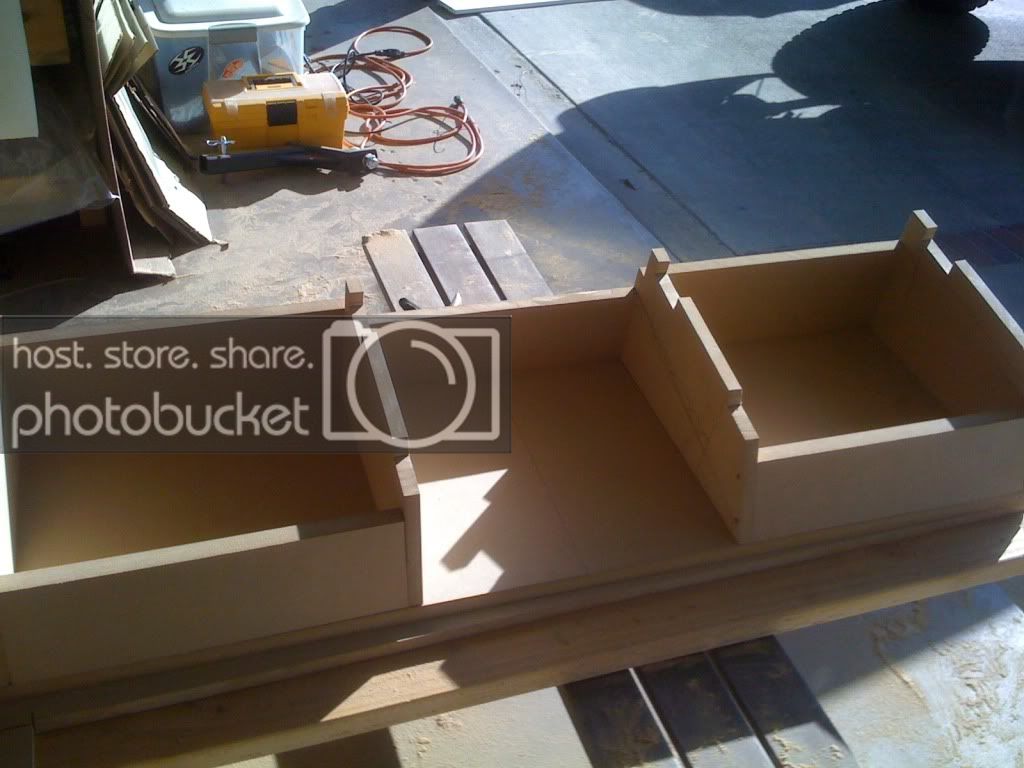

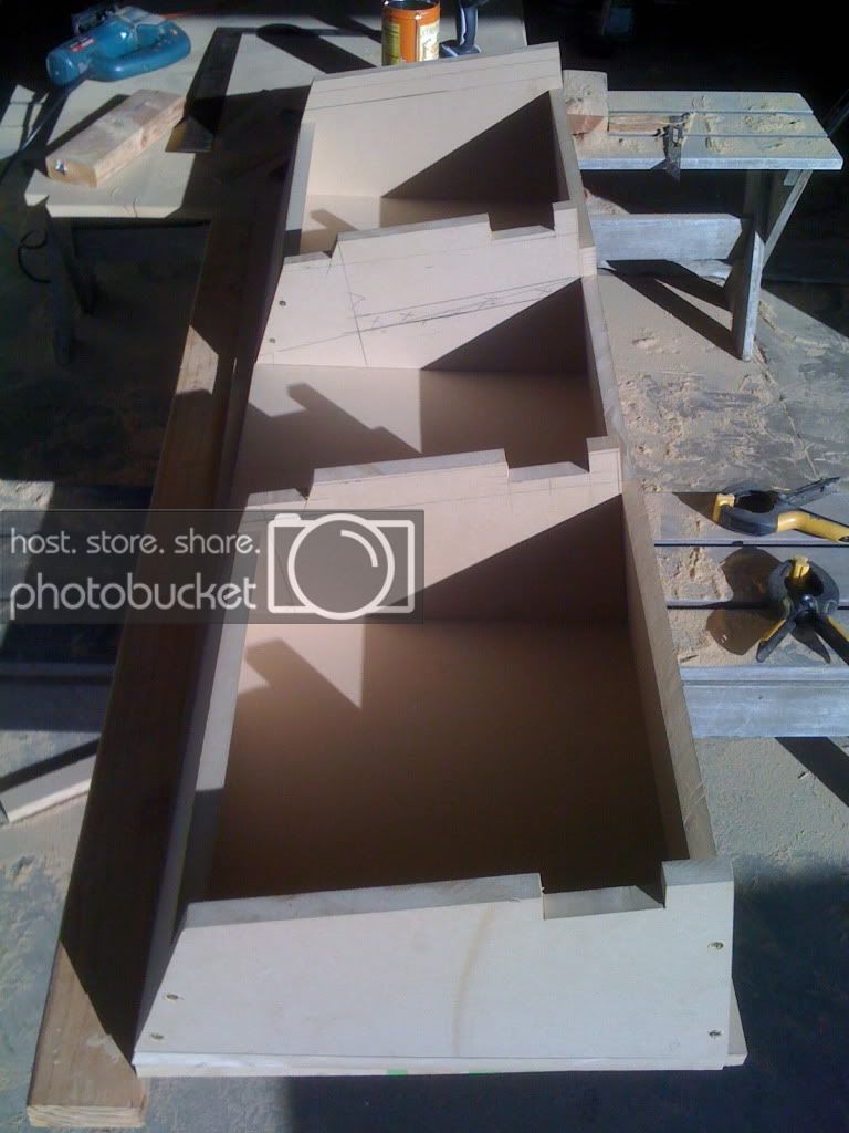

Got started on the box, made a good amount of progress. I think I have about 1.25cuft per chamber, which is good. I'm not sure if I'm going with 10's or 12's yet. If I do 10's I might port it.
