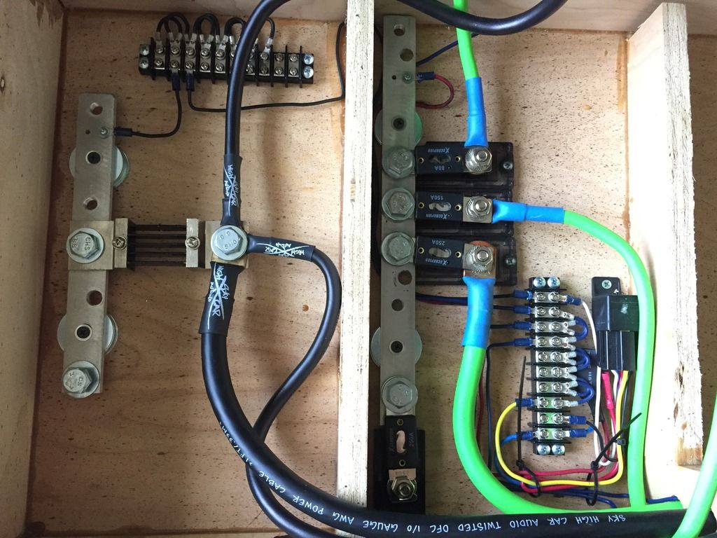

Well, woke up and removed two of the front-to-back runs in the truck and brought the two G31's back in this morning while it was still somewhat cool. I'm going to roll with only the underhood battery. If I need more I'll be getting a bank of caps.
Figured out what I'm doing for wiring too. Got done what I could while it's still inside:
That buss bar was one of two across the batteries before, just cut it and reused it. Those fuse holders I just cut the end off of and screwed 'em down in place. Terminal strips are awesome, as always. The wiring looks all neat right now, but once I get the other stuff in there that's still in the truck it won't be so pretty lol.
Waiting on delivery of the subs literally any minute now. Have to buy RCA extensions. Anyone think I'll lose a lot of fidelity with barrel connectors?
