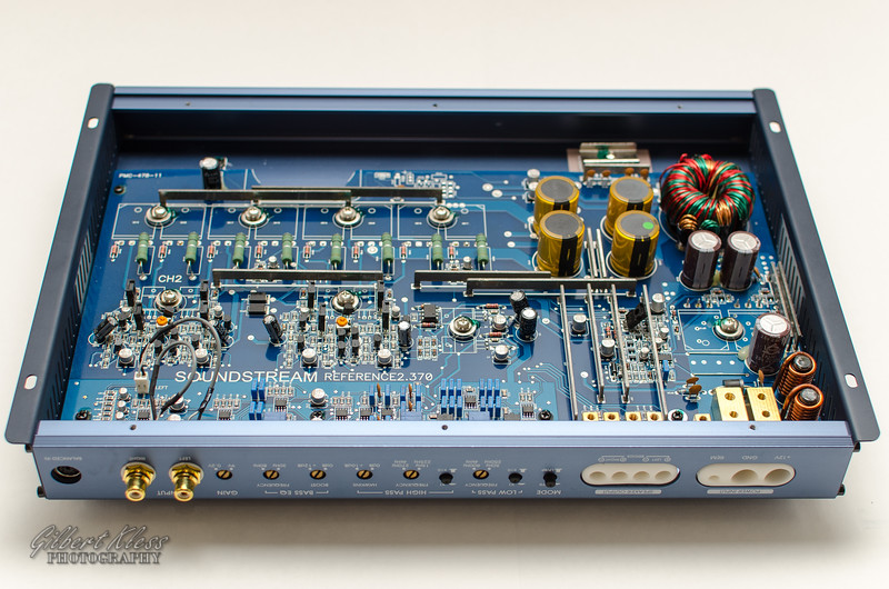

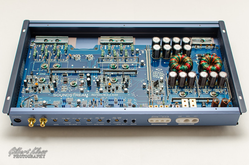

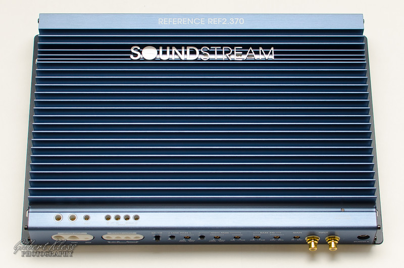

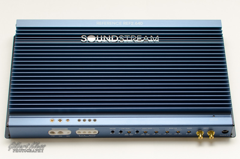

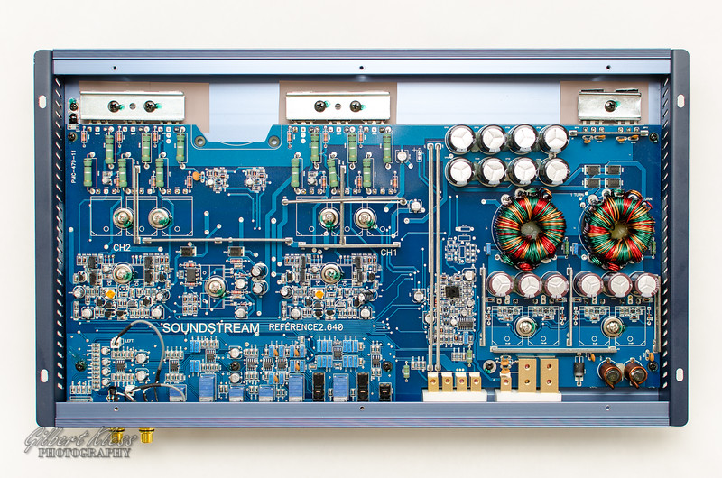

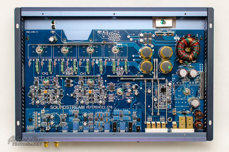

Bought a new Soundstream REF2.370 and REF2.640. Pics!

So, for amps, I will be running the SS REF2.370 for tweeters, the GZHA 4200XII bridged to each mid at 8 ohms, and the GZHA 2400XII at 2 ohms for subs. So, all class AB. I was all class D before, so I'll be able to see if there really is a difference. I don't think there is, for the record.

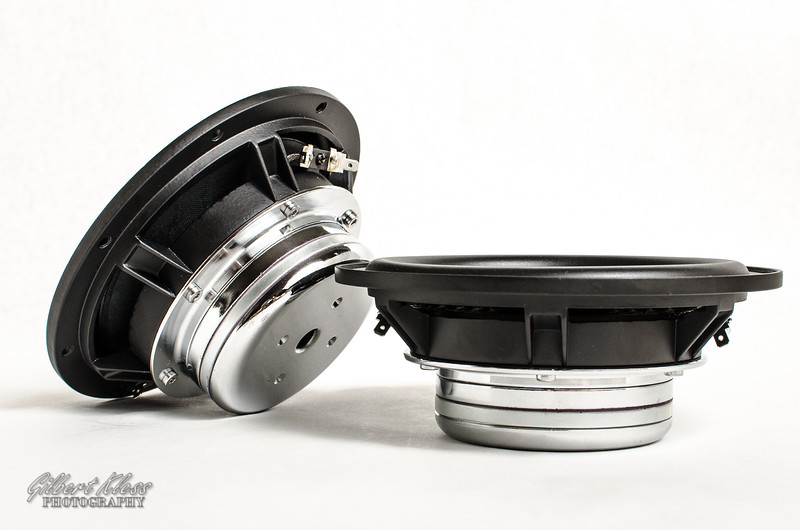

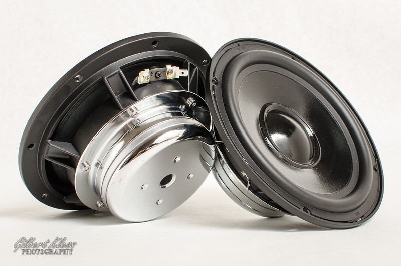

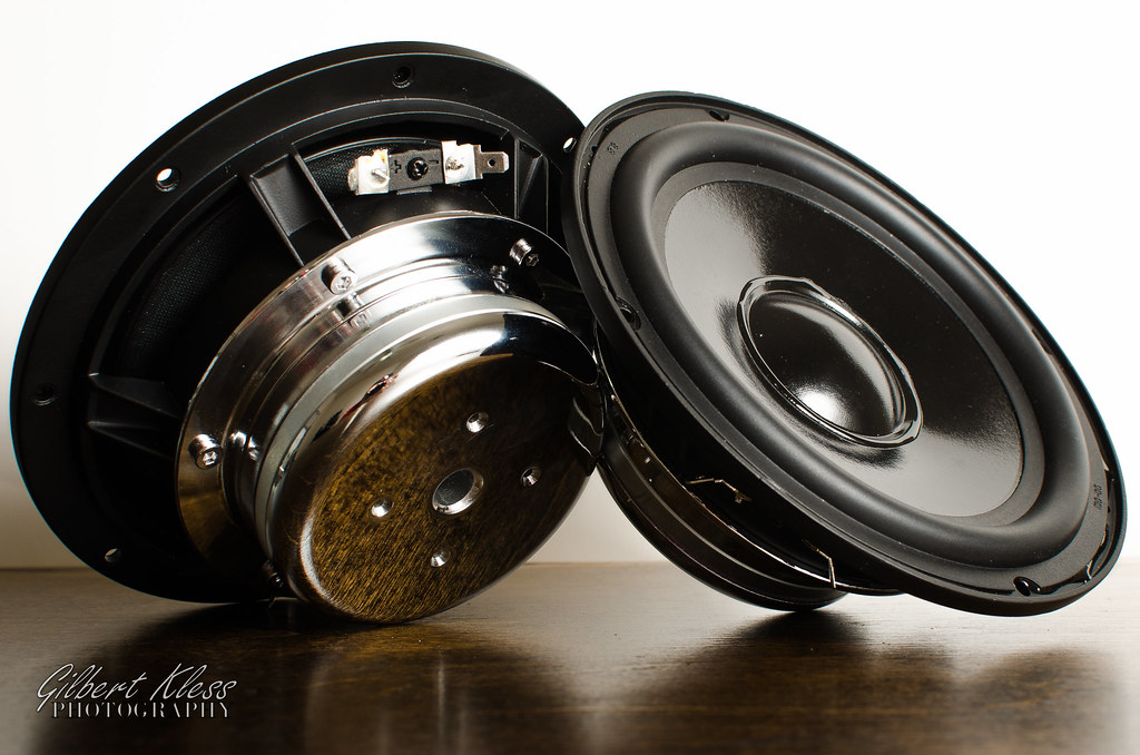

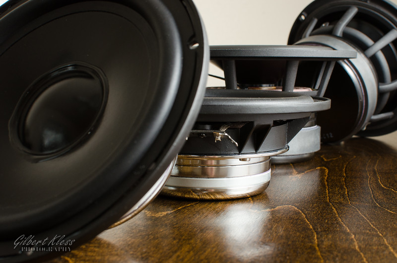

For mids, my Exodus Anarchy's came out today. They were replaced with Stereo Integrity TM65's. First, some photos:
Stereo Integrity TM65 by Gilbert Kless, on Flickr
I put mine in today, and my initial impression was one of slight disappointment. There was a hollow sound and I found myself reaching for EQ. Vocals sounded a bit odd. Quick RTA showed 500Hz was down, but I'm not totally sure at this point it's solely the drivers themselves. Might be the way they're playing with the truck. I also noticed that they don't seem as efficient as the Anarchy's I took out, seems like they both handle more and require more power to get loud. Seemed like the snap of a snare drum was more in your face though, I did like that.
Regardless, I only have about 45 minutes on them, so I will definitely give them some time. Both of the symptoms I've described will almost definitely subside after break in. I also only have them on like 30W or so, temp amp right now until my Ground Zero amps get here. I'm excited to see what they hold in store. I will be revisiting the Anarchy's in another month or two, and do a true side-by-side with both broken in well.
